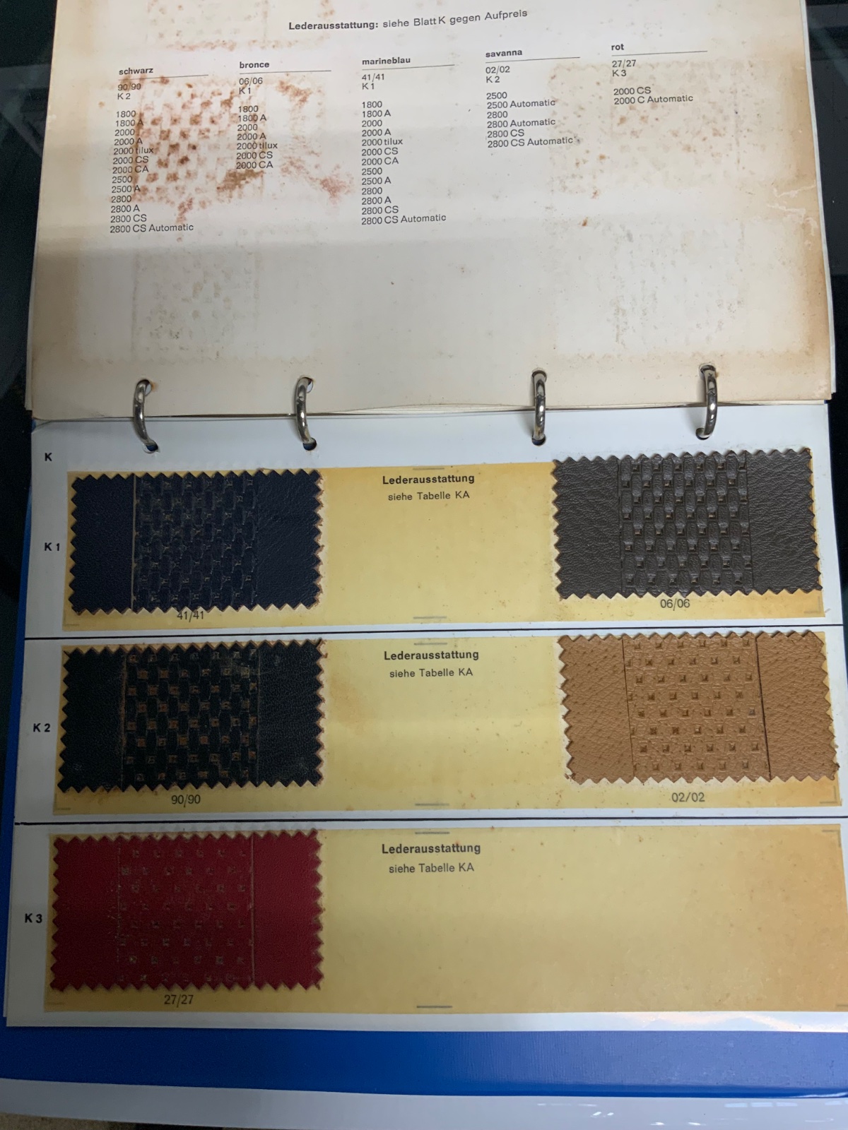

BMW called it Marineblau or in English just navy blue. Also for you trivia buffs, BMW leather is K1, 41/41 from the upholstery book. I had my seats sewn and bought A2840 Imperial Blue from Global in Anaheim, $7 a square foot, four hides. It matched my e12 door cards which are the same color as e9.
