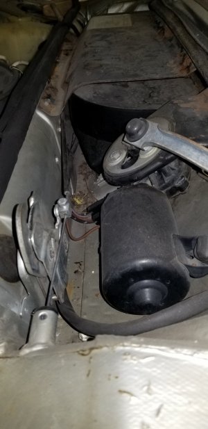

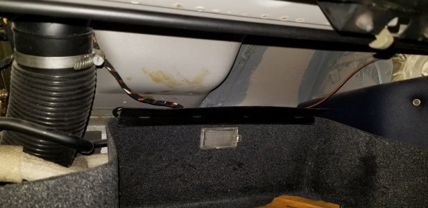

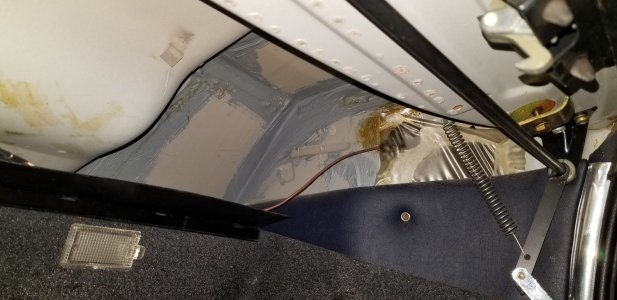

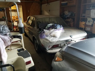

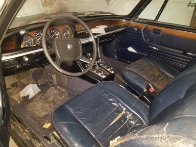

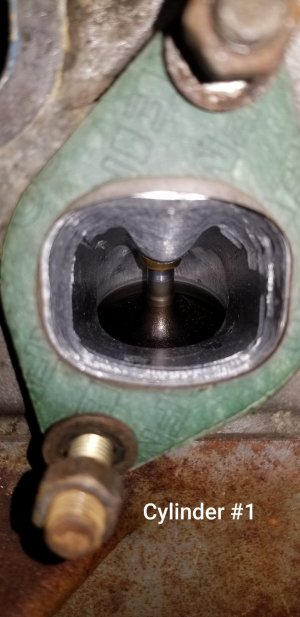

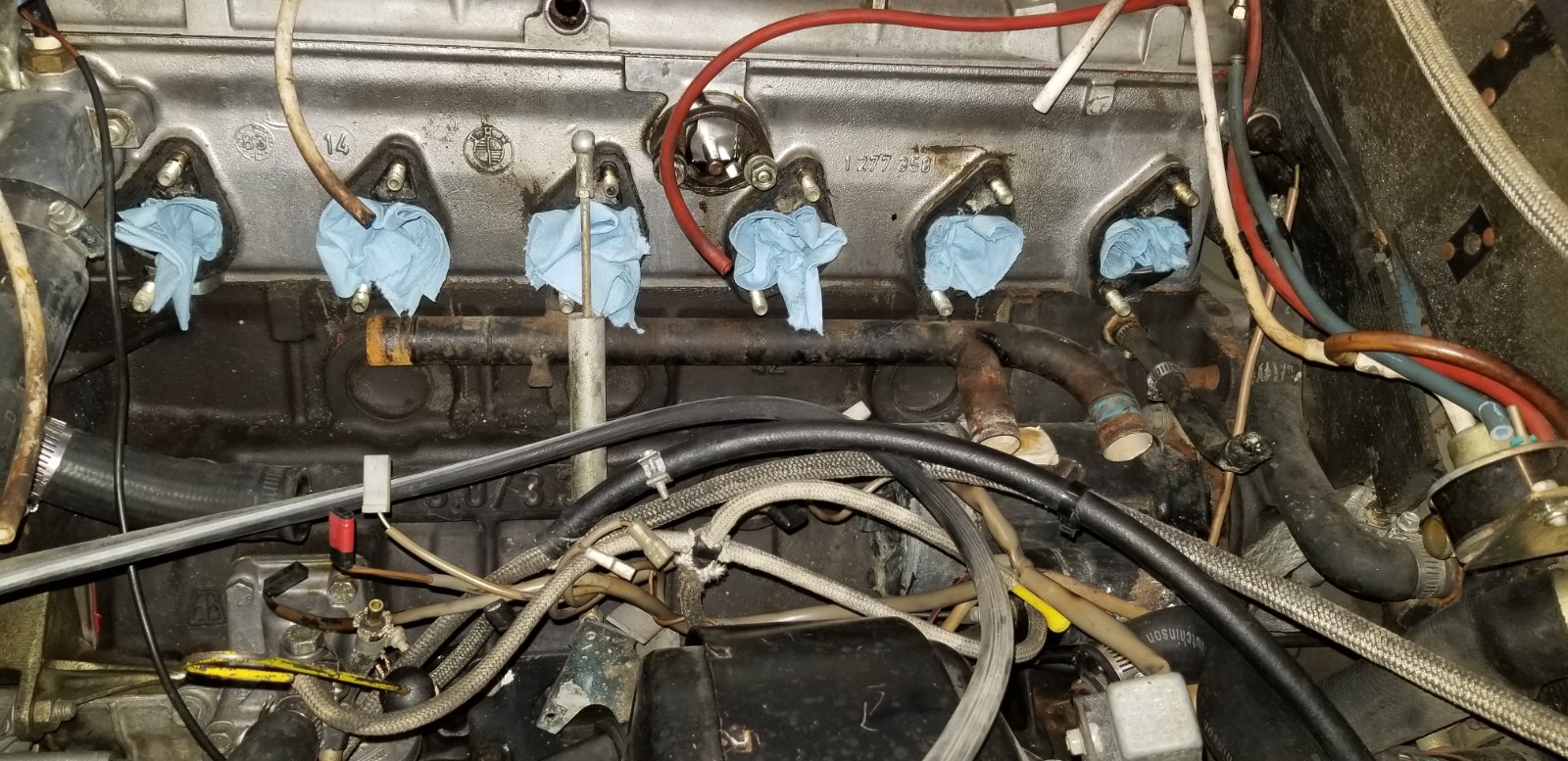

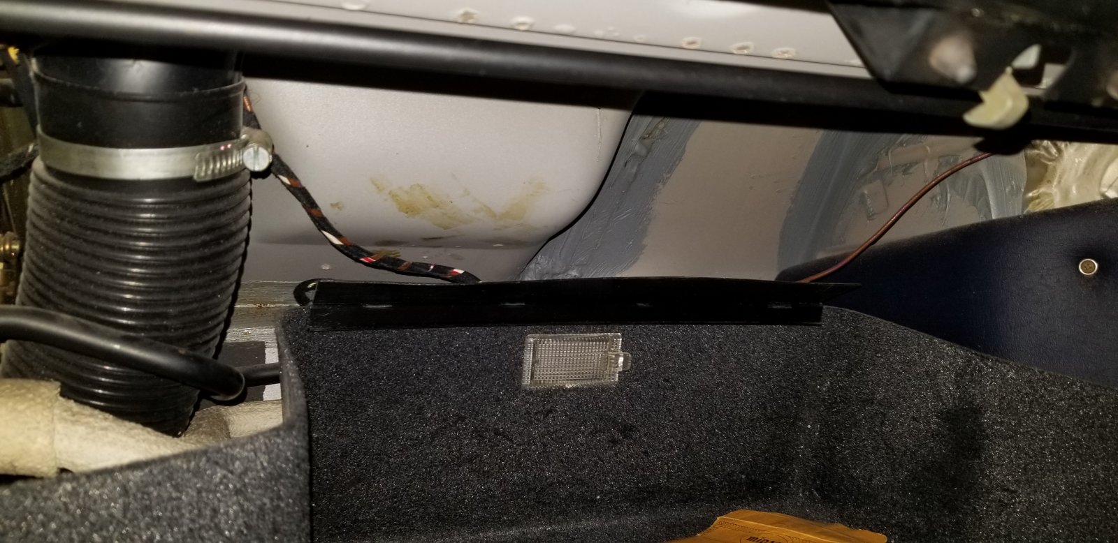

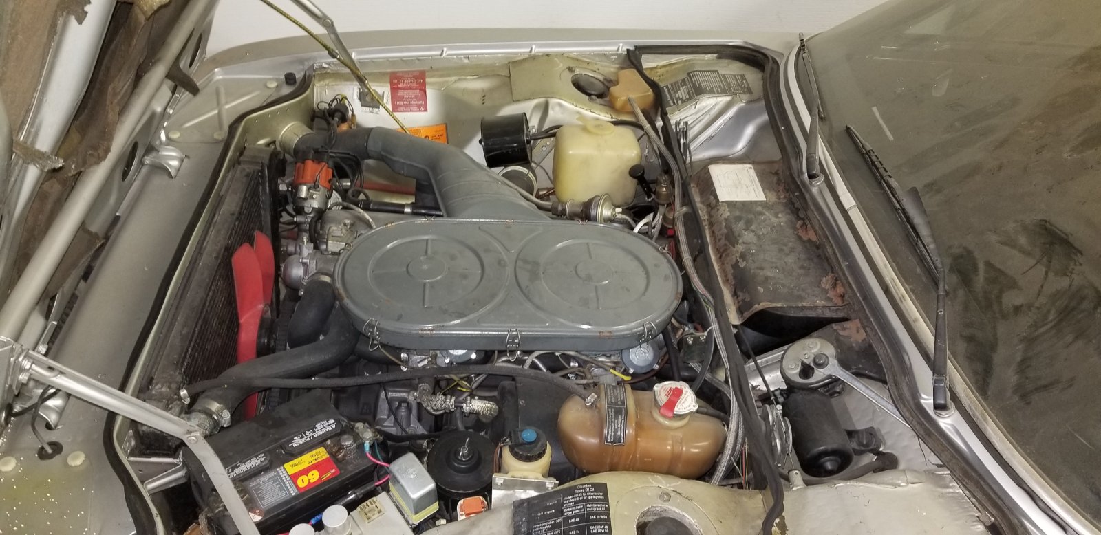

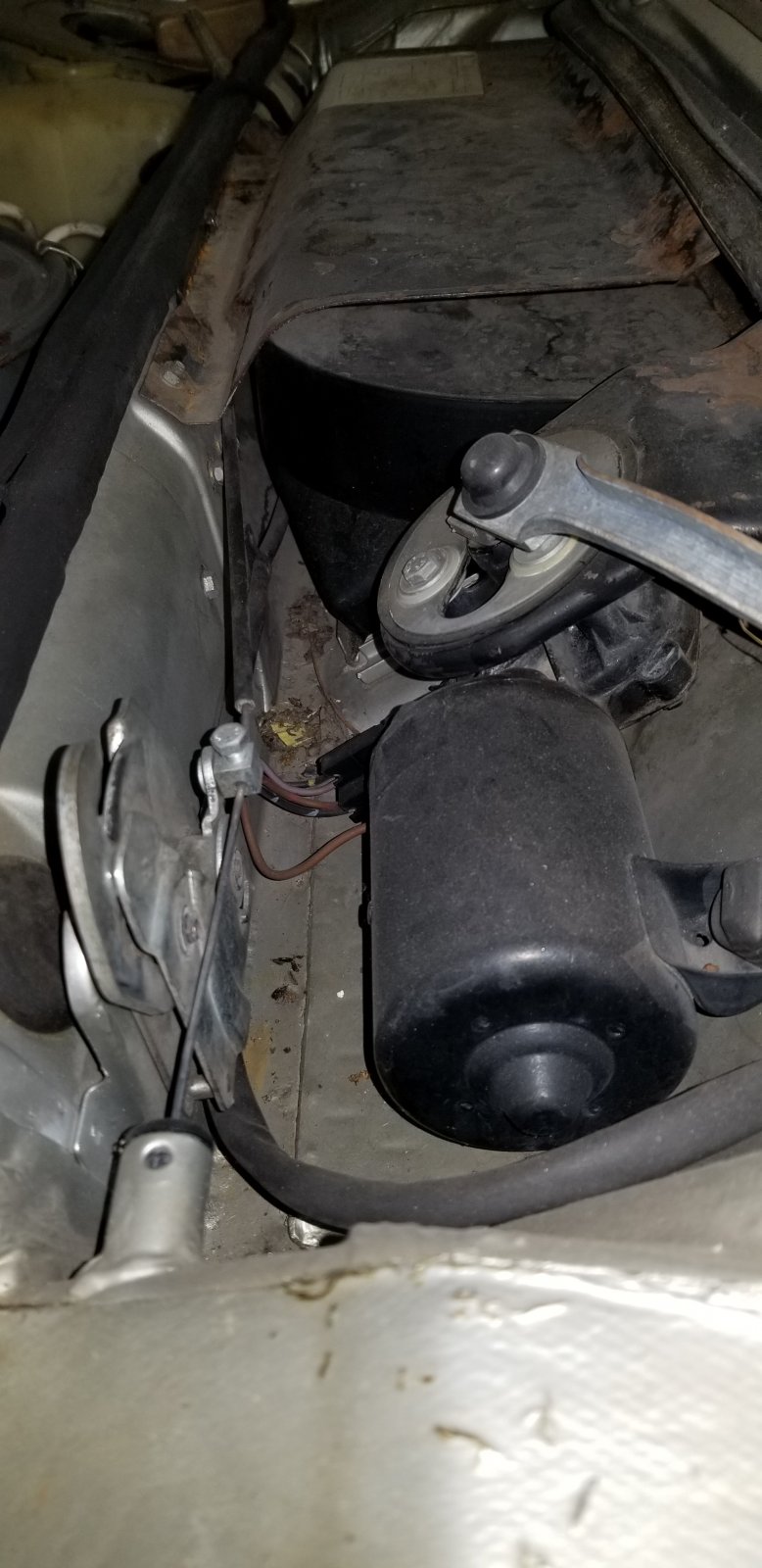

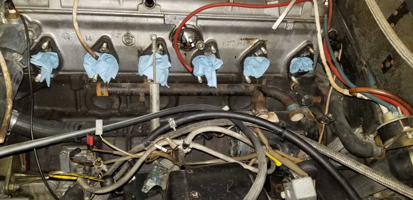

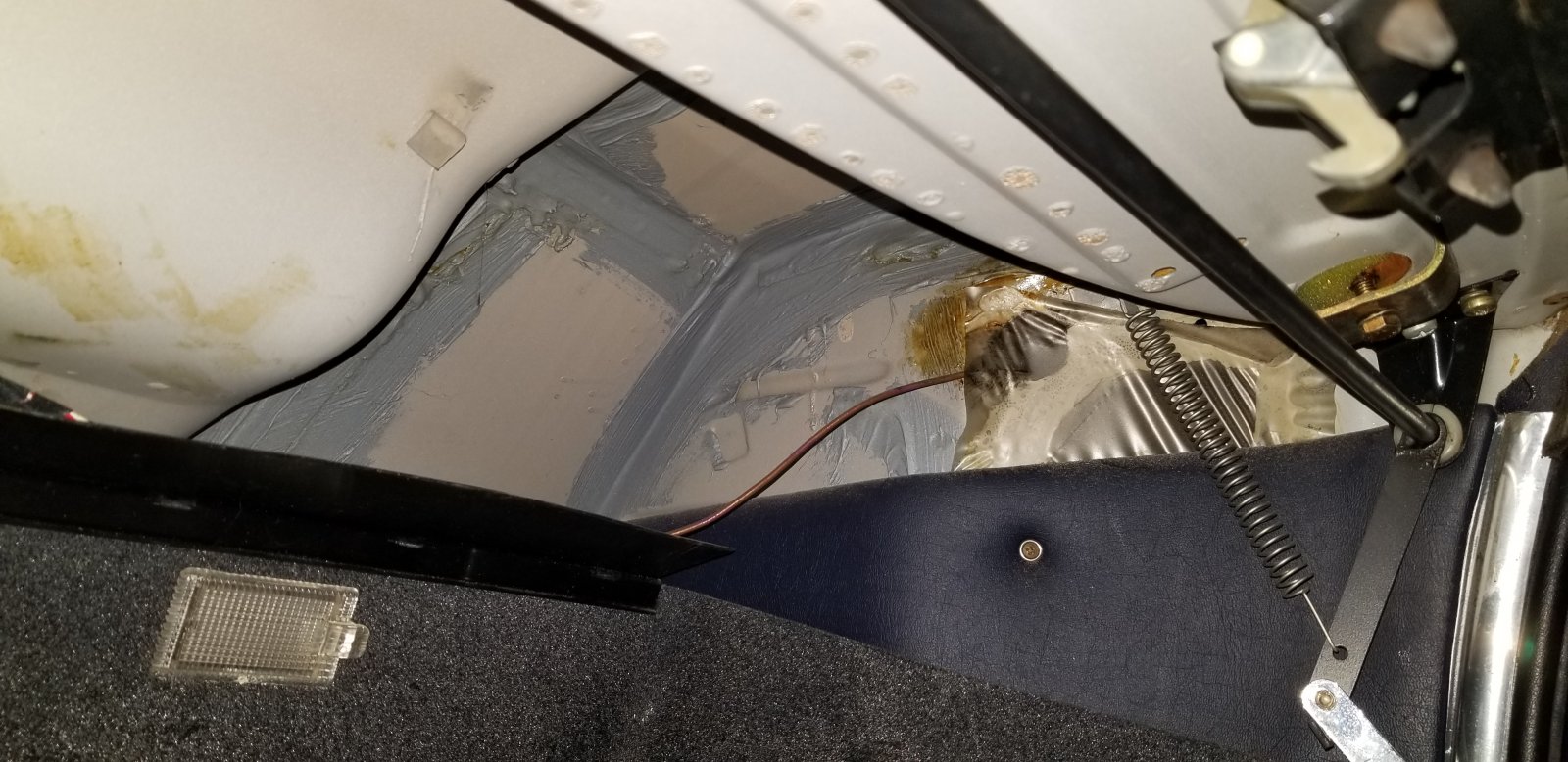

While I was in town over the mountains for the holidays, I managed to sneak away to the garage and do a quick inspection as well as grab a few additional photos before being summoned back for family duties. Did not get to check under the car as thoroughly as I would have liked. Nor did I get to check the spare tire well, as the trunk was packed to the brim with stuff. Very poor lighting in the garage sadly, and the flash seemed to be a bit much in some of the pictures. Some rodent activity in the engine bay, but nothing in the car or trunk that I saw.

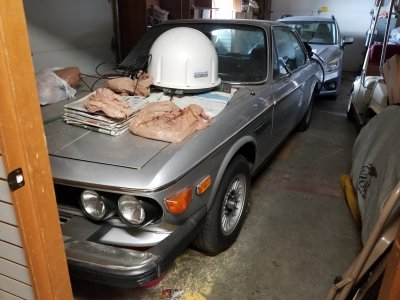

Haven't had a whole lot of time to spend with the car in recent time with the passes and weather etc. Still stockpiling some parts and cleaning things up when I can.

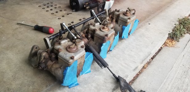

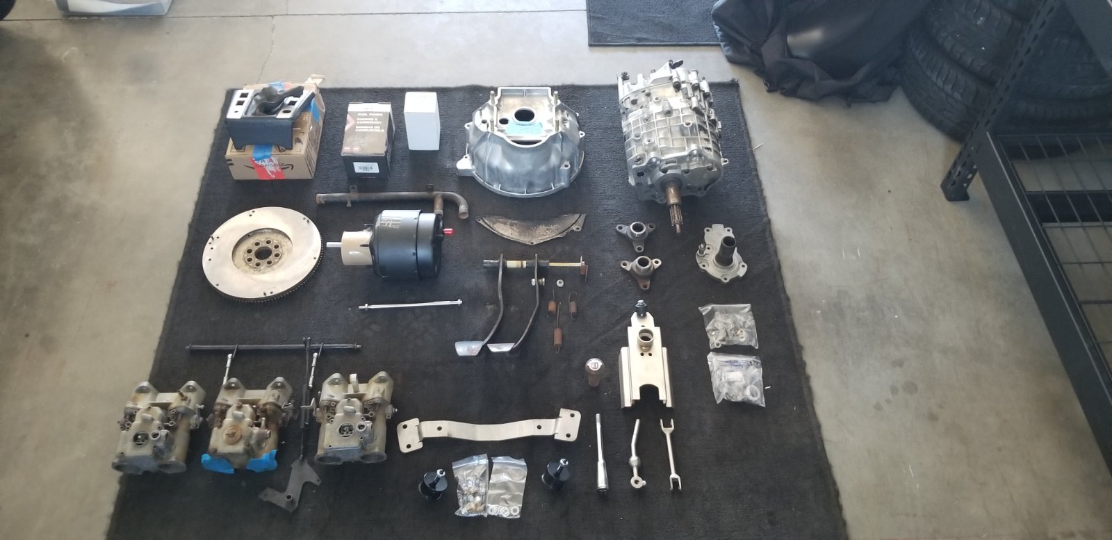

Small update:

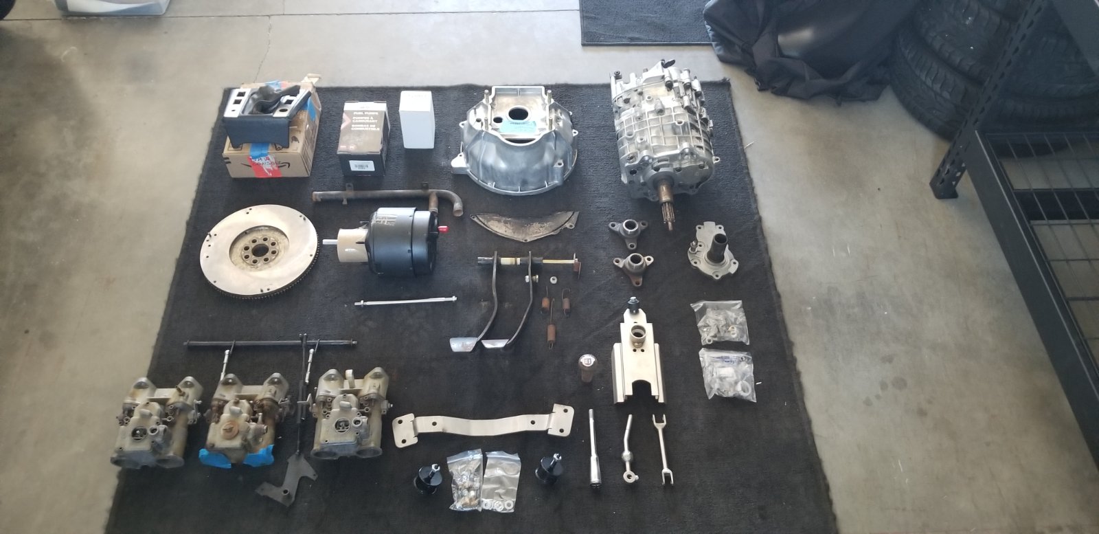

Triple Webers rebuilt. (I kept the somewhat grungy look to match the car for now, internals and seals are all fresh. I've acquired a thermo housing spacer to clear manifold)

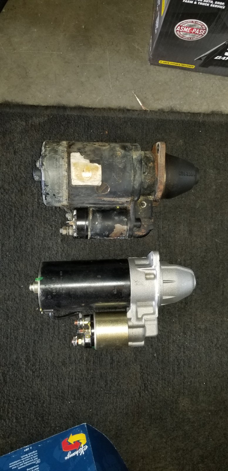

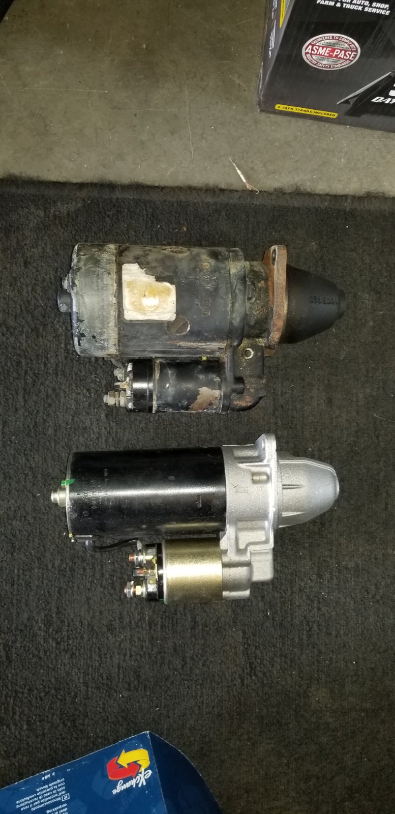

Bosch SR441x starter installed. (Left the black/red wire unhooked)
Fuel system parts acquired. (Carter P4070, Holley 12-804, Revolution fuel pump controller, small fuel pressure gauge, plenty of brass fittings)

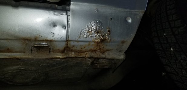

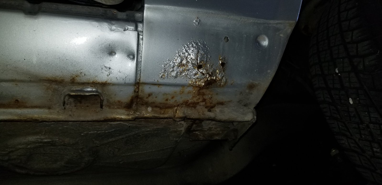

Found some rust in the passenger rocker I need to cut out and address.
I need to find/buy the shim for the speedo drive gear and get that installed. I've never pulled apart a getrag but it looks like I can get away with just pulling the rear-most case? Looking forward to getting the carbs installed along with the cooling system redone and getting this thing road worthy-ish enough to putt around town this spring/summer til the trans swap and suspension goodies.
