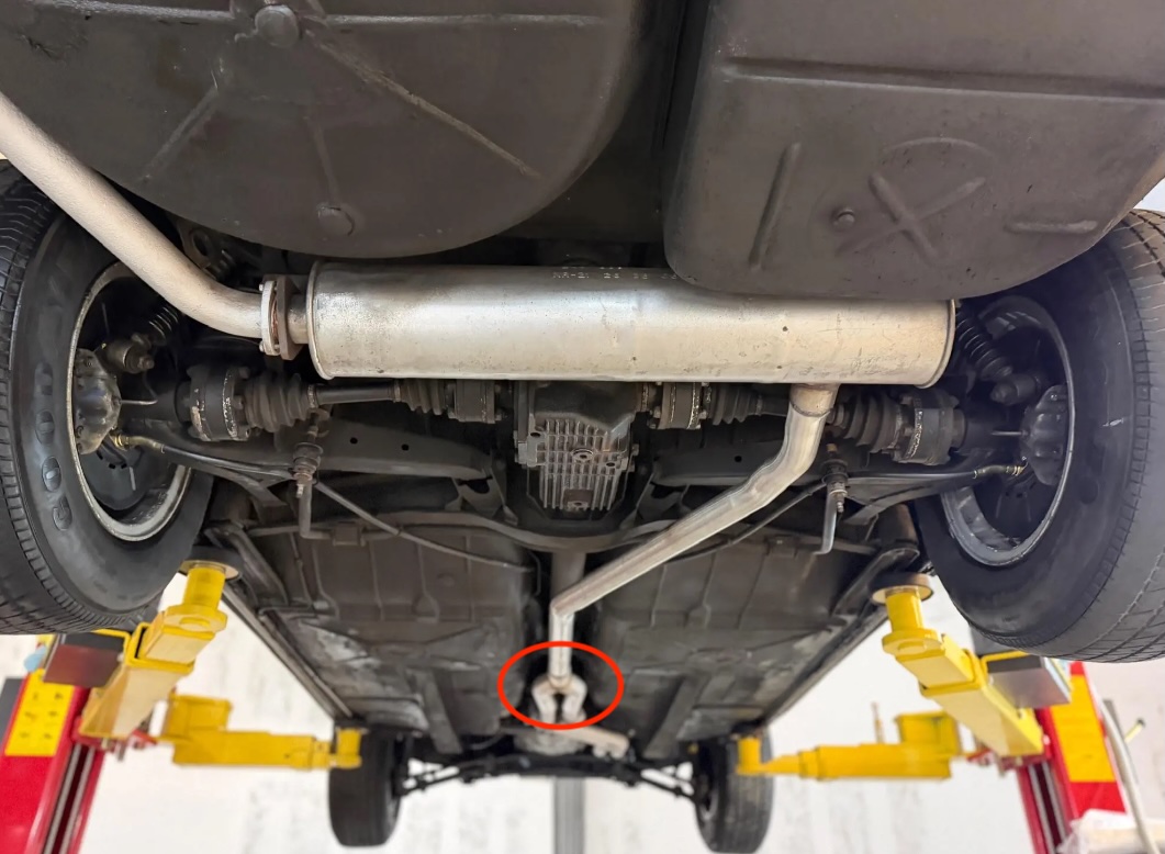

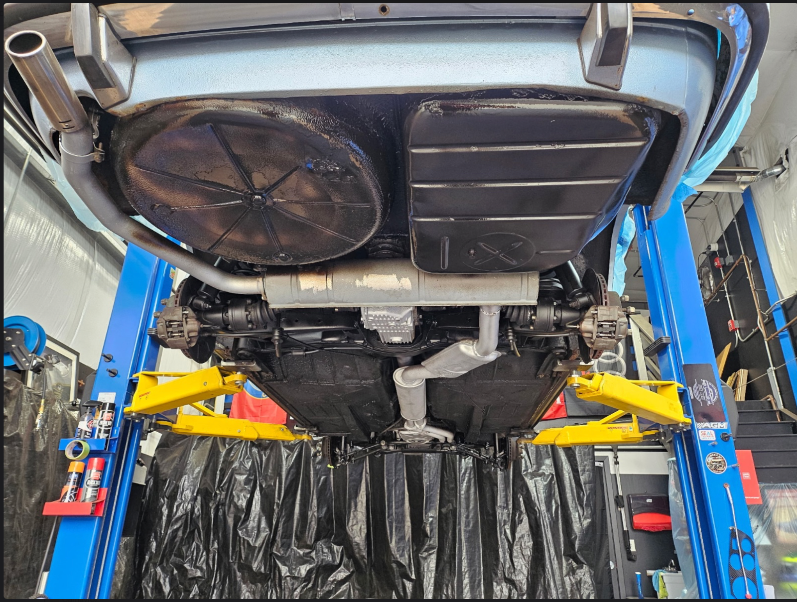

Is this exhaust factory?
that's easy.
1. there is no center resonator. the center resonator has 2 pipes entering it, this one has a 'Y' into a single pipe - pipes seem almost the same diameter
2. there is no middle muffler (the small one) that is on the angled pipe, before the pipe enters the rear muffler. some people delete this muffler and run a straight pipe to connect the resonator and the rear muffler. the bends in the pipe aren't mandrel bent, so the pipe deforms (not that good for exhaust flow)
3. the rear muffler does not appear to be factory, but that's a maybe small issue, look at the connection of the angled pipe to the rear muffler. do you see any connector to secure the 2 pipes together? i don't ... not good.
My biggest complaint would be that where the two pipes from the header join the single pipe, they are almost pointing at each other...
That can't be too efficient.
Rear muffler is factory as you can see the indentation around the diff but it is a horrible setup. The factory resonators and muffler are NLA from BMW.

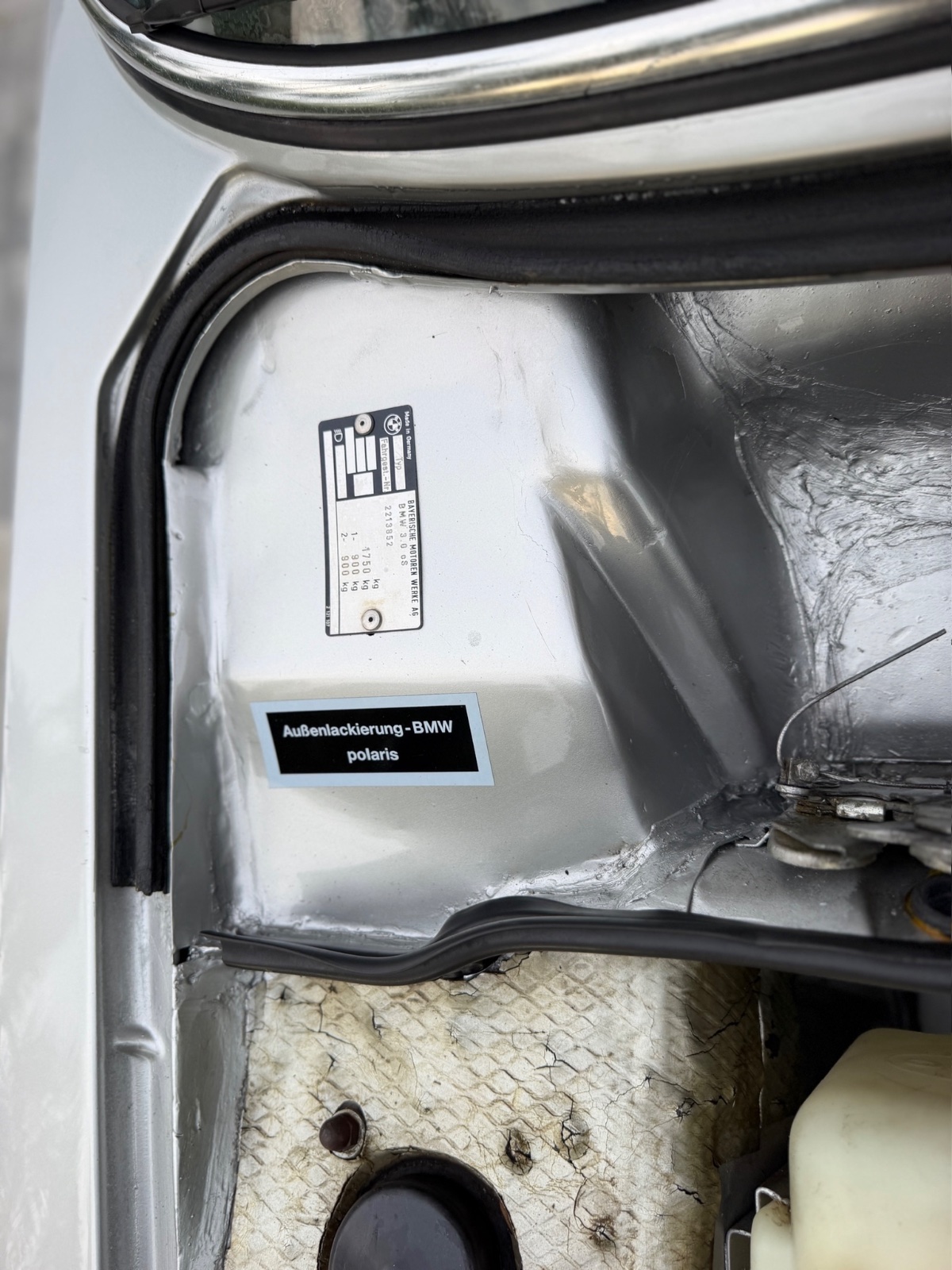

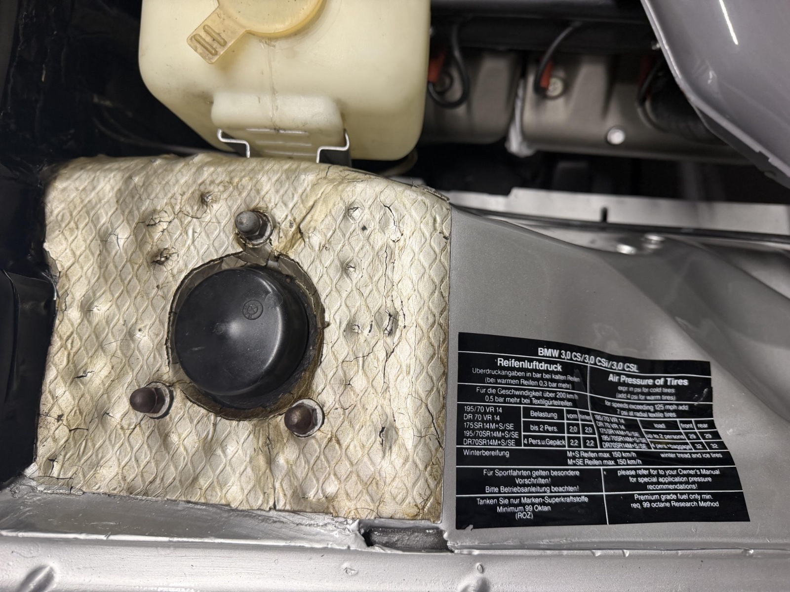

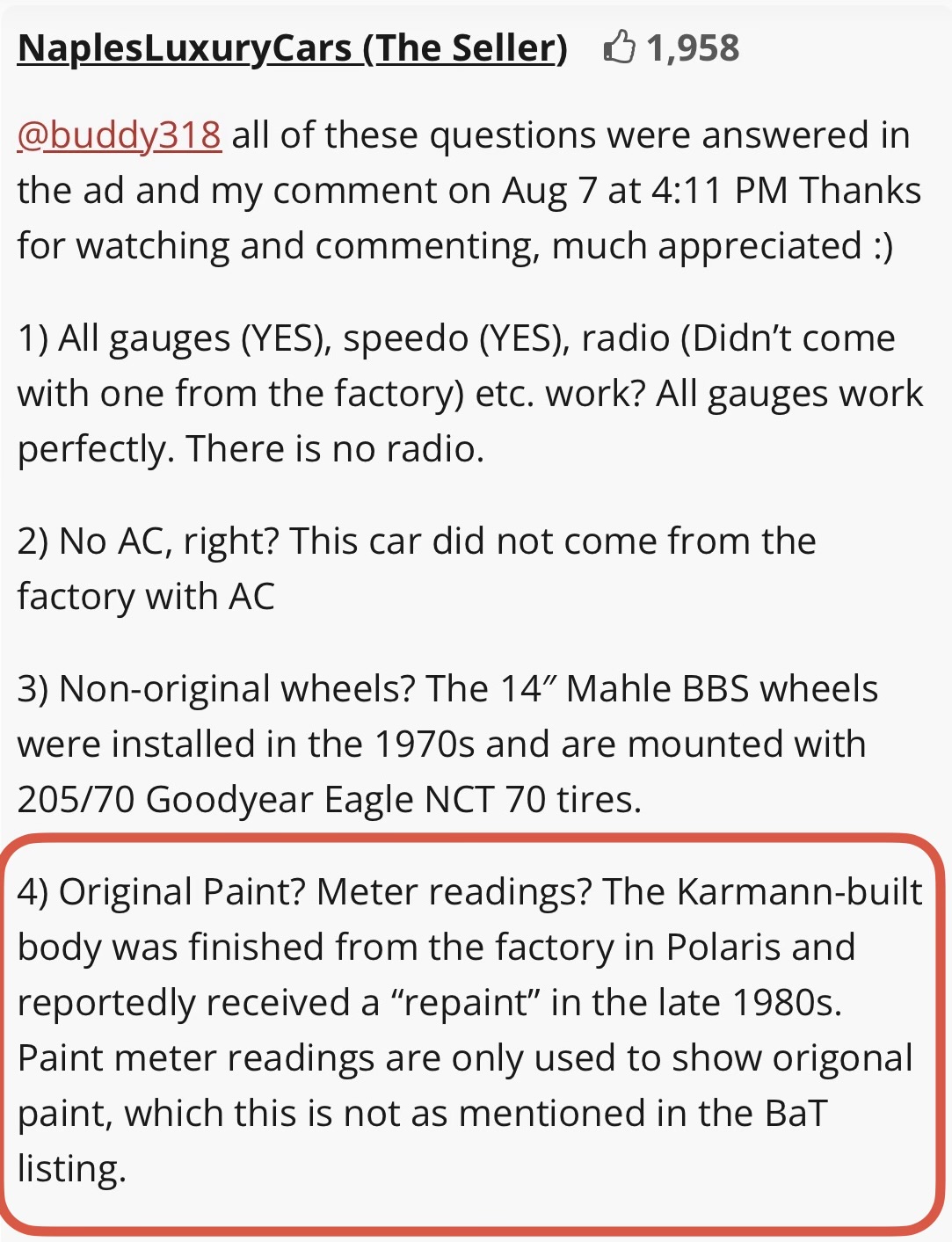

I actually like this car, but posting a visual aid given that the seller (dealer) says paint gauges are only useful when advertising original paint.
Dealer Statement:
Listed CS:

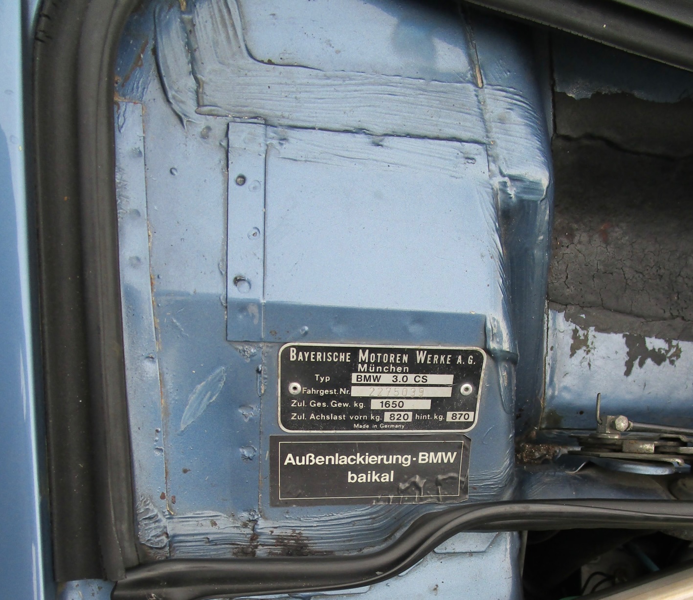

Using a CSL with minimal seam sealerX show what in this area is really about:

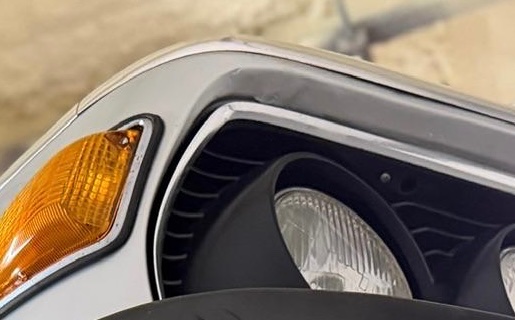

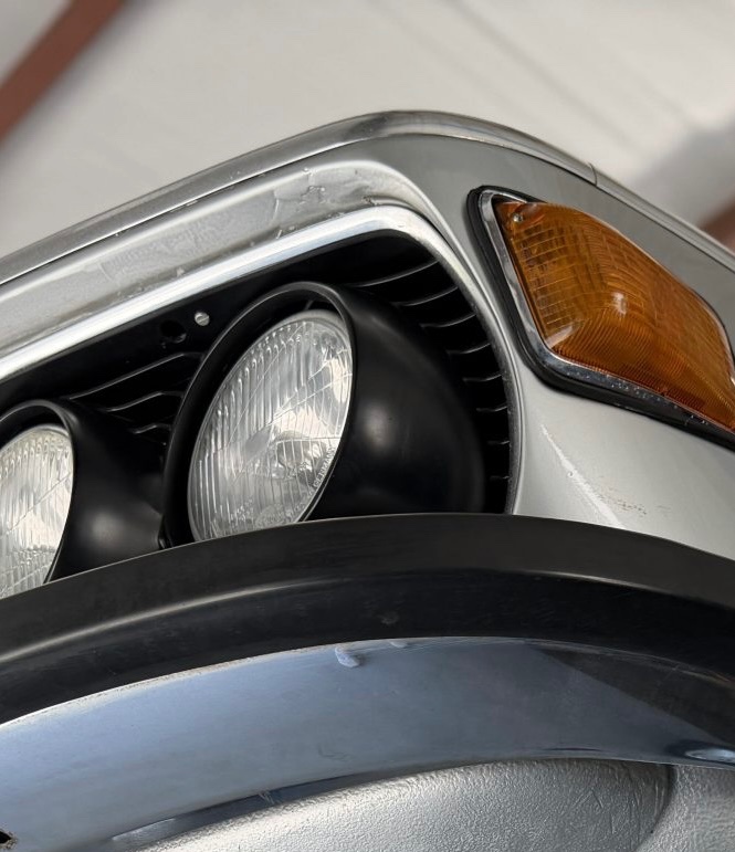

The car is said to have been repainted in the 80’s. I think that was the first repaint. My thesis is that the fenders were repaired and unoriginal butyl mat was added to the strut tops. Also, factory spot welds on the strut tops leave divots not protrusions. Honestly those look like fasteners, maybe rivets. That carmelized polaris on the sound deadening would be from the 80’s since it is unoriginal AND painted. You can see where it is taped off at the border. Thesis current paint looks “too new” IMO and not 40 years old. I know you can have clean paint but other cars are more honest presentations.
A potential buyer is asking about fender repairs and the dealer is giving them nothing. Used car dealers are experts at spotting filler and crash damage.

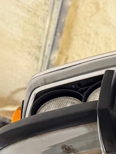

For those farmer familiar, you need to cut the fenders off and the front weld is above he headlights. The cars didn’t leave the factory with a seam like this:
