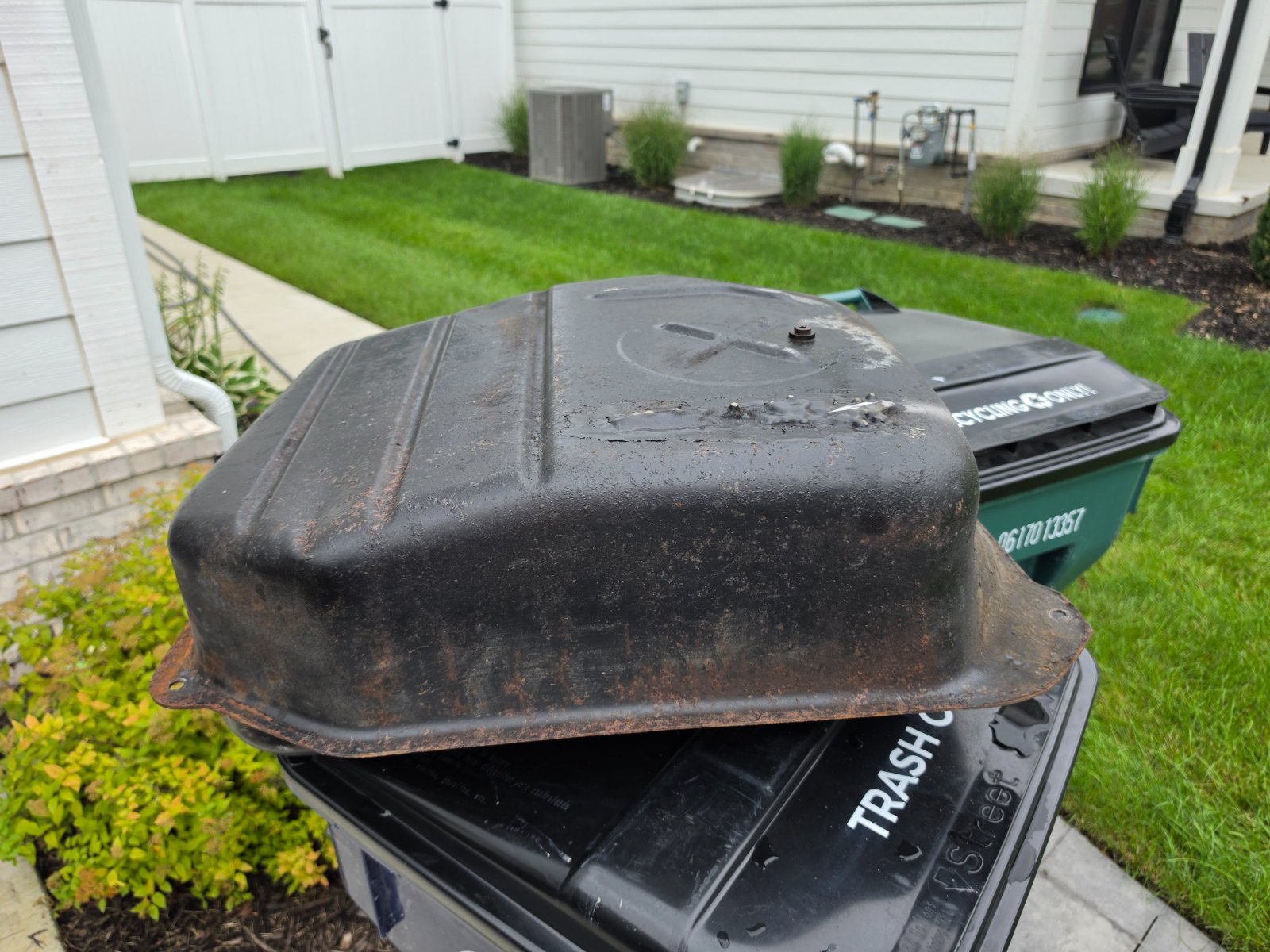

The service manual shows the tank coming out through the trunk, however my tank bolts from below. I can only assume that earlier models came out this way. All three bolts have been removed but no luck. What am I missing?
All MY 74 are mounted from underneath, it is stuck to the sealing material which can also lead to rust. There should be five bolts, at least the early tank uses five, can’t imagine yours needing less.
My E3 came out through the top like this, Remove everything like you said and raise two foot up on hoist. Place 5 gallon bucket underneath the tank and lower vehicle onto bucket. When it is elevated about 6 inch's turn the tank counter clockwise. Hope you drained the tank.
