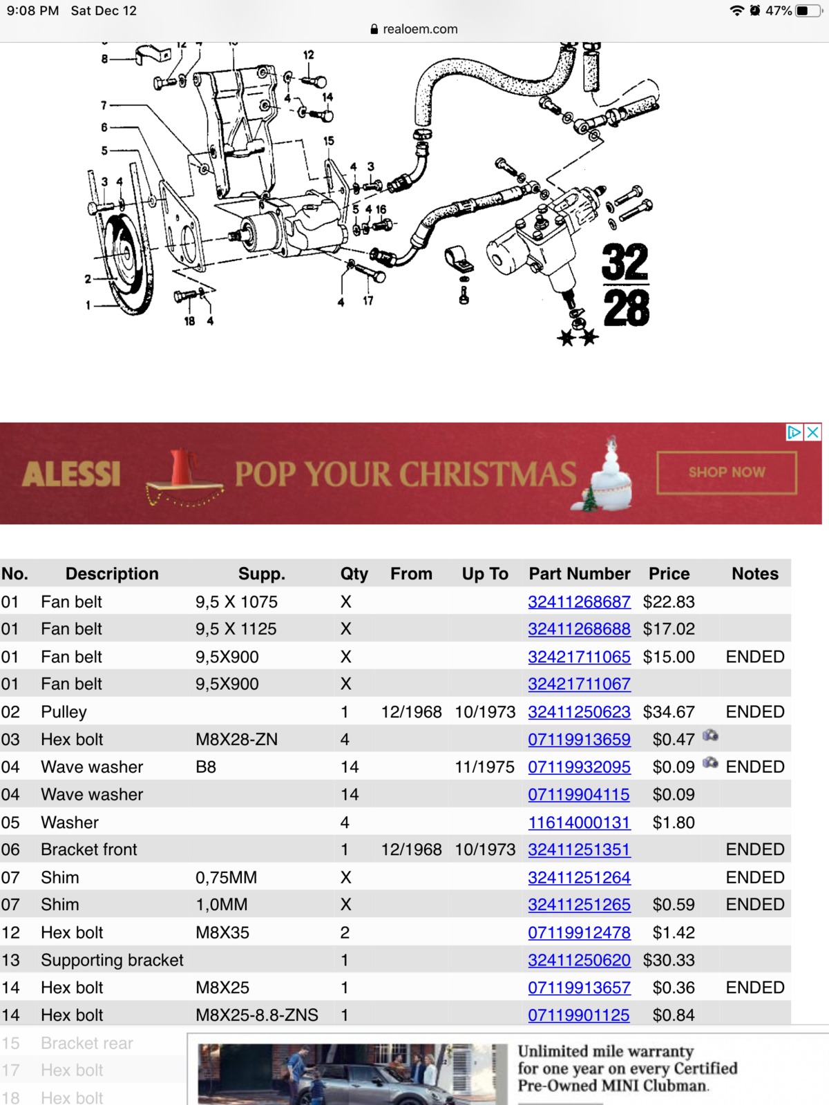

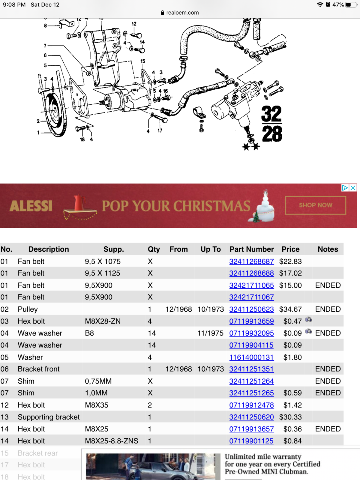

Here’s the PS info...

Online parts catalog (realoem.com) is your friend. I Use it to study part number differences between production years when I’m looking for parts or sometimes just for fun).
