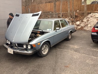

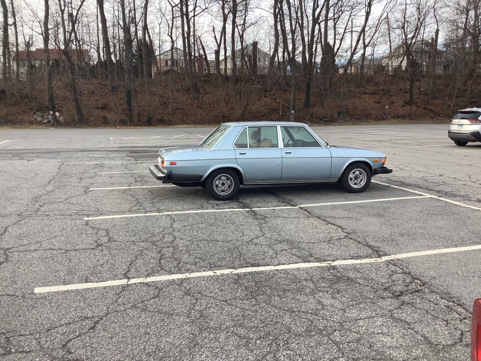

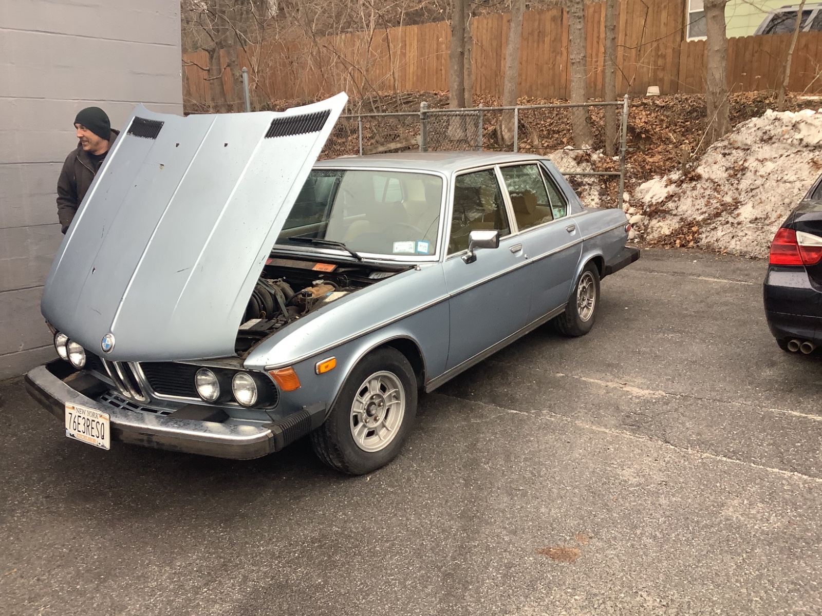

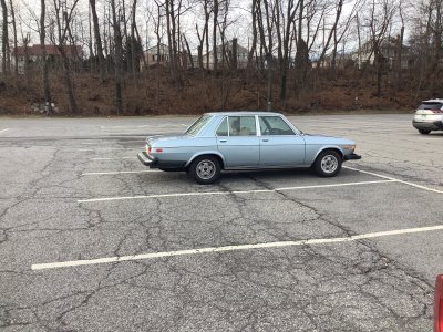

Friendly hello everyone..sincerely hope everyones Projects are progressing positively….and wish i could say the same (wink / smile)…my fjord 76e3-3.0si suddenly has automatic transmission issues, only goes backwards. It has original ZF 3HP-22 and just under 100k miles. Even in my Westchester County NY / Hudson Valley areas there are several rather good vintage bmw/german shops BUT none really deal with Transmission fixing / rebuilding…So, do i still consider rebuilding it at some out of state (northeast ?) shop OR do i instead now consider a Transmission swap (4sp/5sp) instead of my current 3sp Automatic having issues ? Any feedback is appreciated…thomas
