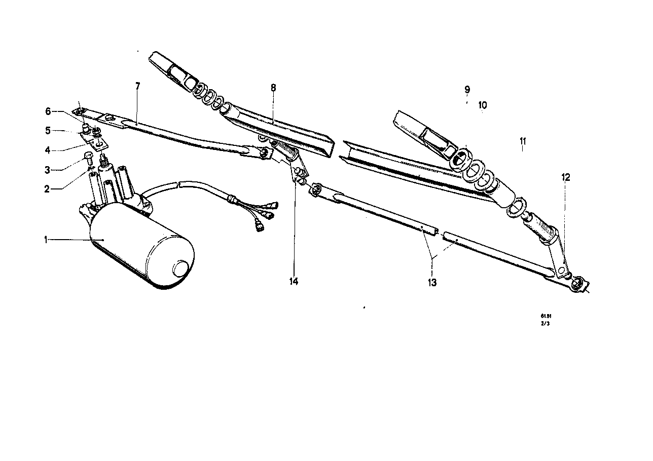

i looked to see if it was a different motor than the 2800cs / 3.0cs or the 2002 and it is. no idea if the 3.0cs assembly would fit into the 2000cs. can you post a pic of the assembly in the car? also, what is the measurement between the wiper arm posts? this is just a curiosity thing.

got it ... my thought was to see a pic of the actual car and to know what the dimension is from post to post. finding a working motor from a 2000cs might not be easy ... but if the dimension from post to post was approx 20 3/16" then the e9 coupe part might fit. those parts aren't that hard to get.
Between the posts the measurment is the same. I wonder what fabrication I would need to make such as a bracket to hold the E9 assembly. But what I could see from the E9 is that the motor is mounted in the middle and would interfere with the 2000 CS fan motor. Also, the 2000 CS motor has only 2 terminals. Thanks again.

the 3.0cs motor is NOT in the center, it on the drivers side of center. the blower / intake is in the center.
