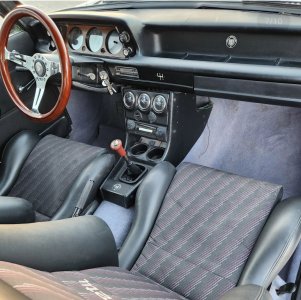

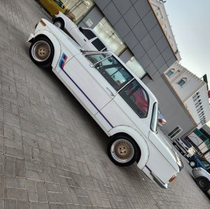

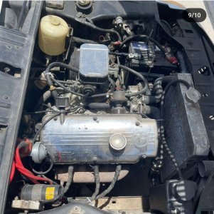

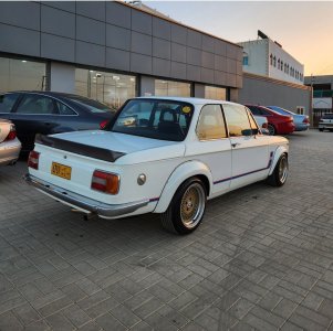

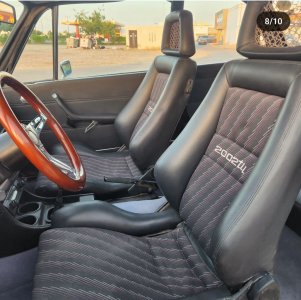

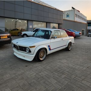

HusseinBM
96
24

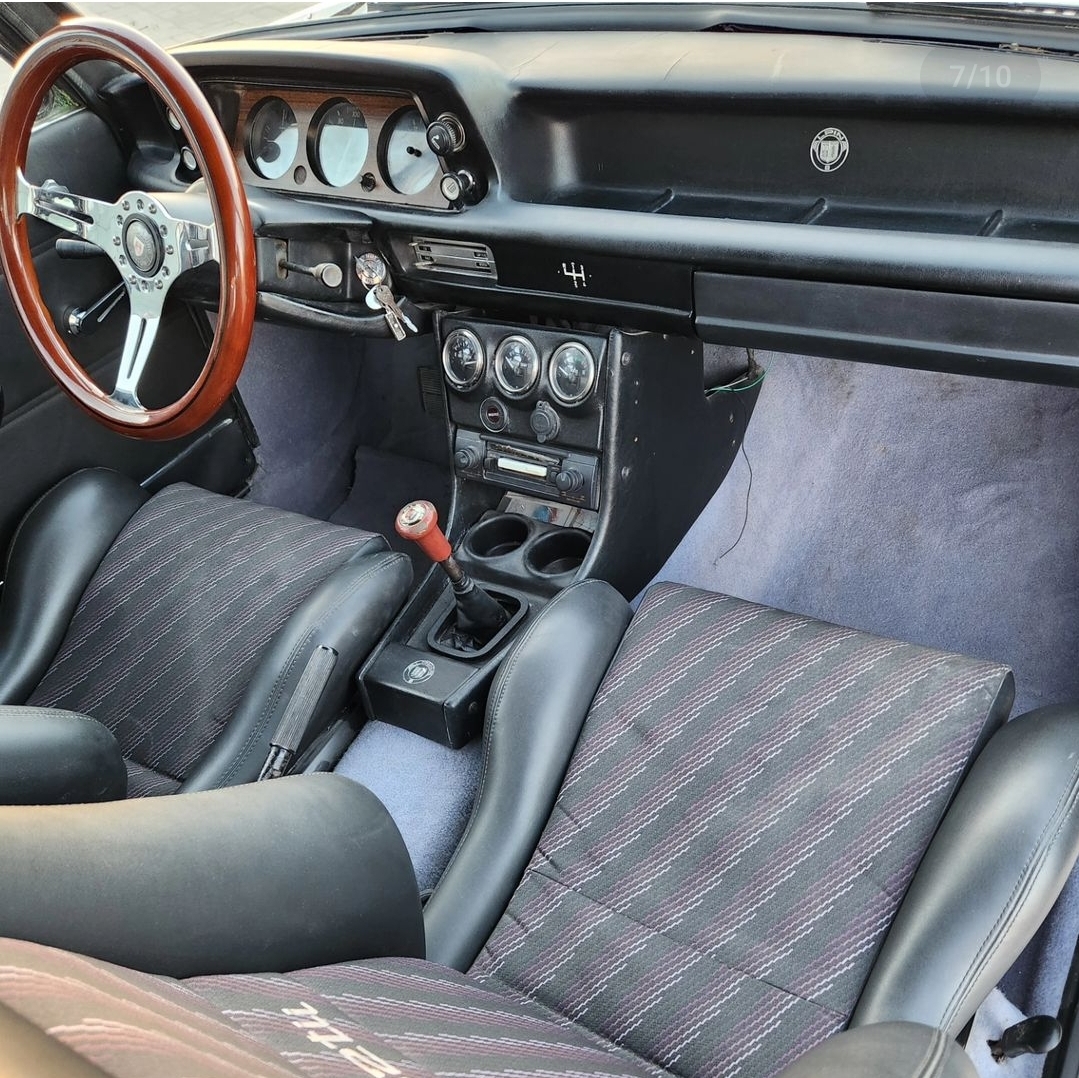

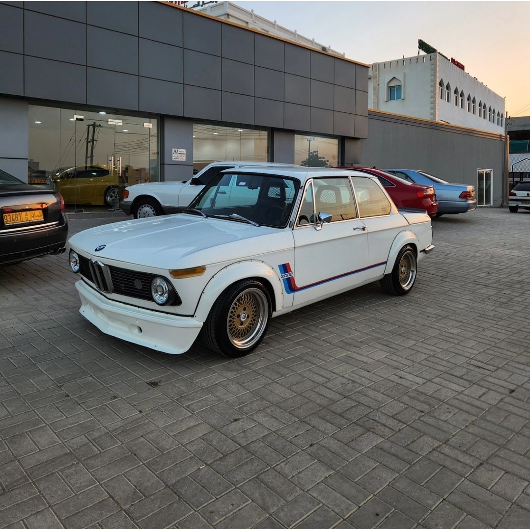

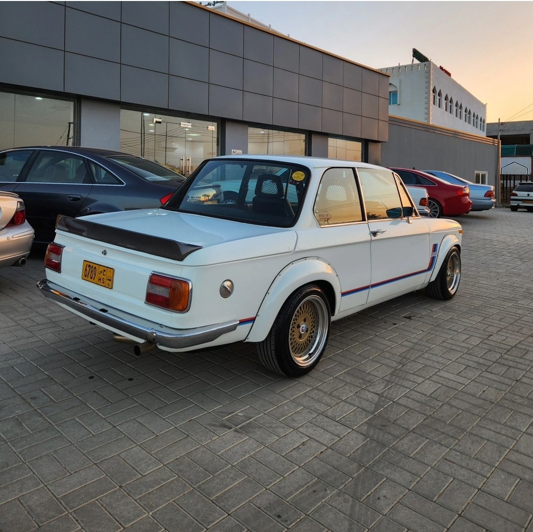

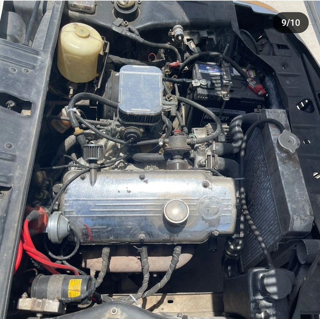

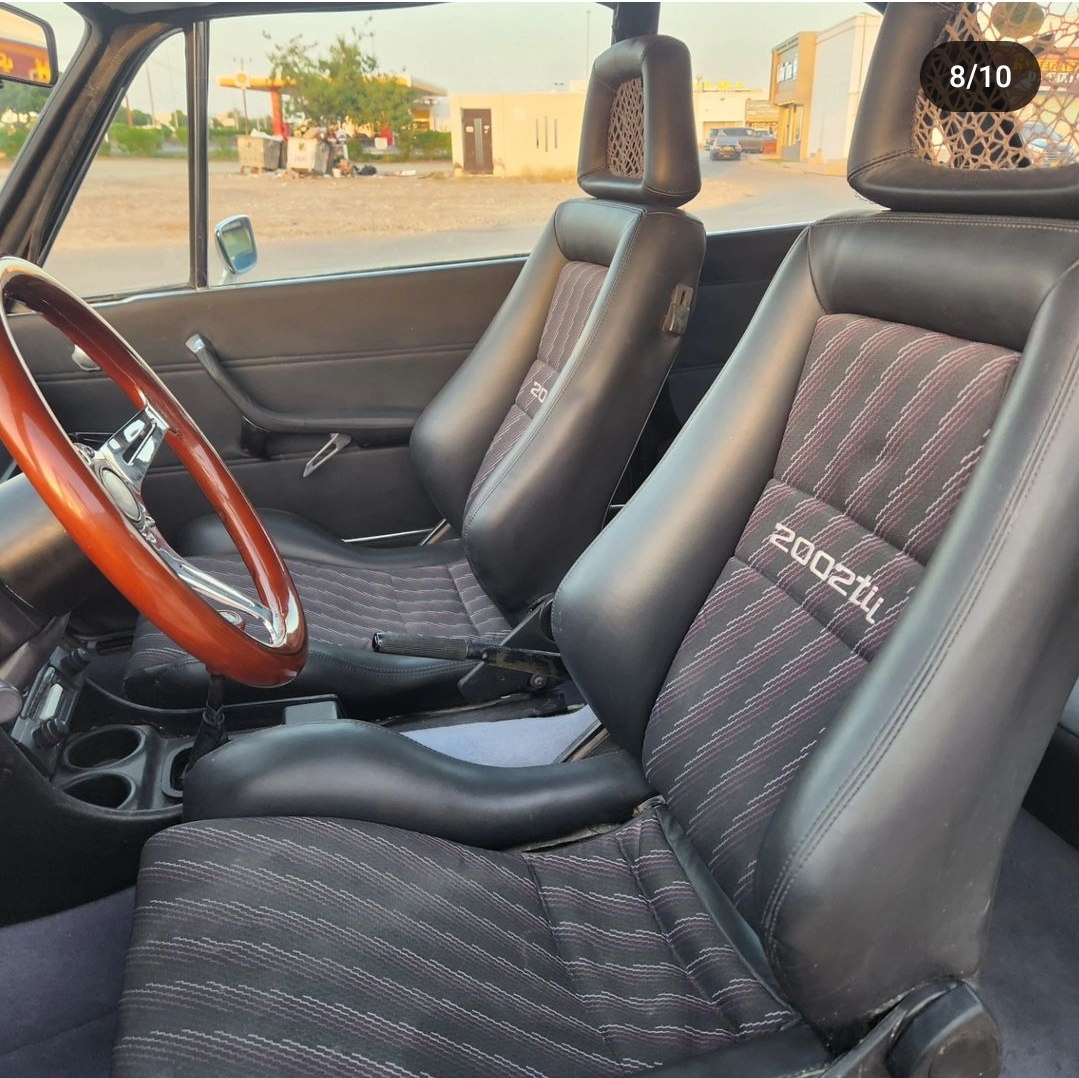

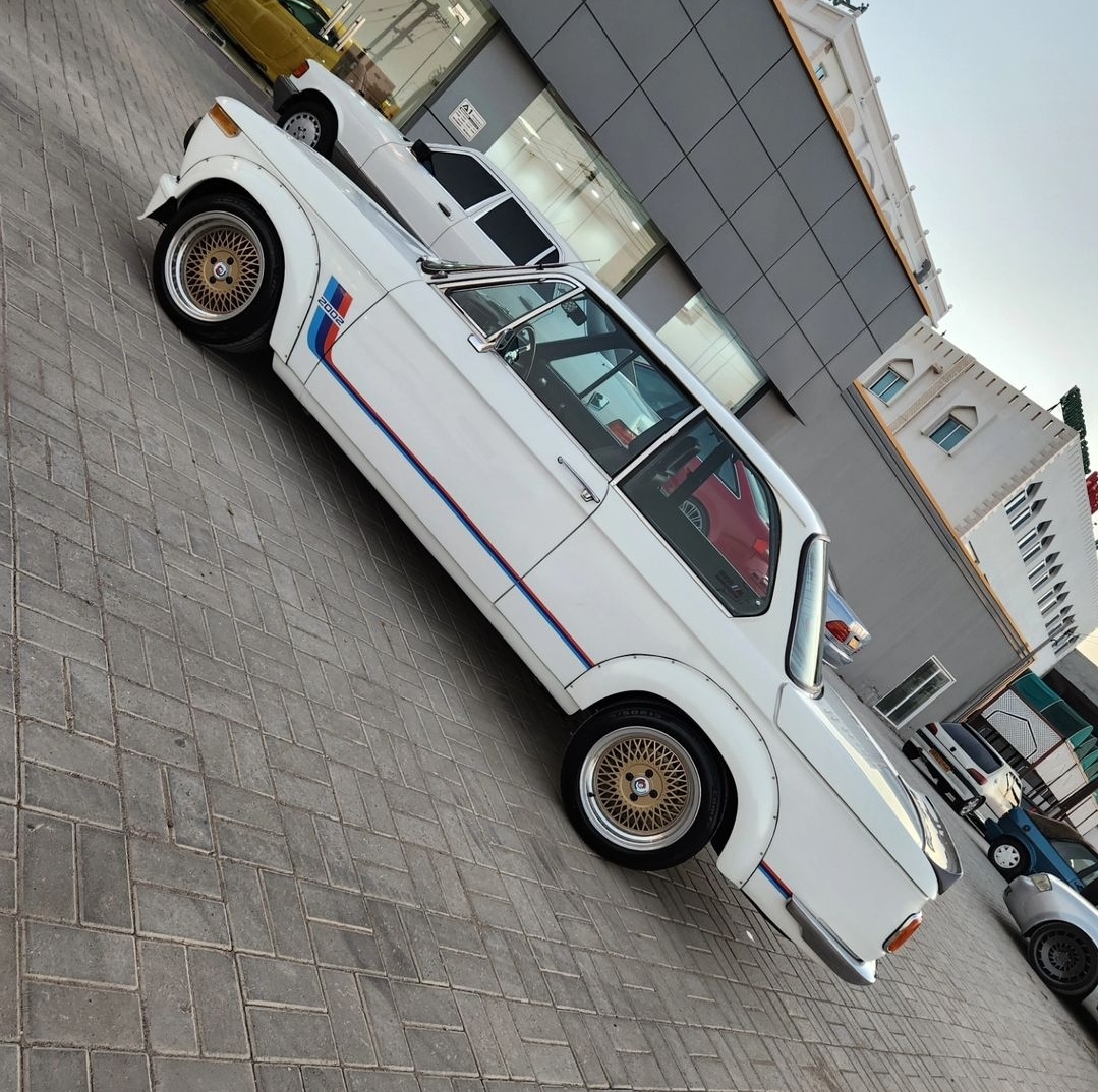

Thats a "frankenstein"
turbo fenders and decals, 1 carb, as written tii seats.
Looks nice, but, thats everything, but not a Alpina.

i don't see anything that is Alpina except possibly the rear spoiler. don't think any Alpina engine would have a single carb. the seats look like 320i seats recovered with Motorsport fabric with the tii embroidery. early Alpina used the Scheel seat as i remember.
a few things that Alpina cars might have had
- hot engine
- Alpina steering wheel
- Alpina suspension
- Alpina fabric seats
- Alpina wheels
- Alpina air dam
