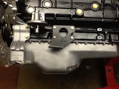

Anyone with a sharp eye recognize anything unique about our motor? I am in the assembly process which is the fun part. Perhaps Don will spot it first.
No, it's the oil pan. I've been told early oil pans had a sloped front shape which caused oil starvation issues, there is no large baffle inside either. BMW replaced these pans but ours was not, date stamp is 1969. These parts were tumbled and clear ceramic coated.
Srennoc found it ....
No sway bar you! Not with that oil pan.
