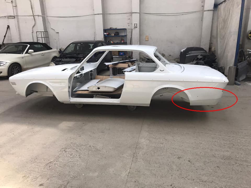

Well, it's interesting. Looks expensive without lots of pics of the repairs. Parts of the interior look pretty beat up. Those dash surrounds say a lot about how the car was stored. There is something so appealing about a blank canvas though! If it was me, I'd likely just have it finished over there and make a hot rod driver out of it. A good reason for a trip if nothing else...

A lot of it just looks like it was painted over without time put into stripping/cleaning/prep. And then there's this red flag...

In my opinion, they created more work by doing what they did. The nose is not straight, some weirdness where the nose trim mounts, textured panels in the door jams? It would have to be stripped and started over.
