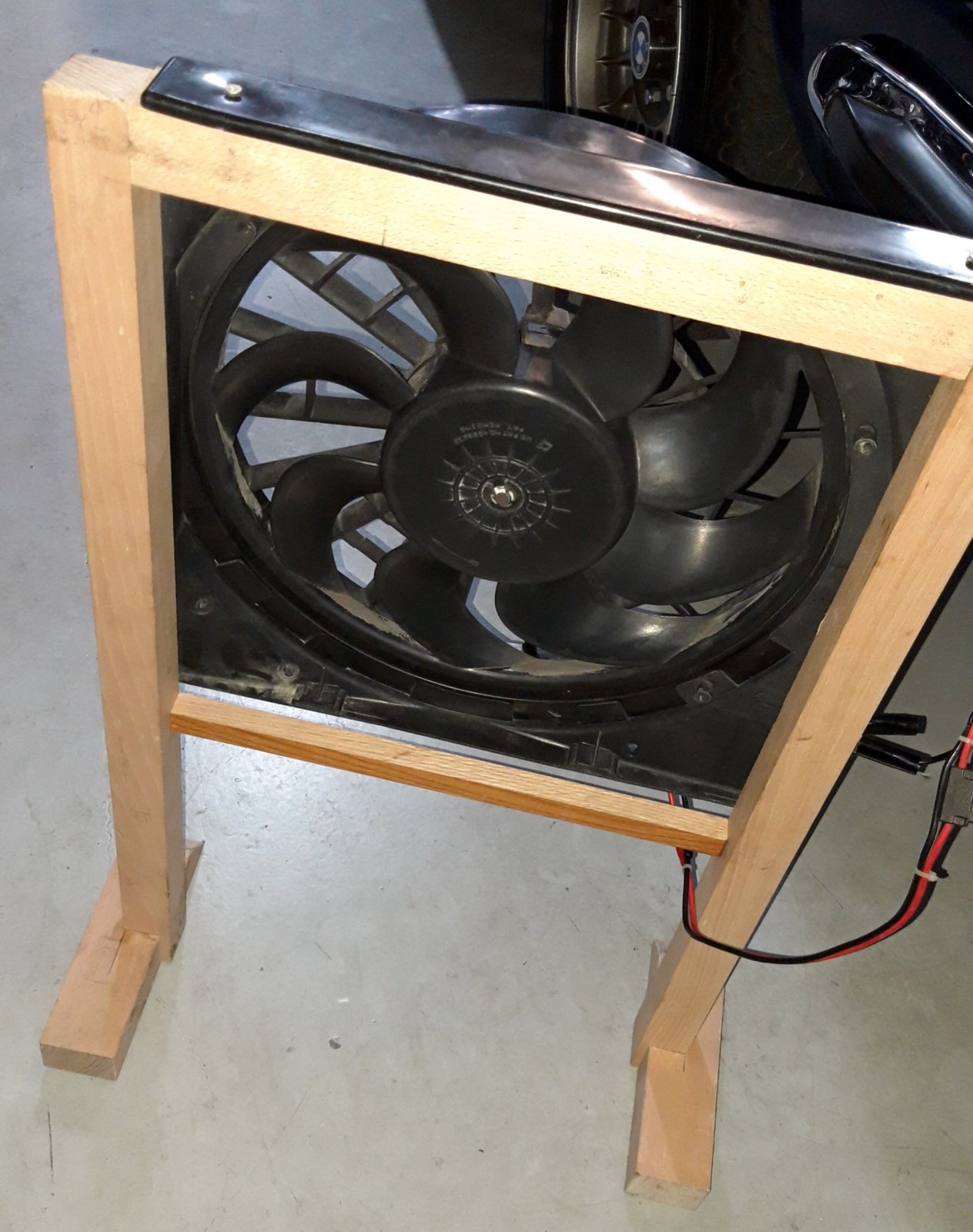

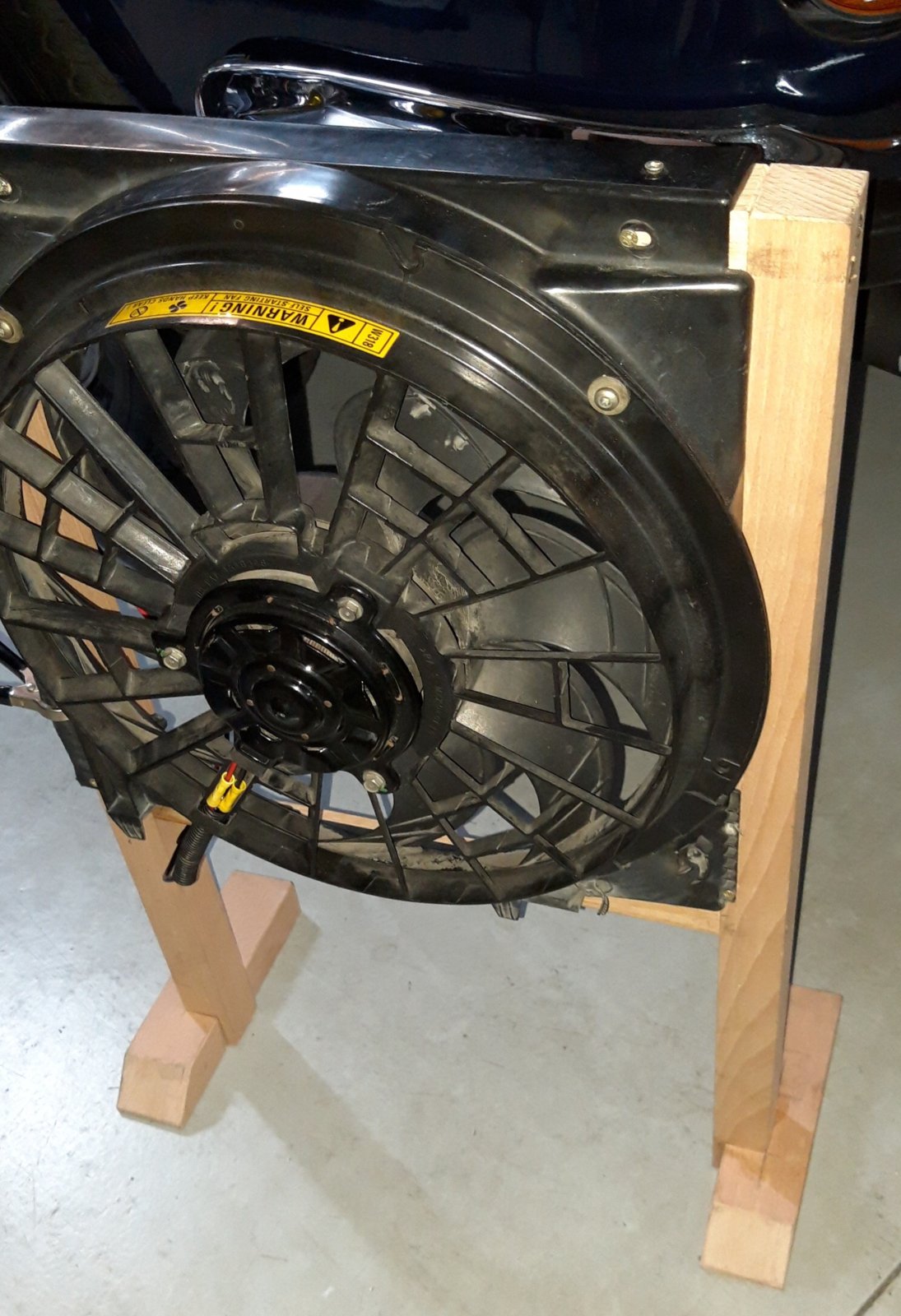

as this process needs some minutes to be completed, and having a 2v motorrad too i have prepared a protable fan
feed with a battery able for 30 minutes run
