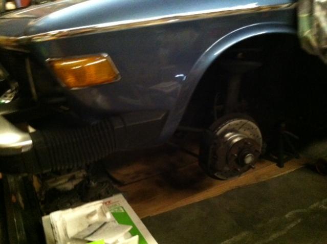

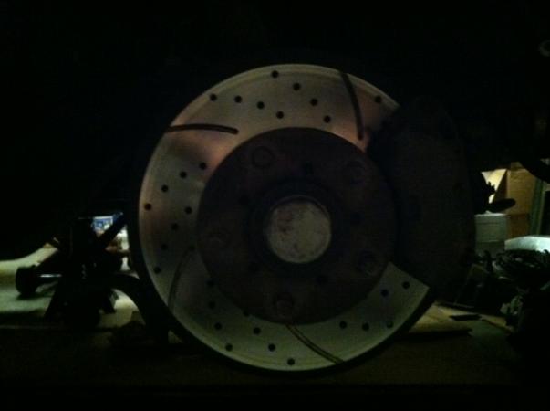

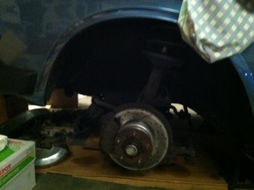

cs brake rotors
i got my aftermarket replacements from an outfit in southern california. brakeperformance.com. i got the slotted crossdrilled for under US$150 per pair for the fronts. it is working out pretty good so far with several hundred miles on it. check out their website.
cs brake rotors
continuation of thread above with pictures
