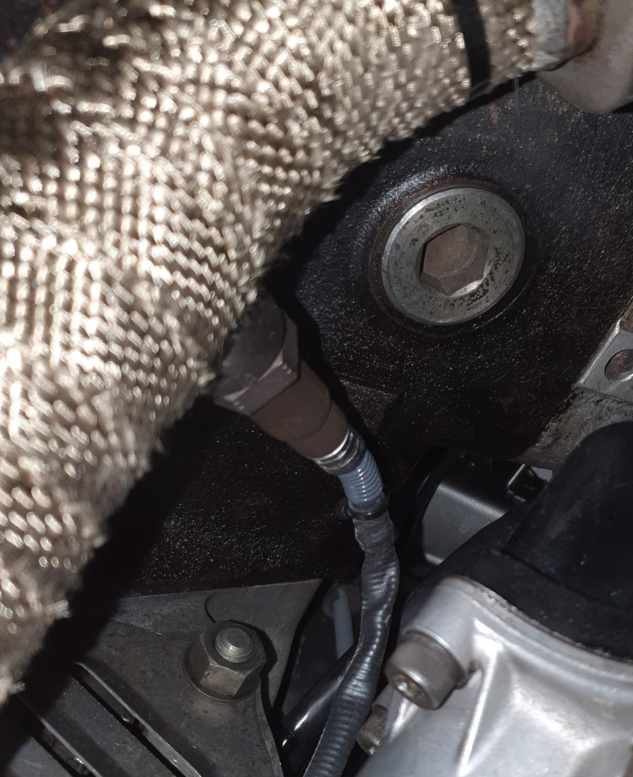

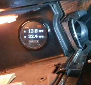

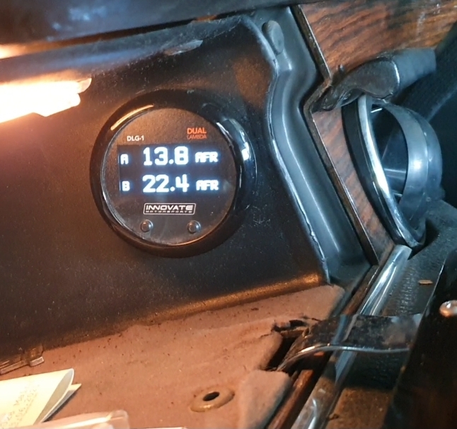

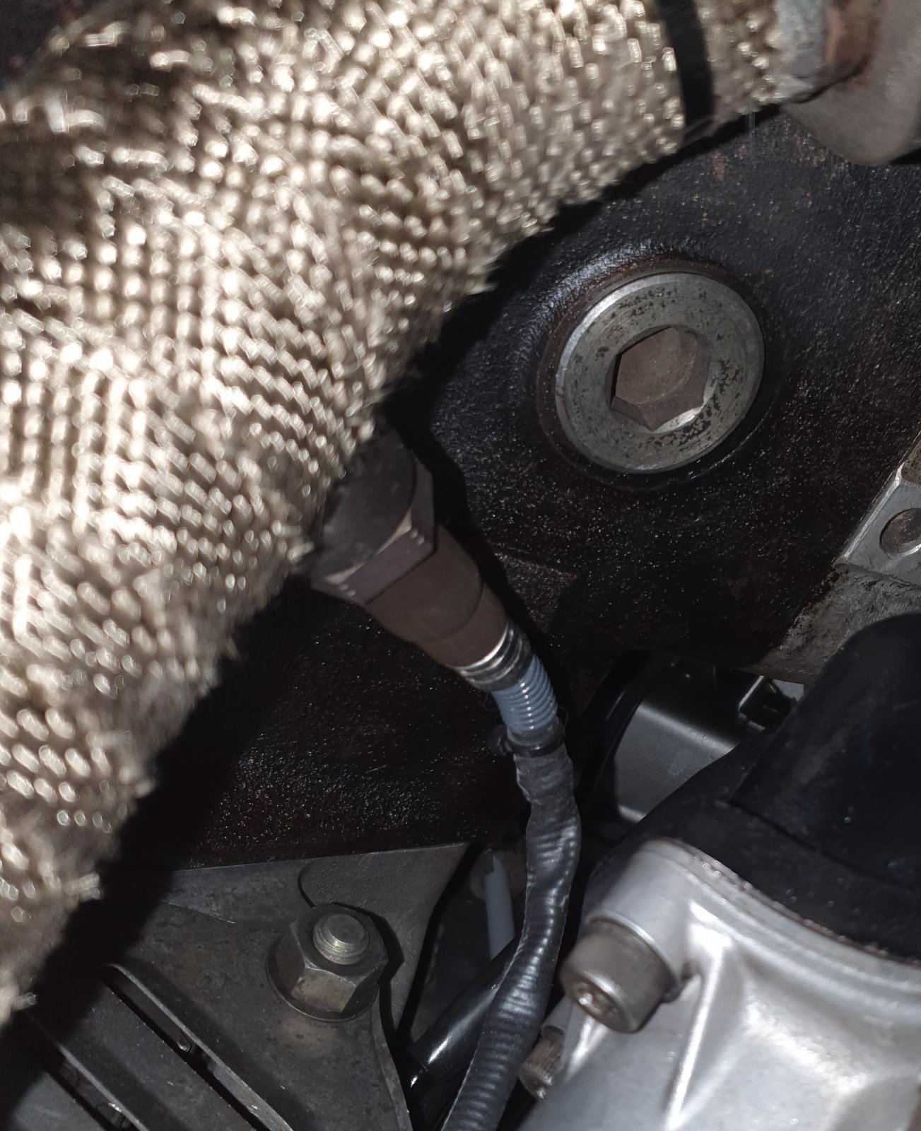

I hate to sound like a broken record but I think $200 for a wide band AFM is one of the best investments in tools you can make if you have old cars with carburetors, or old FI without O2 sensors. It will not only save U lots of time and $, but you’ll be almost as popular amongst your classic car pals as if you had a trailer. $200 for an AFM is relatively cheap in the grand scheme of things … about the price of a good floor jack or set of wrenches.
Ignition is relatively easy to setup and check on stock E9’s with a adv type timing light. Carb and old FI adjustments are much harder and fewer shops are good at it. (And not that many were actually really good even back in the day).
I'm totally da cor with @JFENG .
You can install the gauge hidden if you don't like the not original look.
I already done that at my Mercedes and I also will install on in the e9 as well.
If you use a2 channel system, it will be easy to tune in each carbs or determine the problem down to 3 cylinder.
