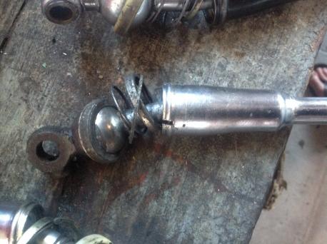

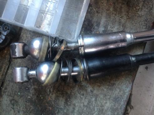

Make sure cut the matching notch on the e21 shifter for easy disassembly.
E9 shifter with notch
