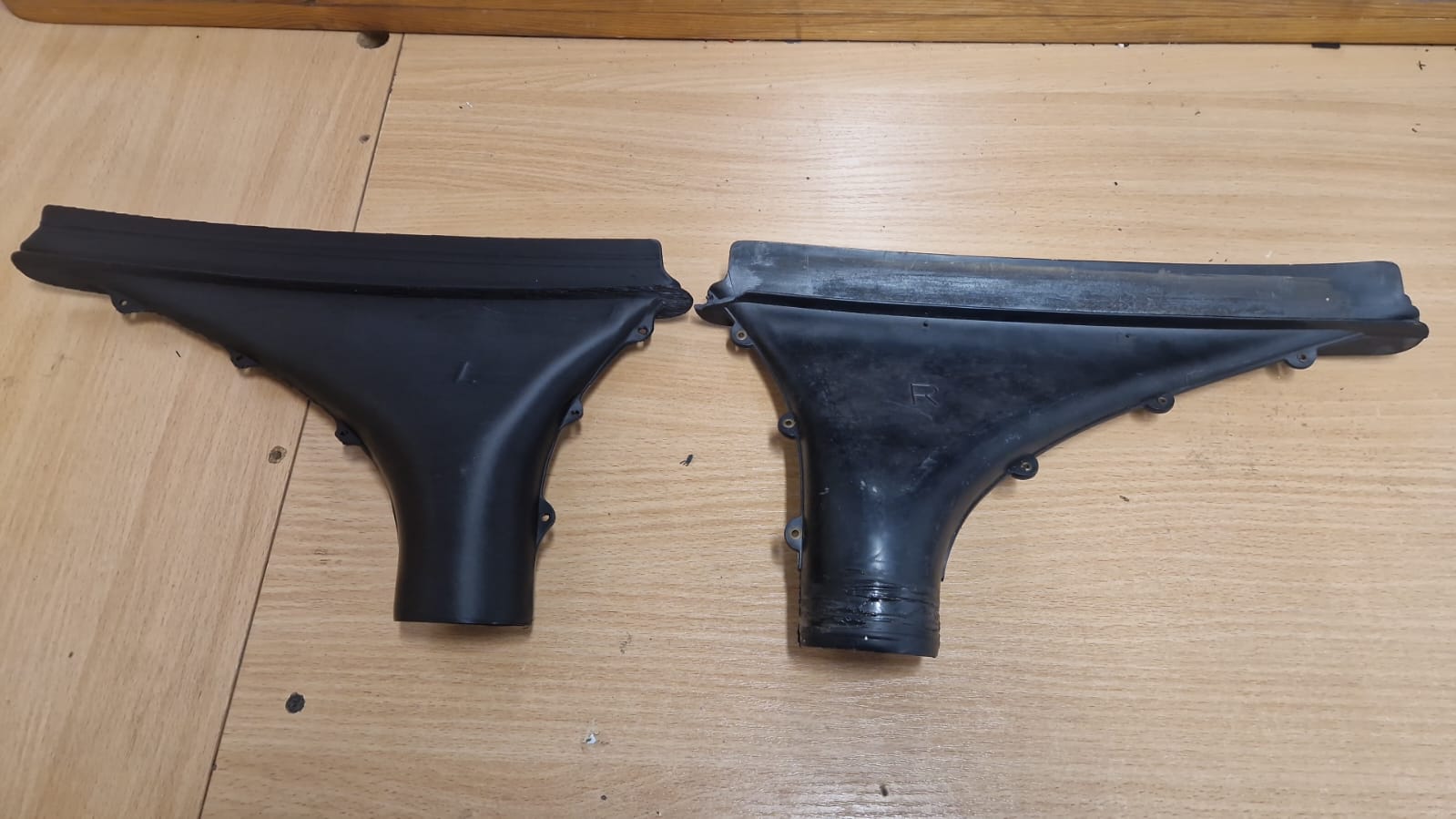

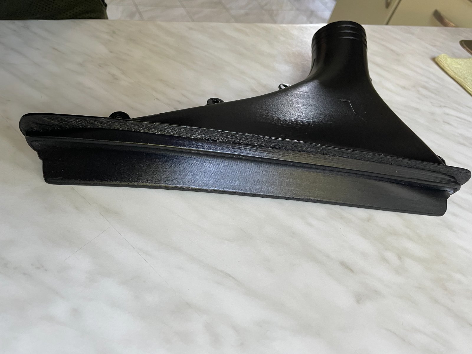

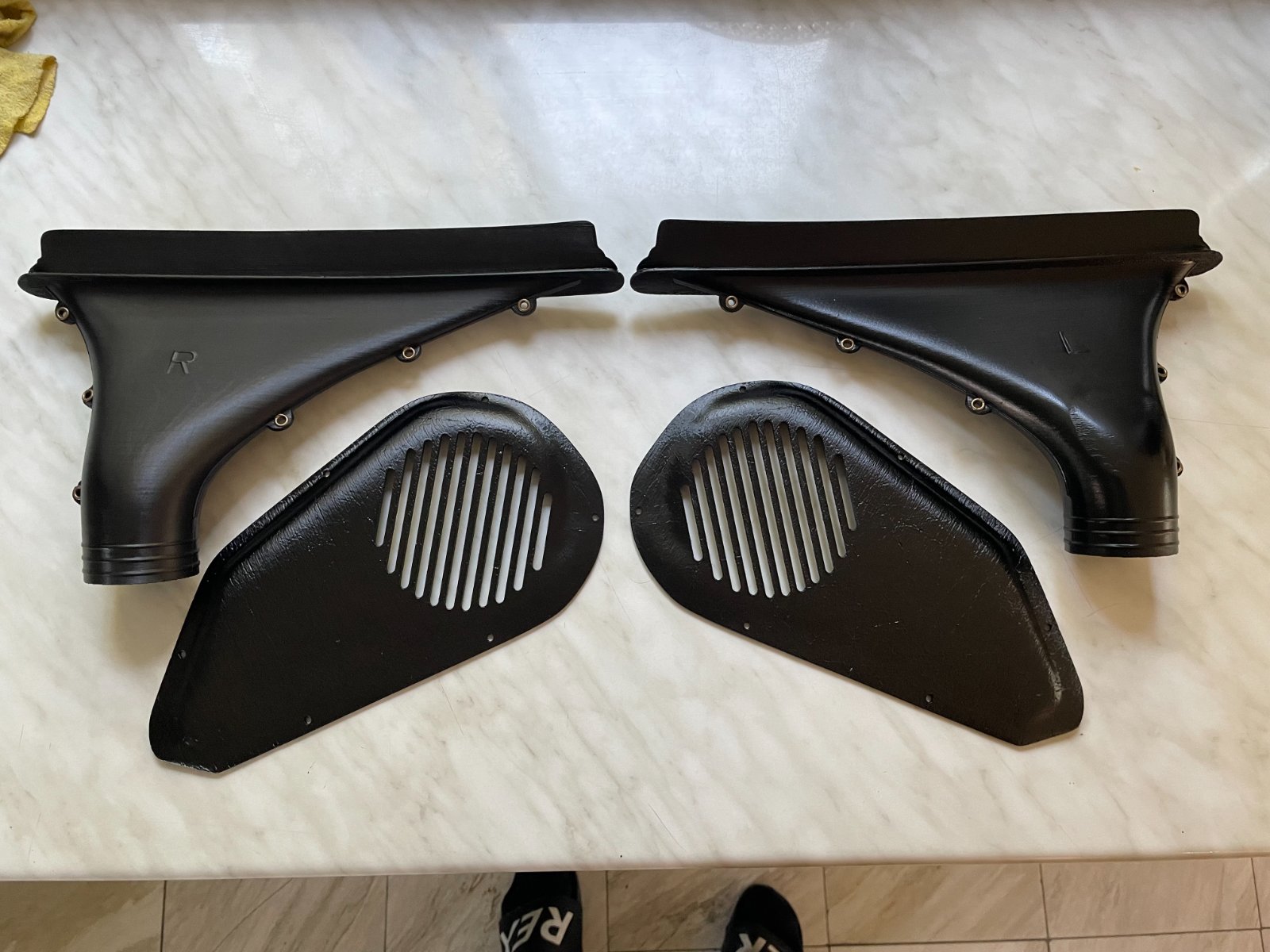

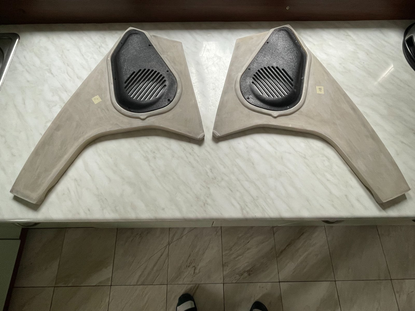

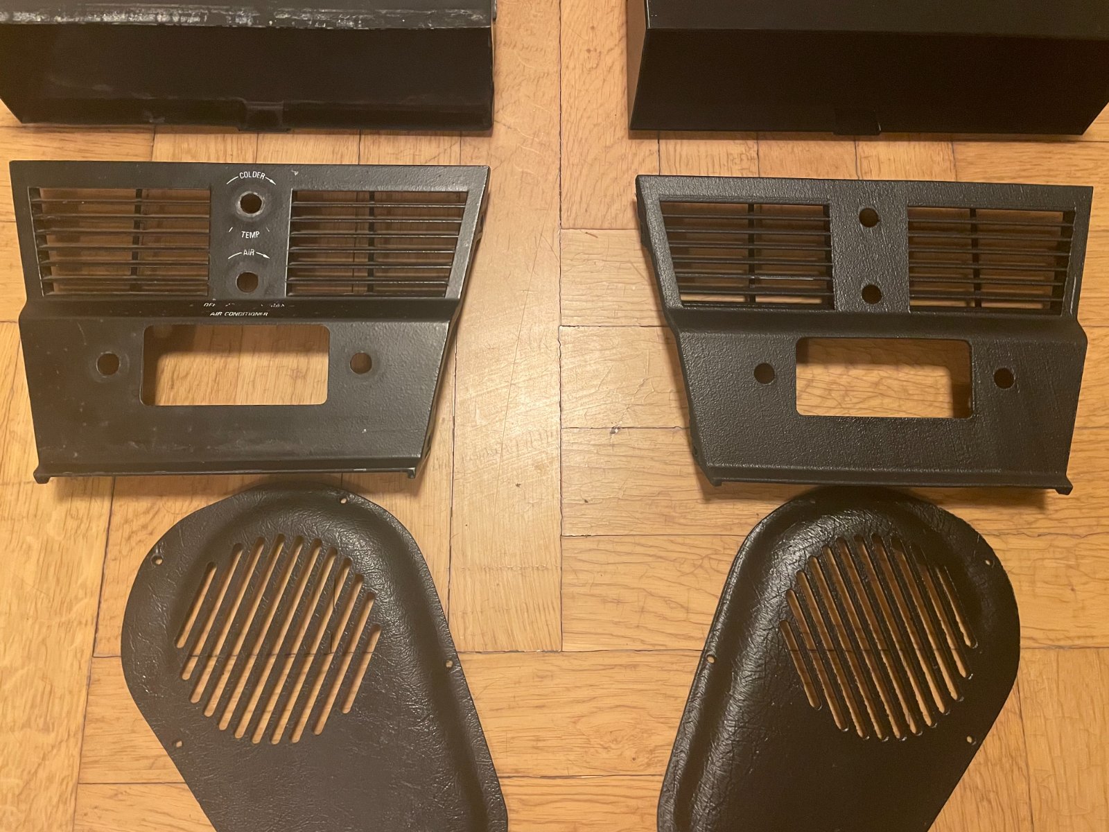

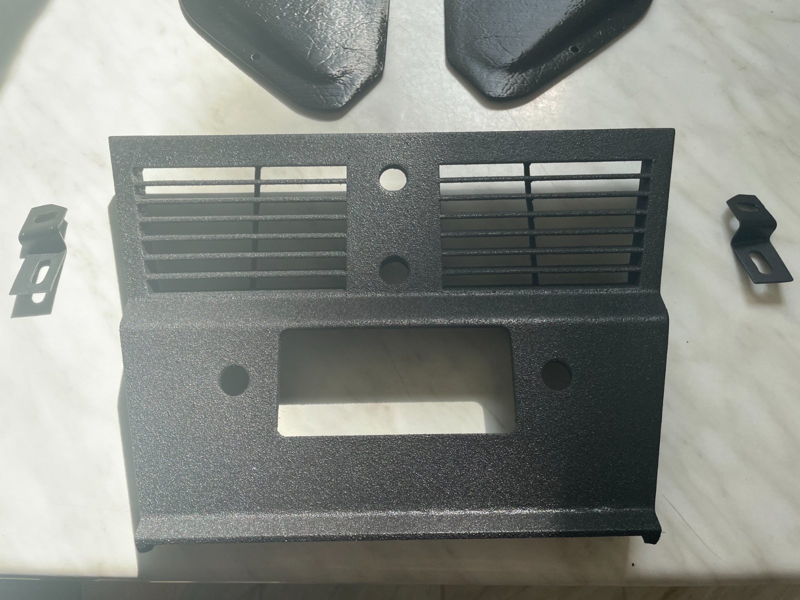

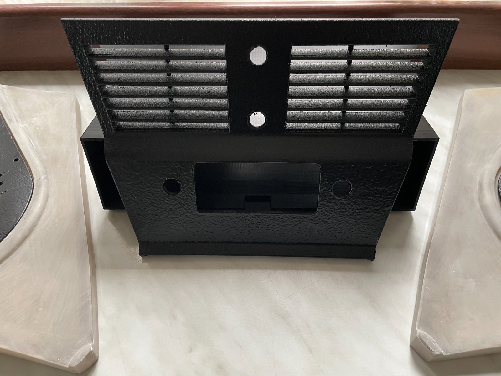

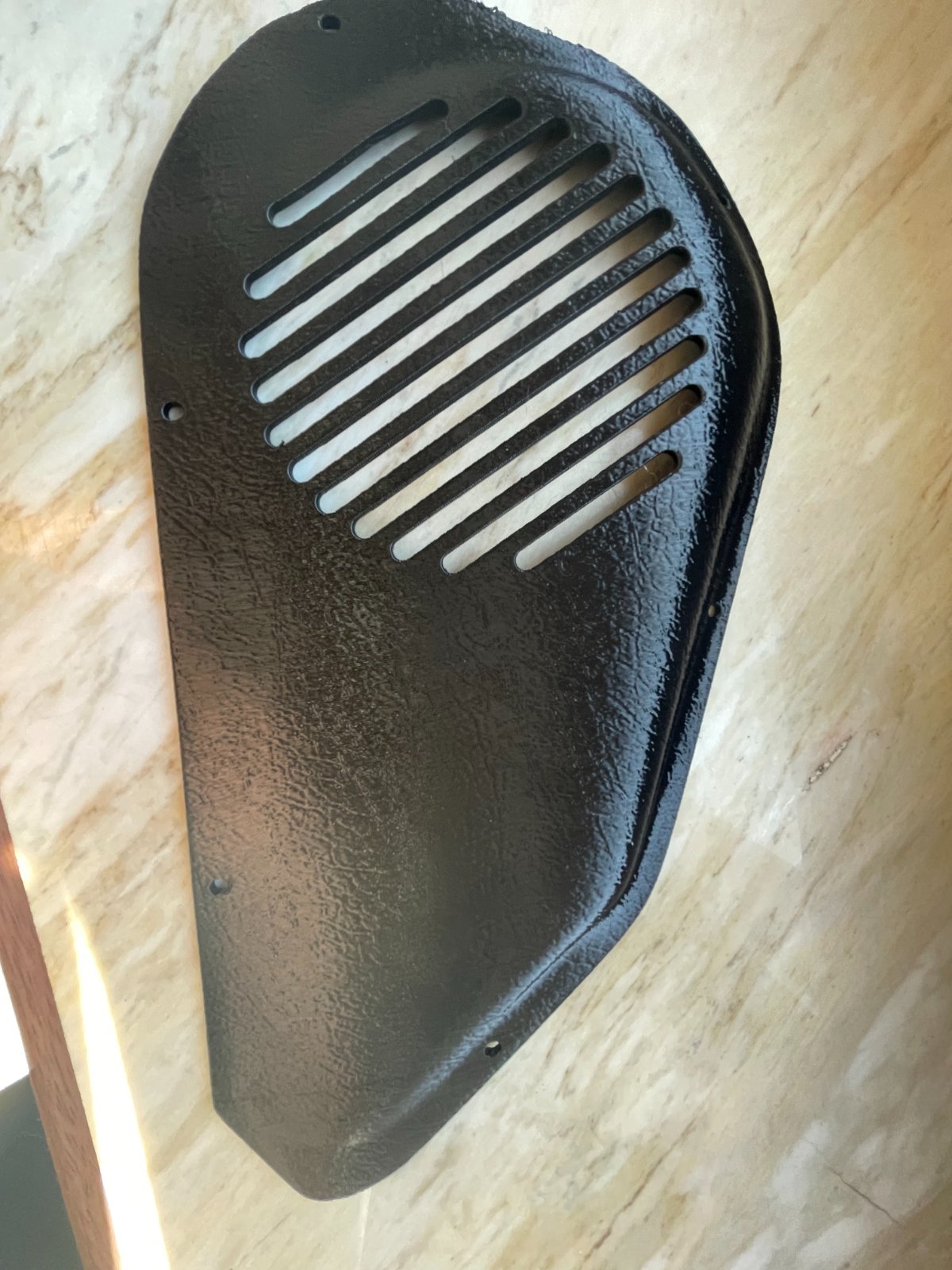

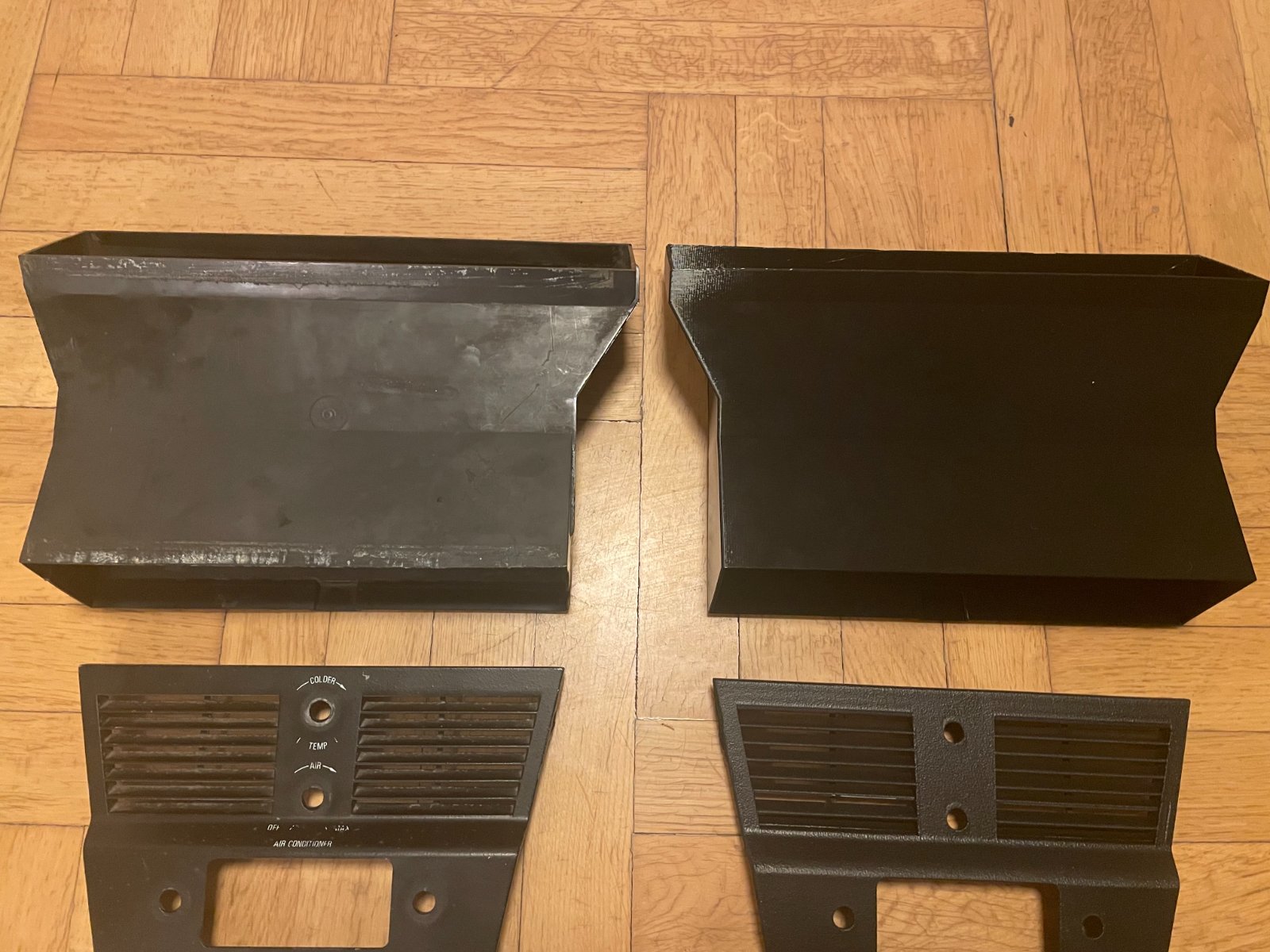

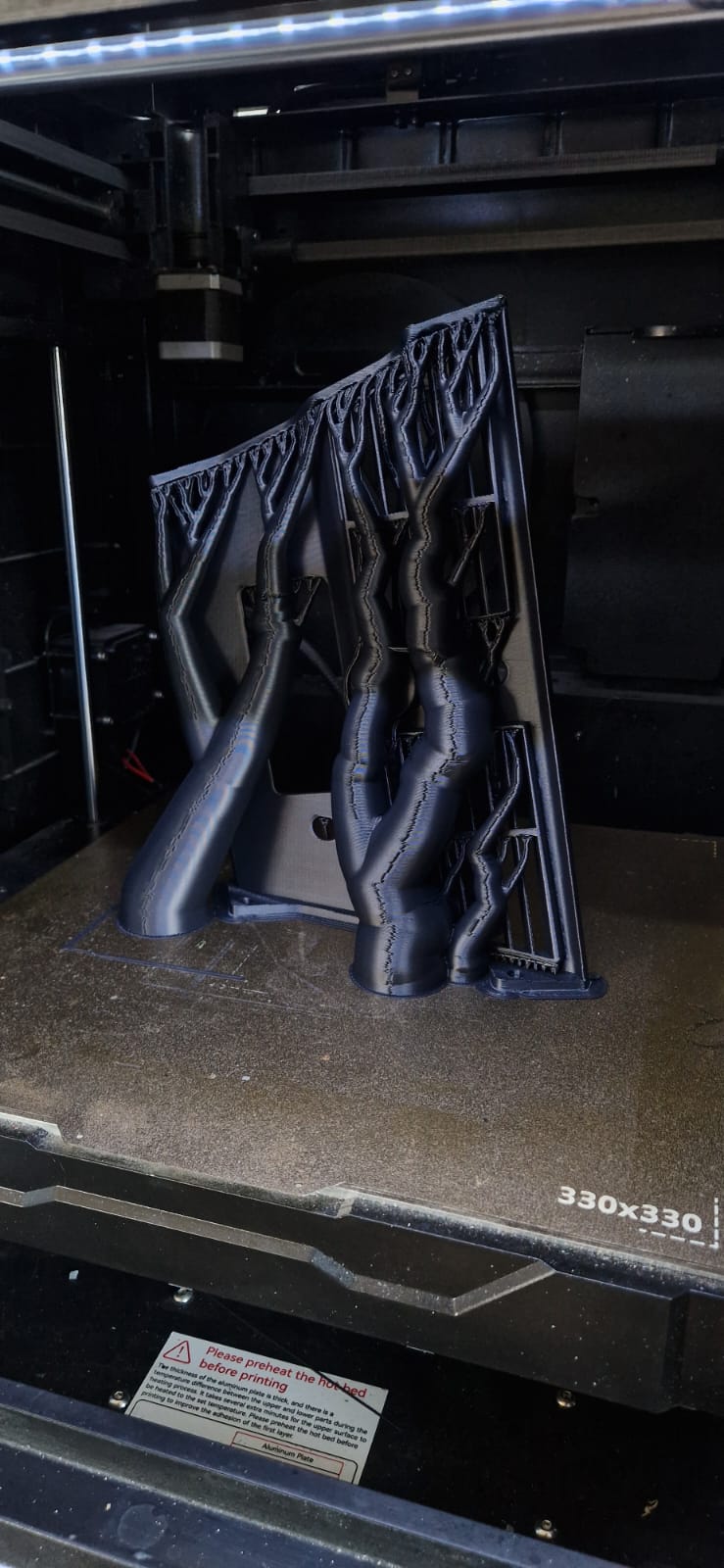

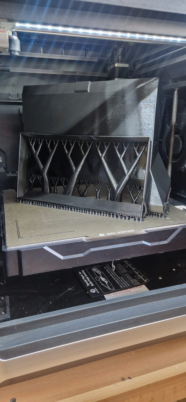

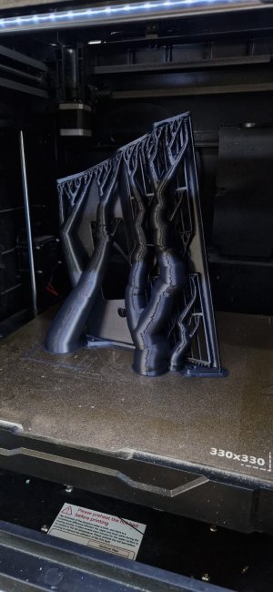

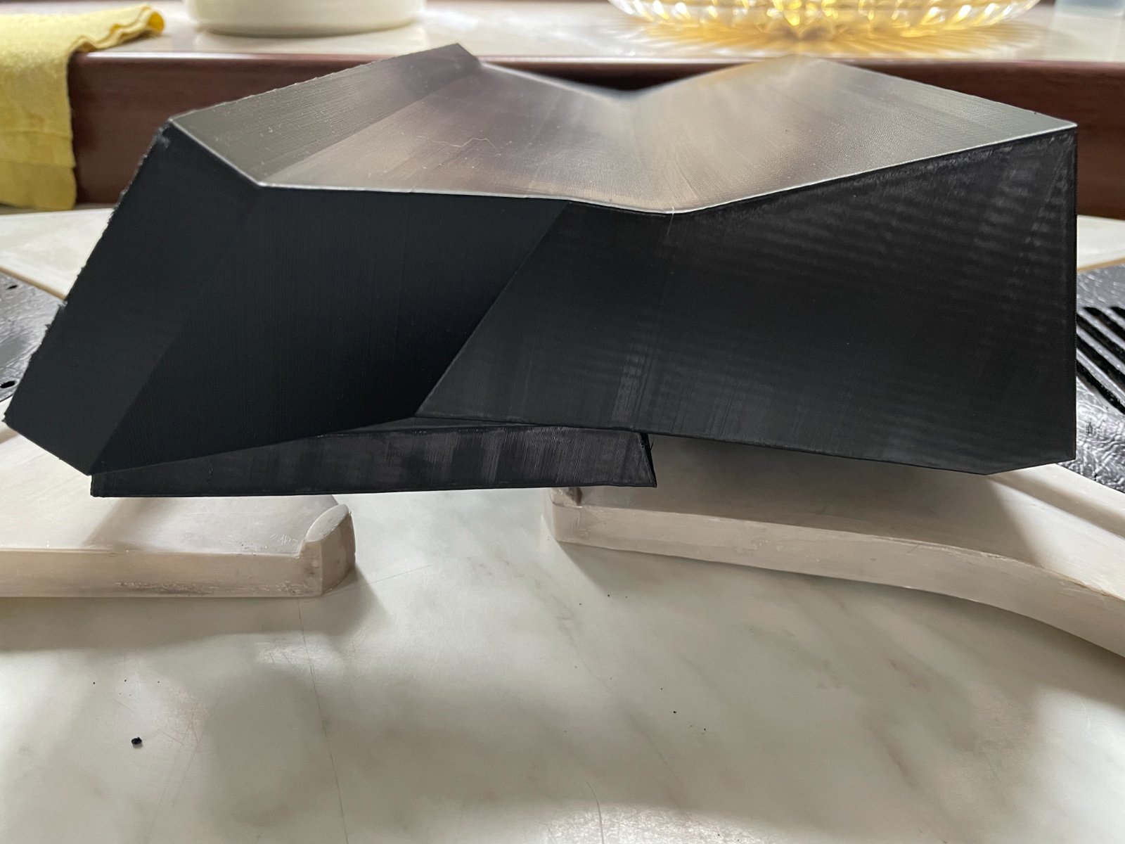

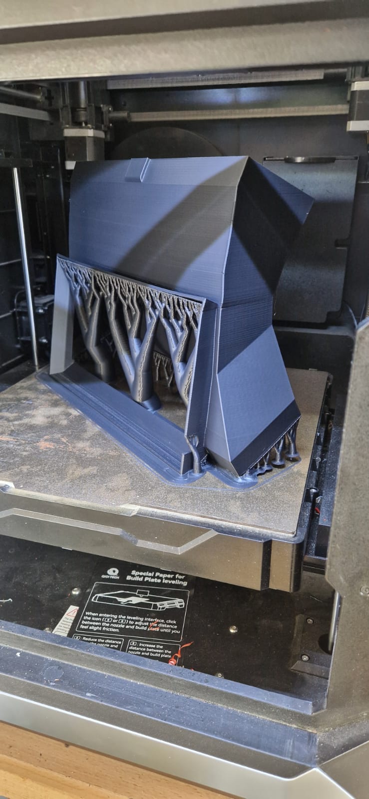

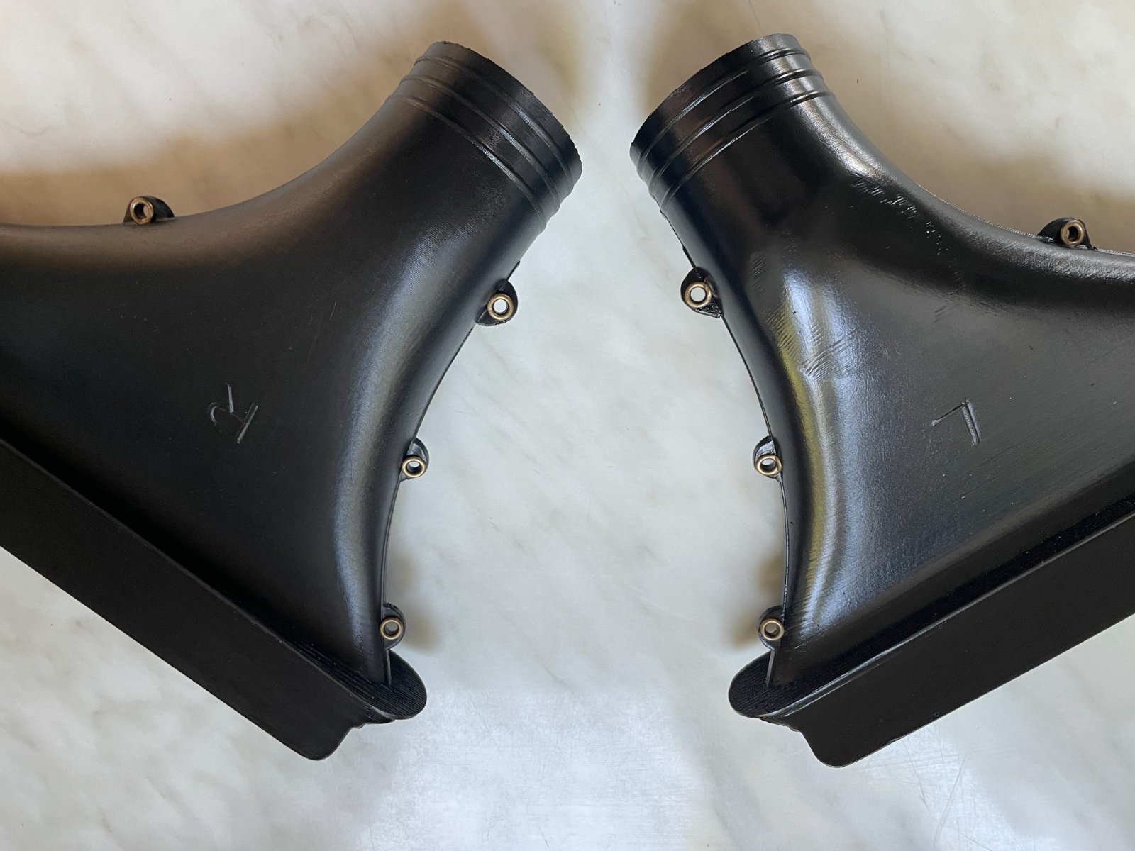

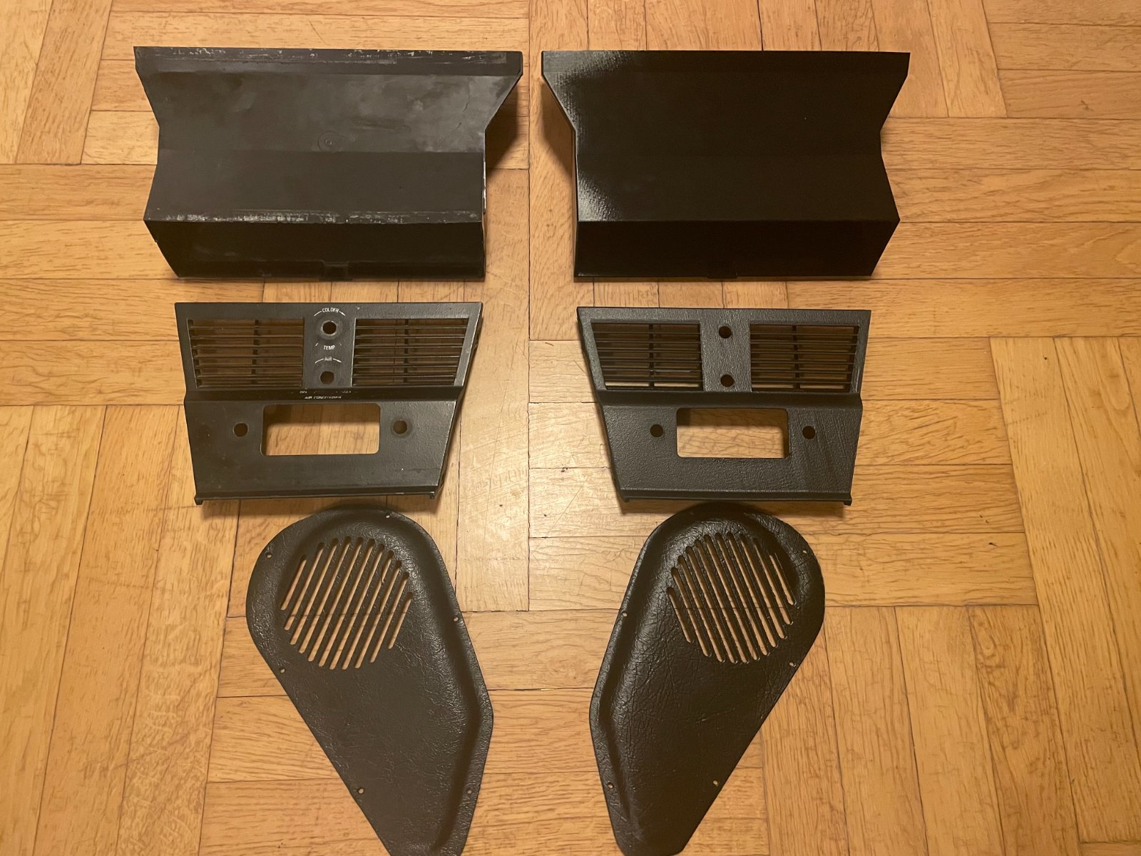

Hello, dear E9 forum community.
I'm almost at the finish line. A few minor corrections and the end result should be satisfactory.
In a few days I will also have the windshield defrosters ready.
They are in the process of printing.
Unfortunately, it took a while and I had to make a lot of test prints because I wanted the highest quality.
Contrary to appearances, these are not easy elements to print.
An alternative is SLS printing, but it is still very expensive and probably no one will want to pay that much...
I think this quality is quite satisfactory.
I still have a few corrections planned and I will be testing them over the next few days.
I would also like to thank several users of this forum for their invaluable help in designing these elements.
Left side original, right side print.
If there are any comments or ideas, please report them.

Very interested in the side AC vents Sir... and curious to see the defroster vents as well.
Nice job!
Wow! really nice.

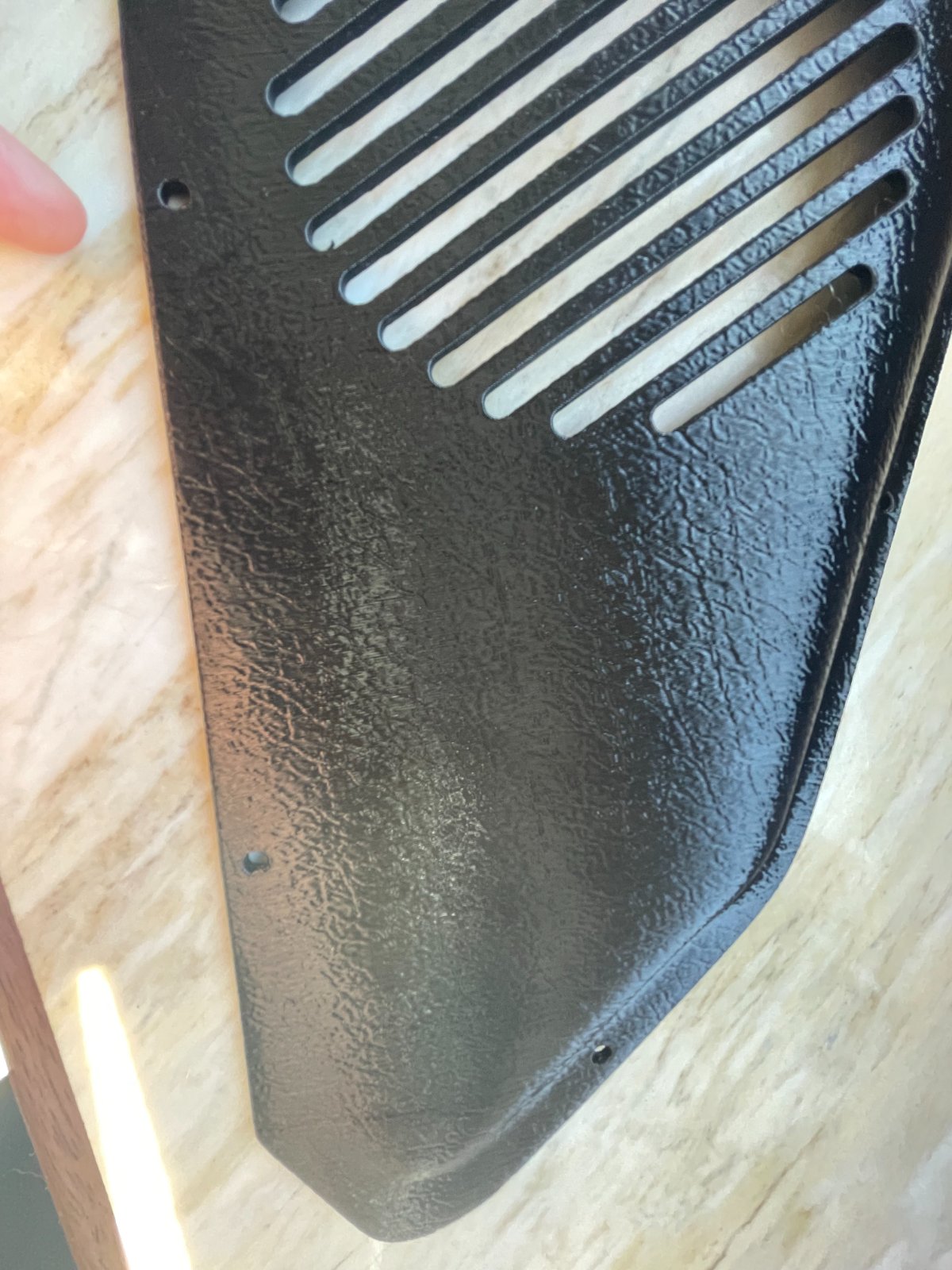

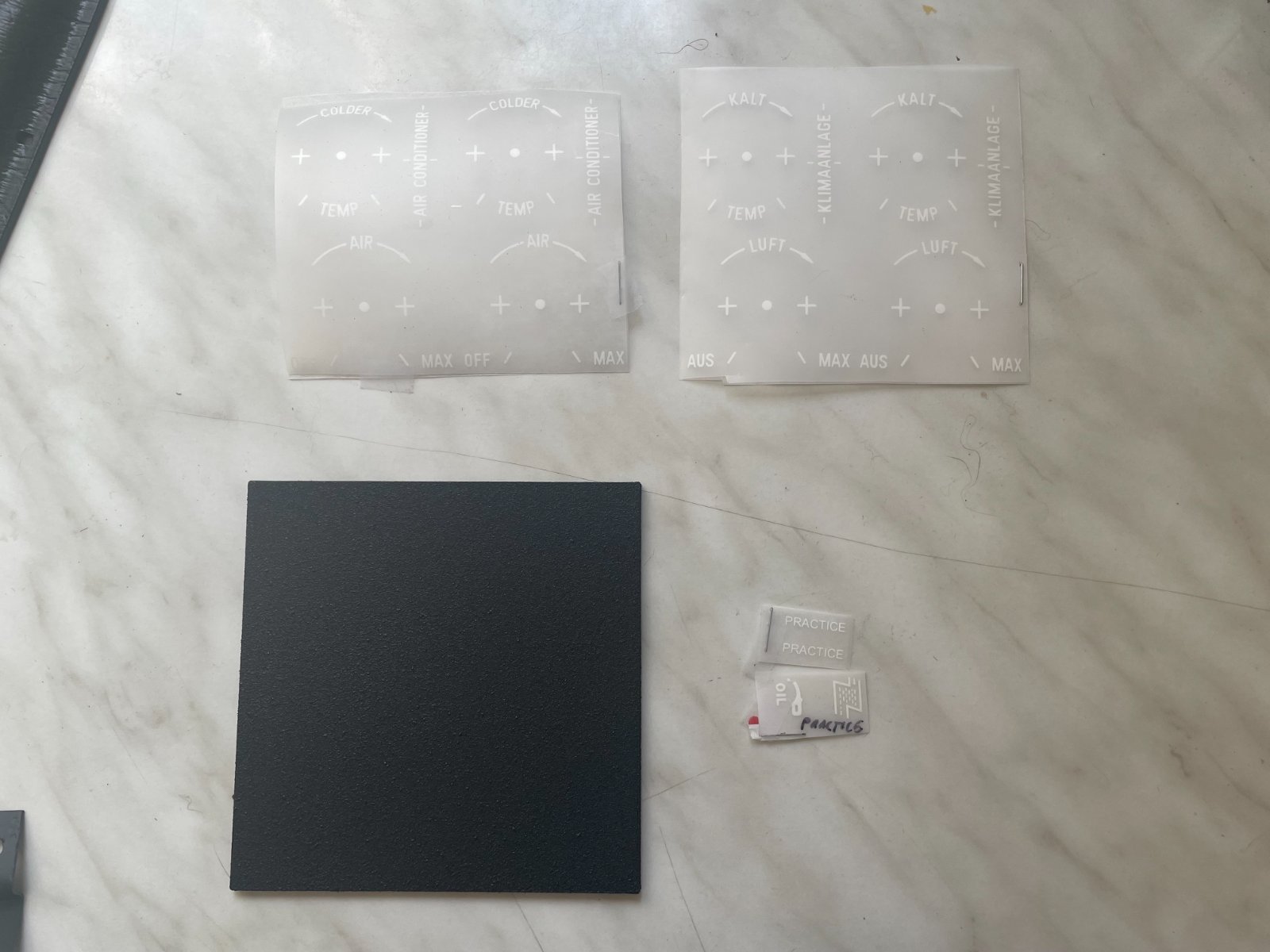

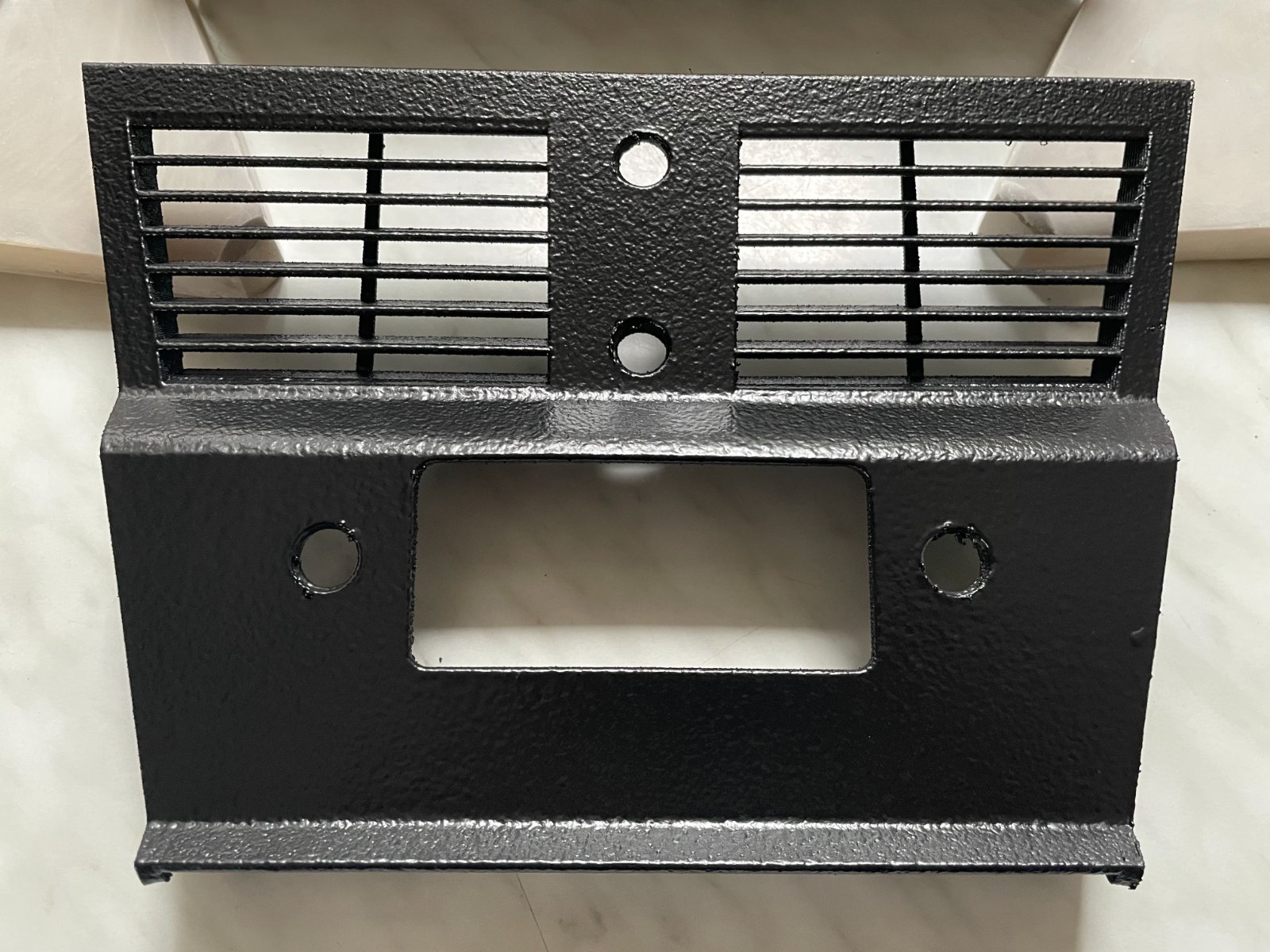

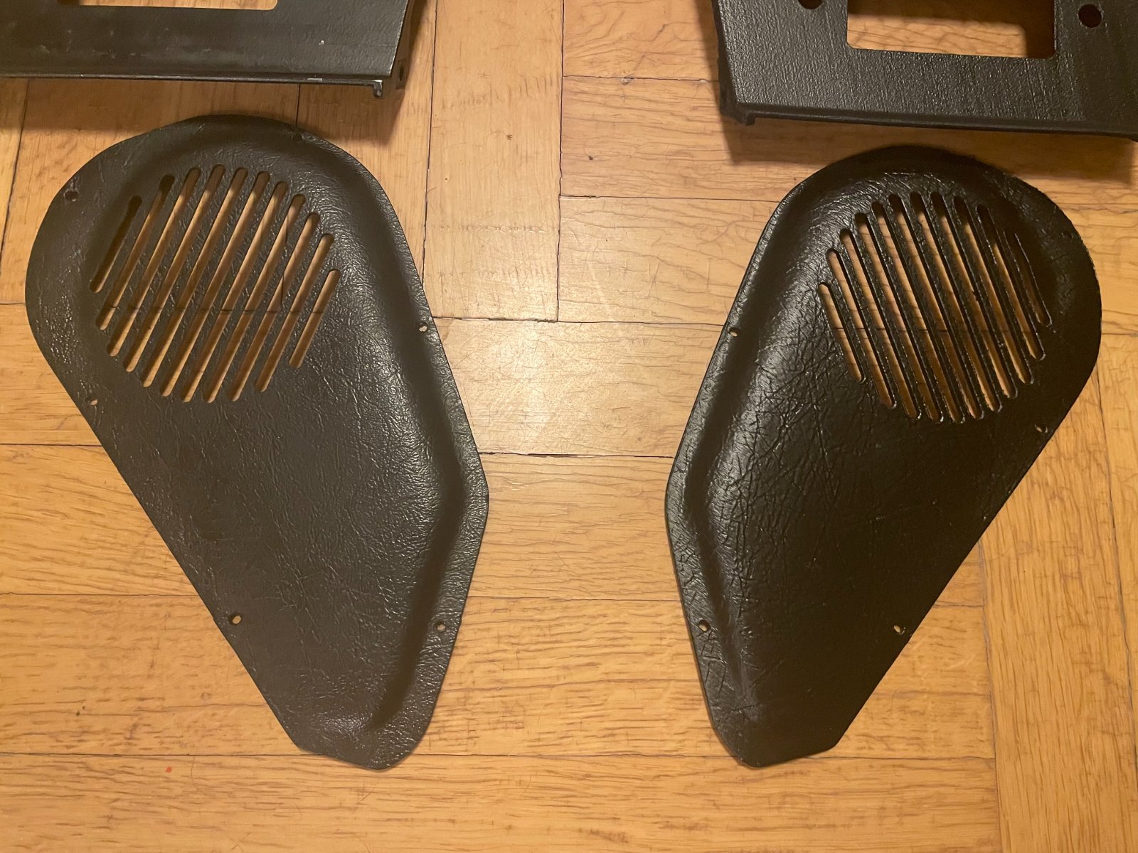

I see you also printed the texture on the side console vent; how did you get that into the model? It's sooo realistic.

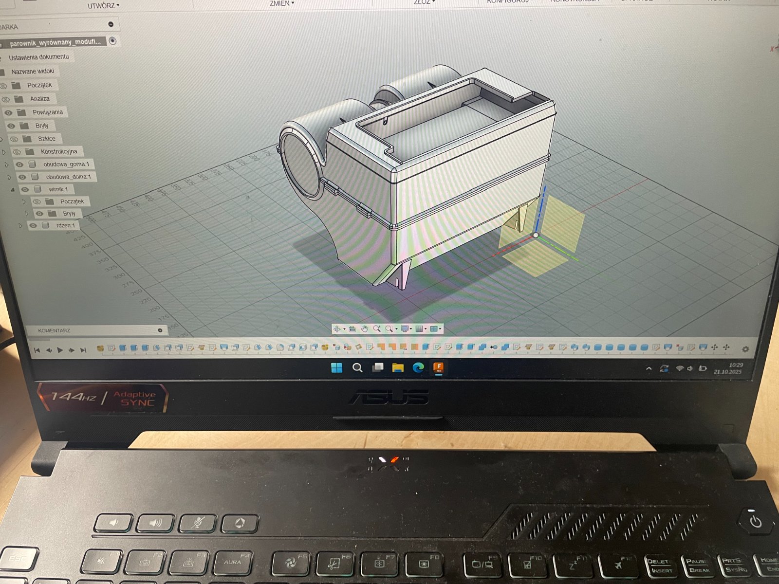

What modelling software do you use?
Thank you, gentlemen, for your kind words.
The defrosters should be ready on Friday/Saturday, and when it comes to the program that helped apply the texture, it is Blender.
Applying this elephant skin texture to the side panel of the AC system was a challenge.
A lot of test prints and testing various printer settings.
We are still working on improving the quality of the AC front panel.
We want to obtain the smoothest possible surface before applying structural paint.
I think we'll have the final version without visible layers next weekend.
The final version of the front panel will also have the control descriptions as in the original.

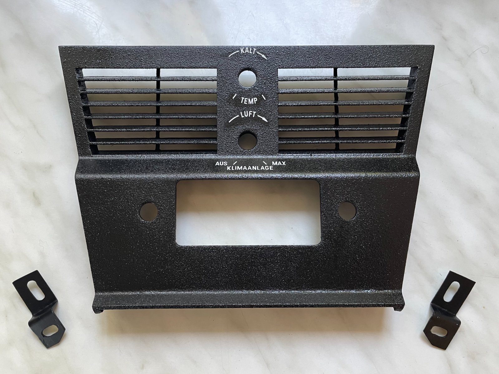

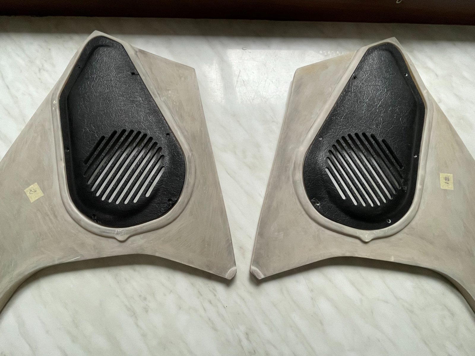

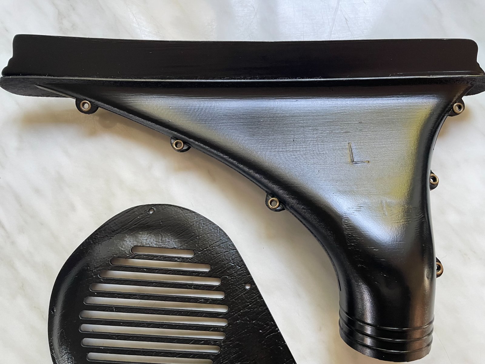

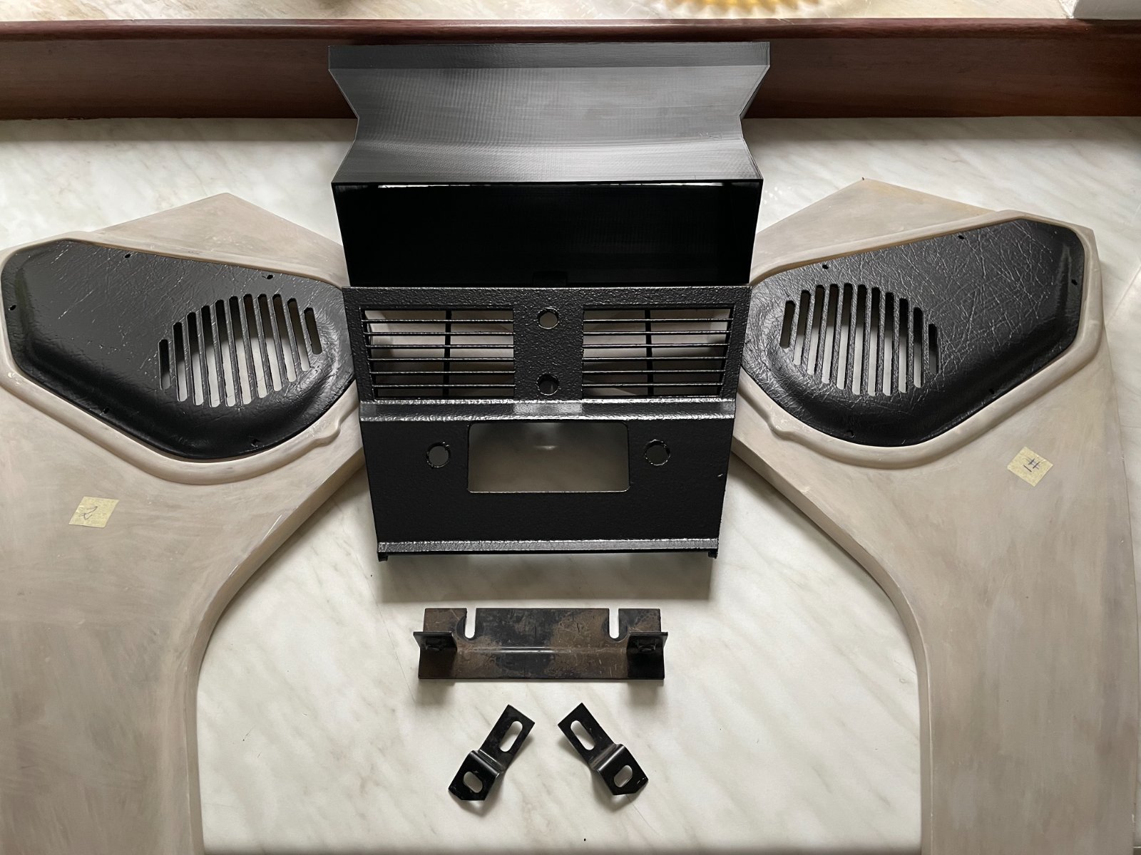

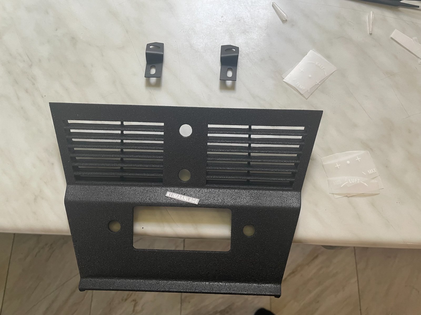

Hello forum users.
We were away for a while but we were busy working on a few details and checking the fit of individual elements on the car that is being assembled.
We wanted to make sure that everything fits.
When designing the central air conditioning panel, we used the forum thread of user Markos and made a few small modifications to our panel, which were discussed in the thread below regarding 3D printing.
We can make the panel without these modifications or with them.
We can also make two different structures on the central panel.
More or less intensive.
On each panel, according to your wishes, there will be markings as in the original. You can choose a German or English version.
The side covers with imitation elephant skin texture are a perfect match for the replicas of the sides of the center console made by our forum member Alberto.

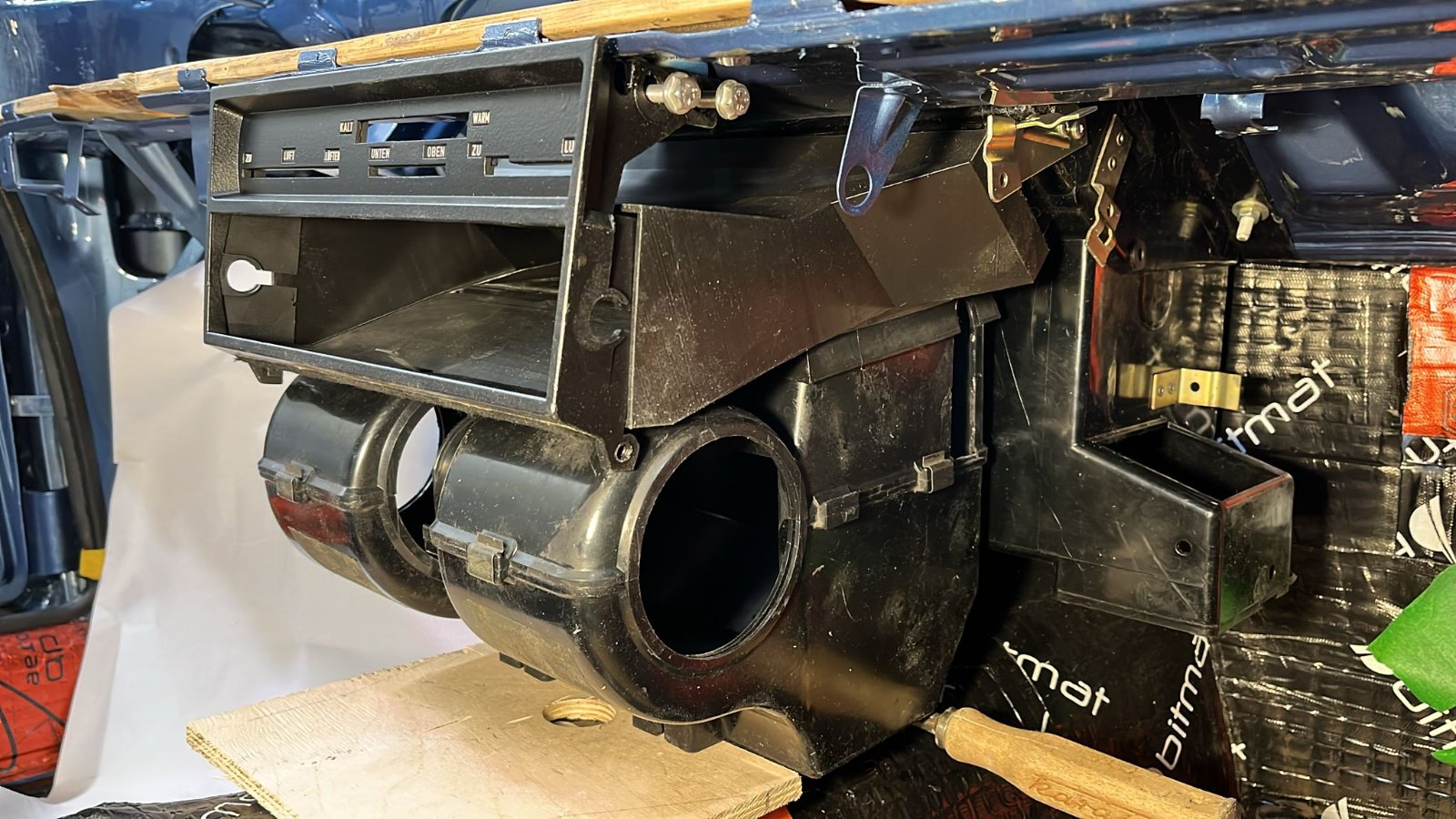

The replica of the air duct was installed in the car to check the correctness of the print. Contrary to appearances, this element is not easy to print because it consists of many surfaces set at the right angles.
The last element ready to date is the replica of the windshield defrosters.
We are currently working on several other elements.
Among others, an evaporator housing adapted to the modern core in order to improve the efficiency of the entire system.

this image looks very interesting - the idea of having side ducts for A/C. have you printed and tried to see if this would fit in the coupe?

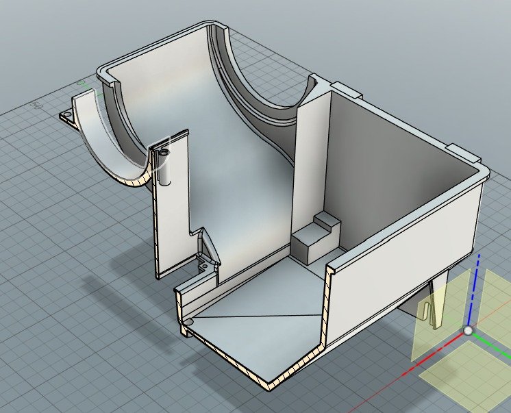

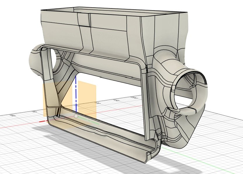

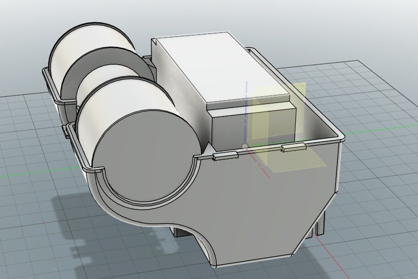

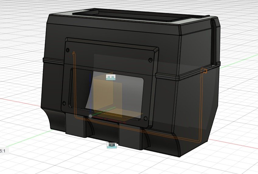

This is an interesting topic.
From my knowledge gained from E9 users, it appears that the efficiency of the air conditioning system leaves much to be desired, as does the cold air distribution system.
I once had an interesting chat on this subject with Mr. Don.
After his information and suggestions, we came up with the idea of modifying the evaporator air duct and adding appropriately profiled side outlets to it.
The final development of this idea is to modify the evaporator housing itself in order to adapt the modern evaporator core and integrate the air duct itself with the evaporator housing, adding side outlets at once.
Fortunately, we have access to several cars that will be restored or are currently being assembled.
Thanks to this, we can test the fit of individual elements and test possible modifications.
We will keep forum users updated on the progress of work on individual elements in this topic.
Suggestions, comments and constructive criticism are welcome.

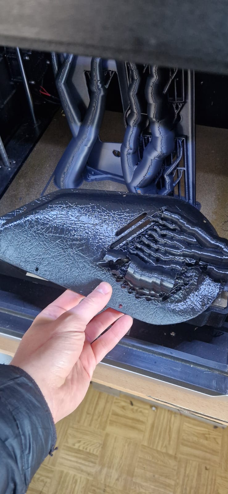

Hello forum users.
A few of the latest prints.
The process is constantly being improved. We assume that there is always something that can be improved or done better.
Transferring markings and graphics to the rough surface of the air conditioning panel is a big challenge...
We have made a few dozen test prints to ensure the repeatability of the printing process of individual elements.
Next week we will start the process of modifying the evaporator itself and adapting the modern core.
Any comments or suggestions are welcome.
Have a great weekend.

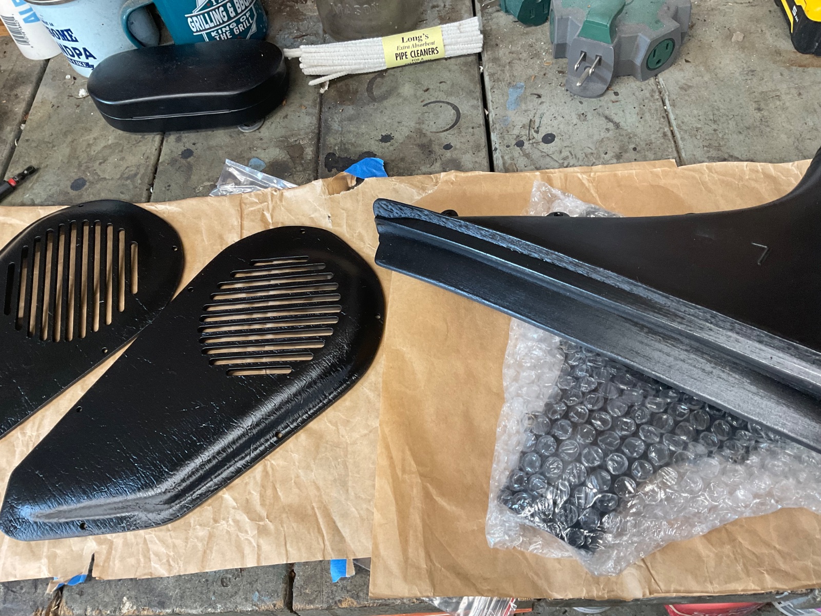

Received my parts from Lucas today
Nice quality, great price, great shipping…
Well done Sir!
Sorry about the messy tool bench for the picture

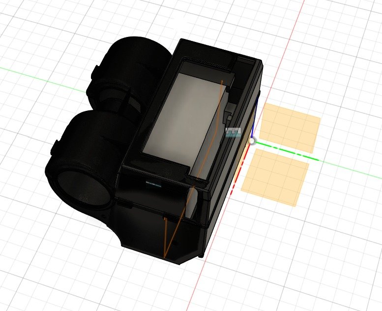

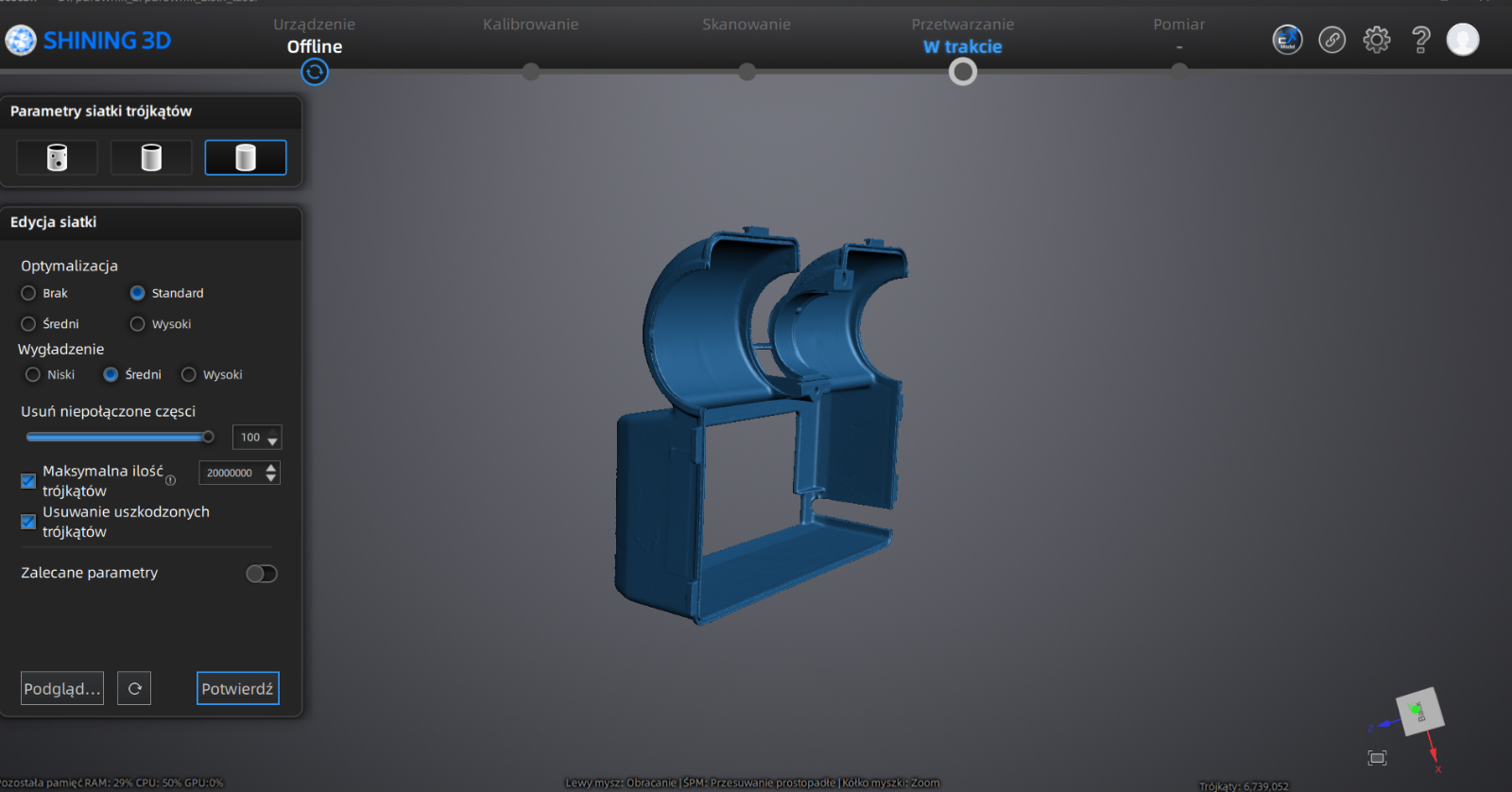

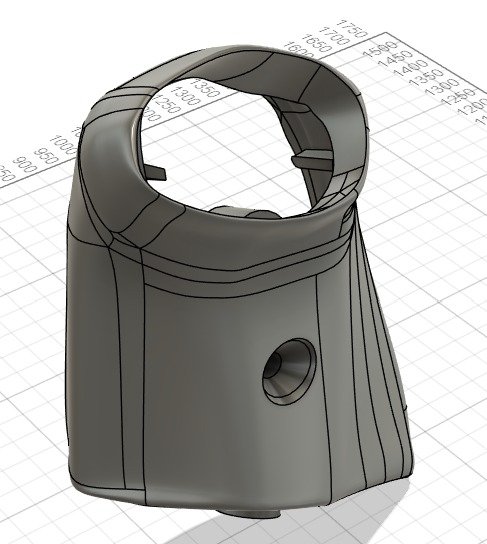

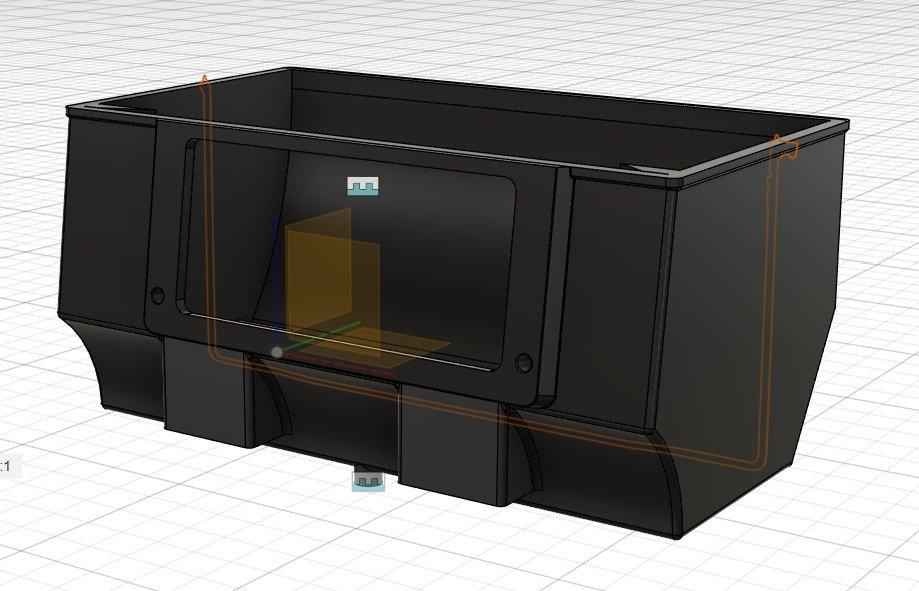

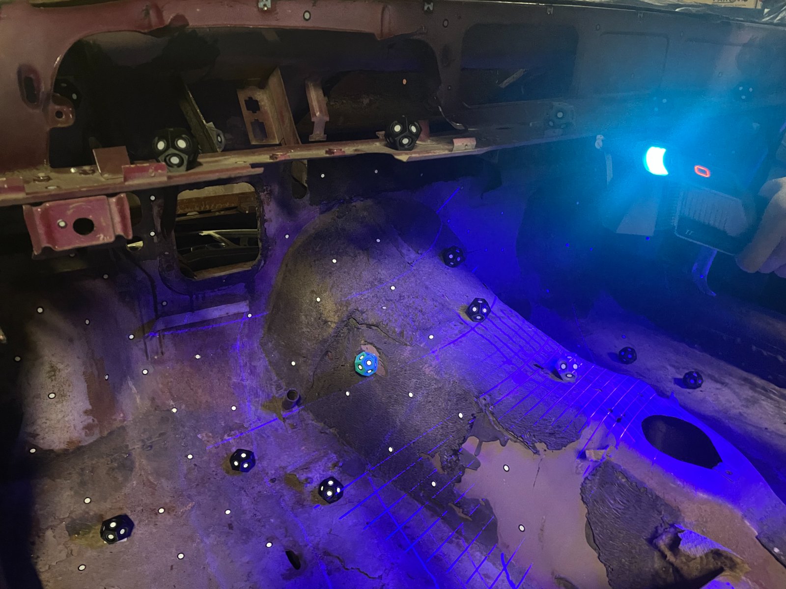

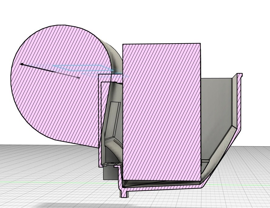

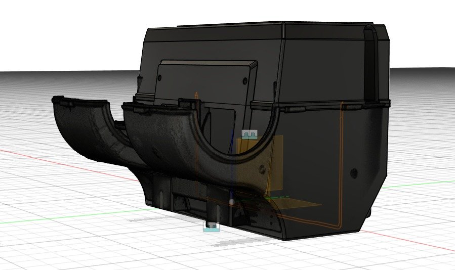

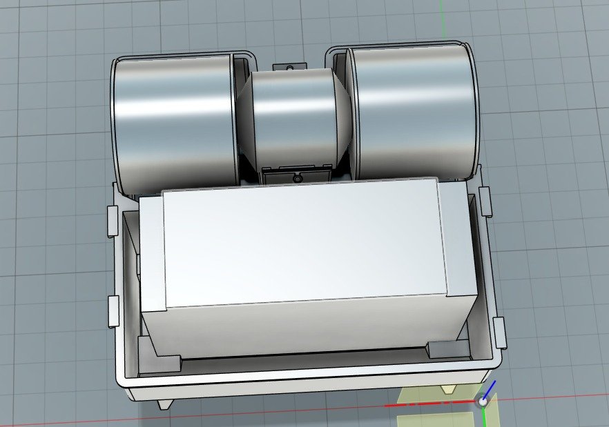

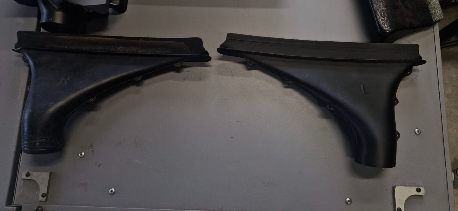

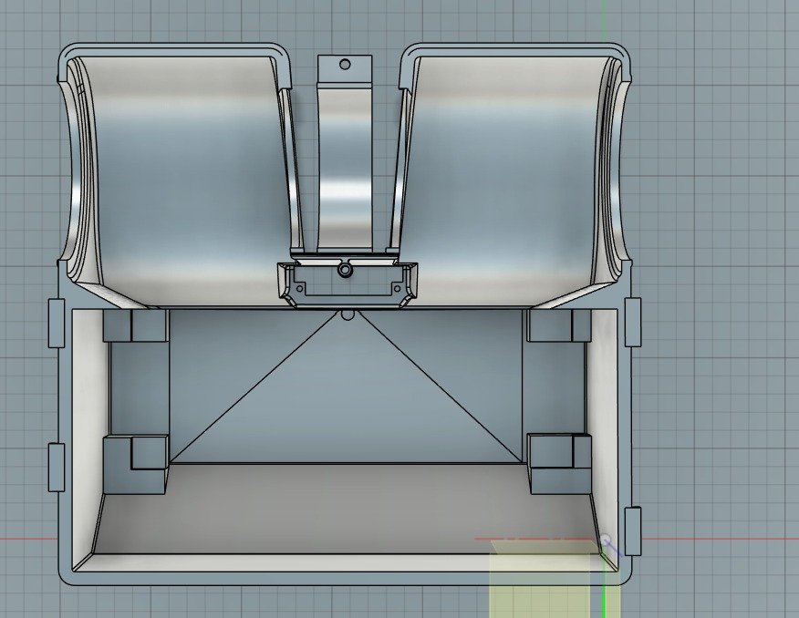

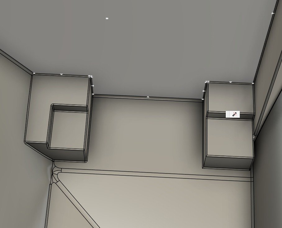

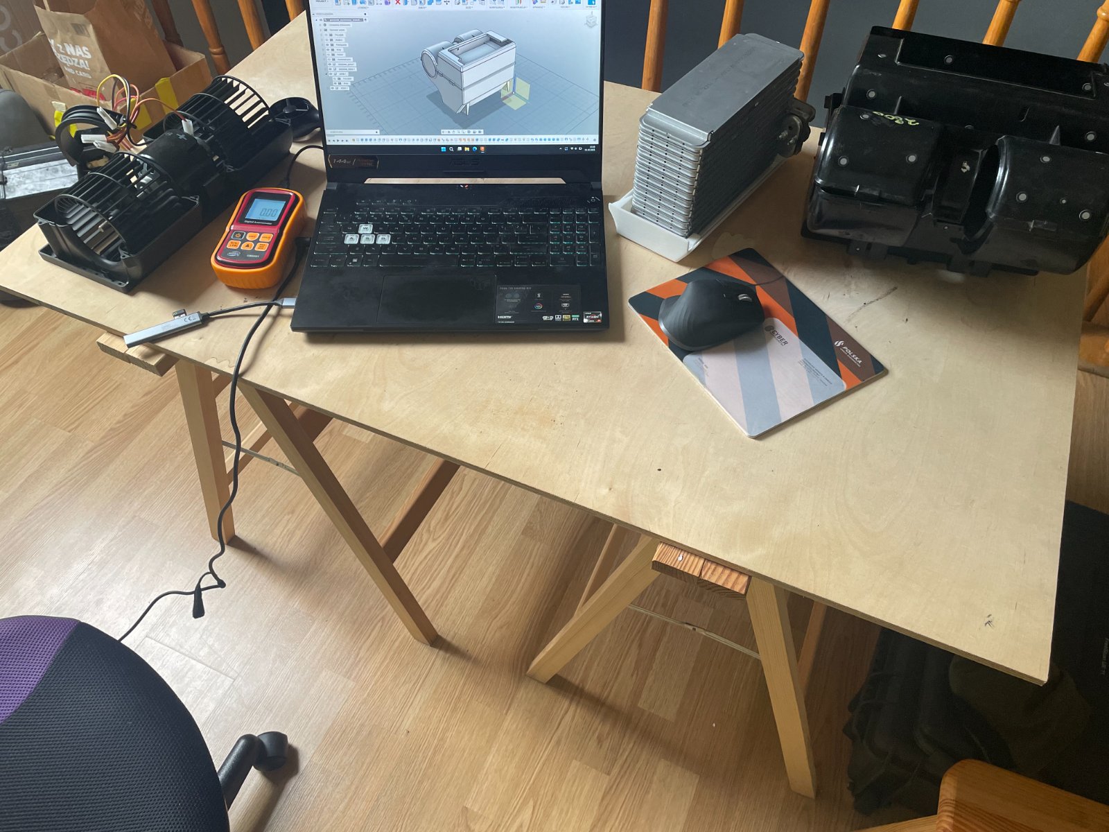

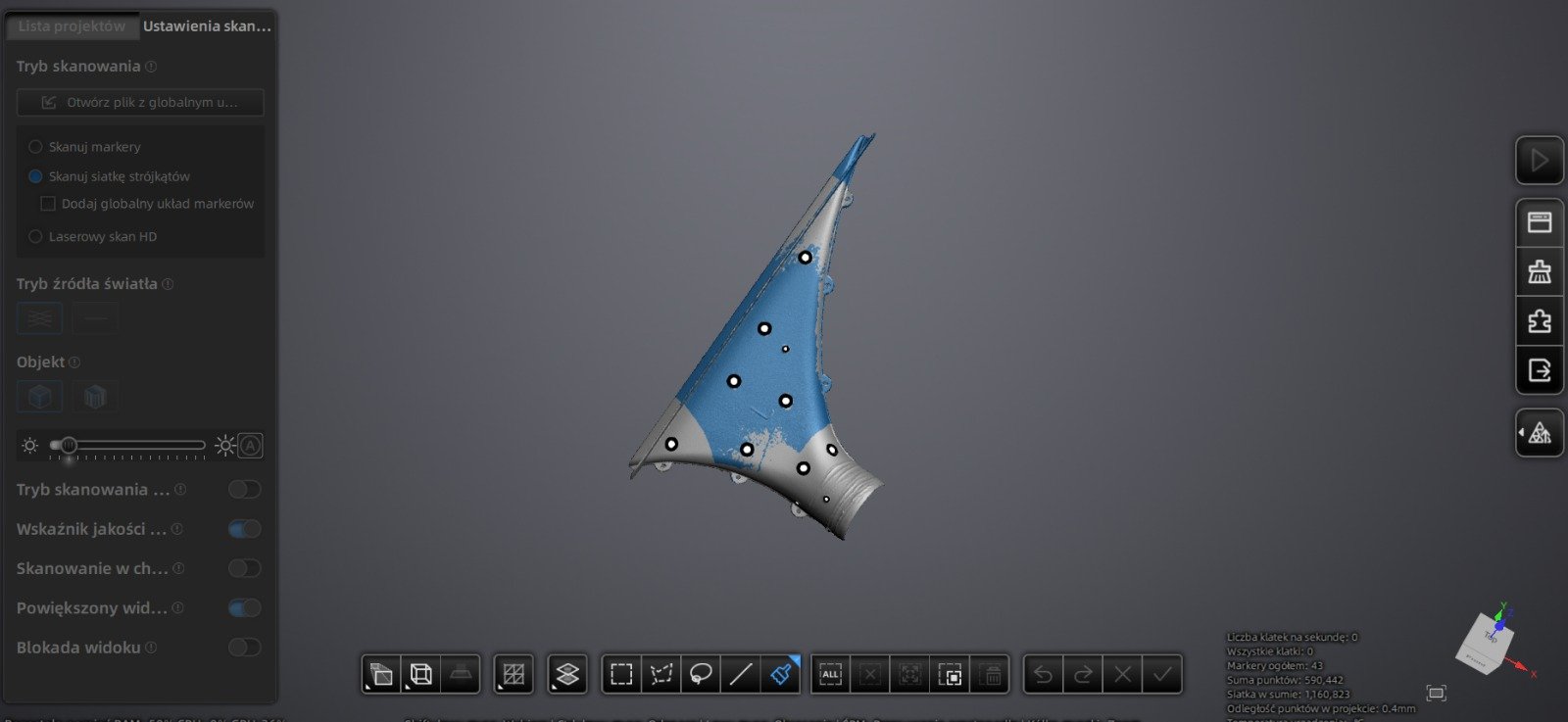

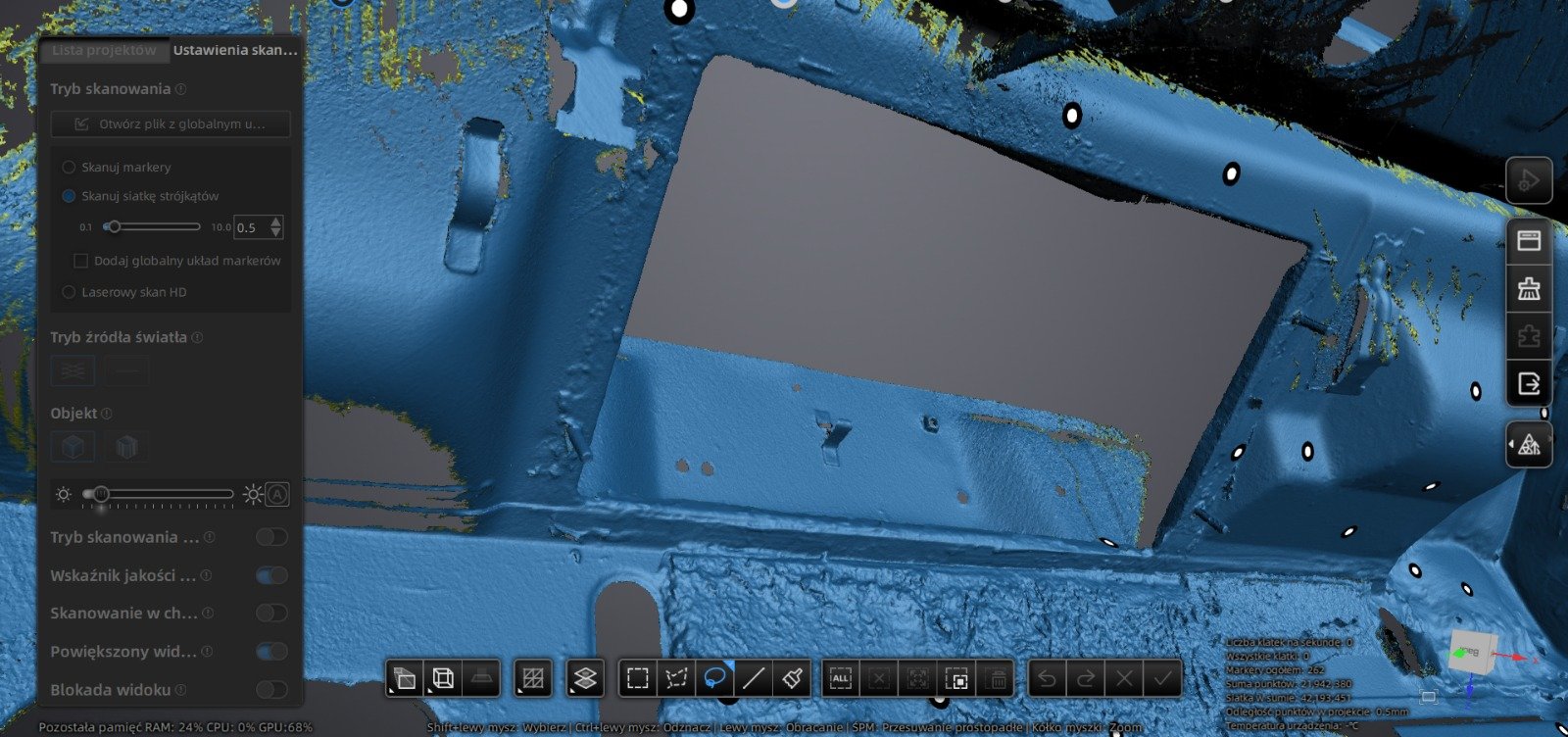

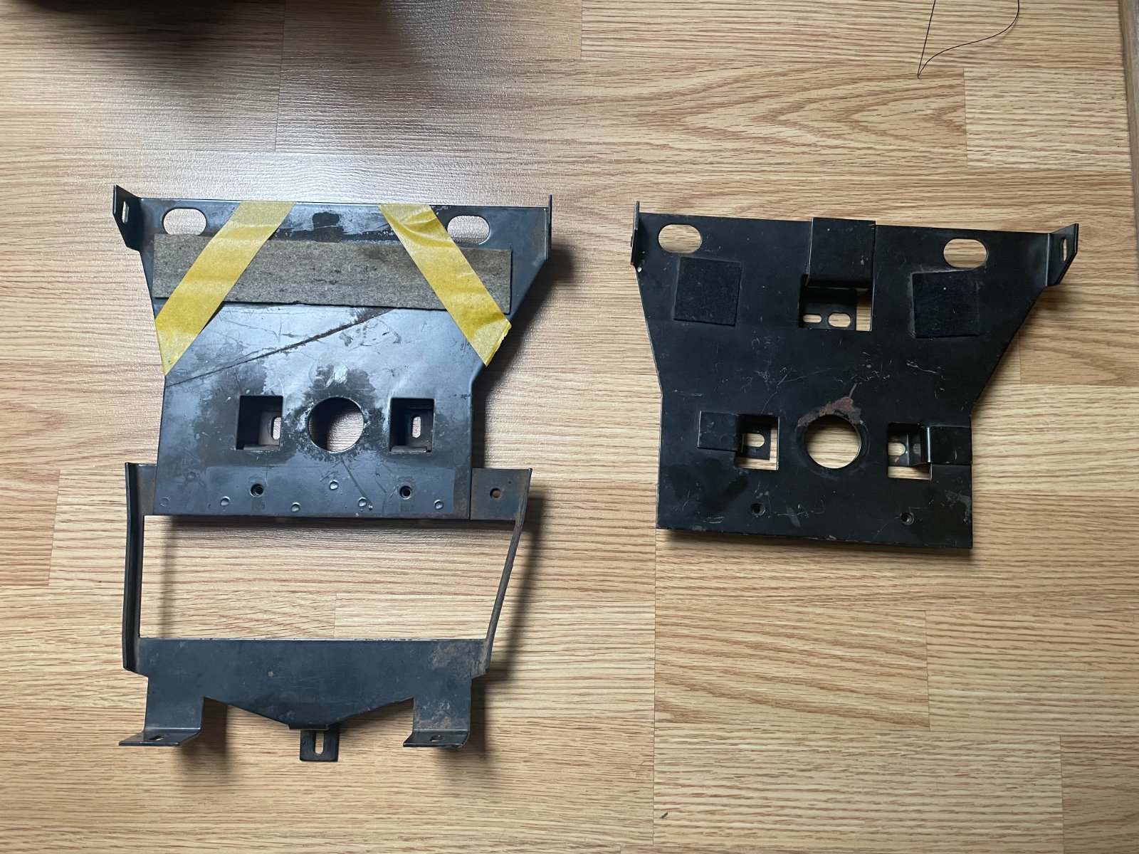

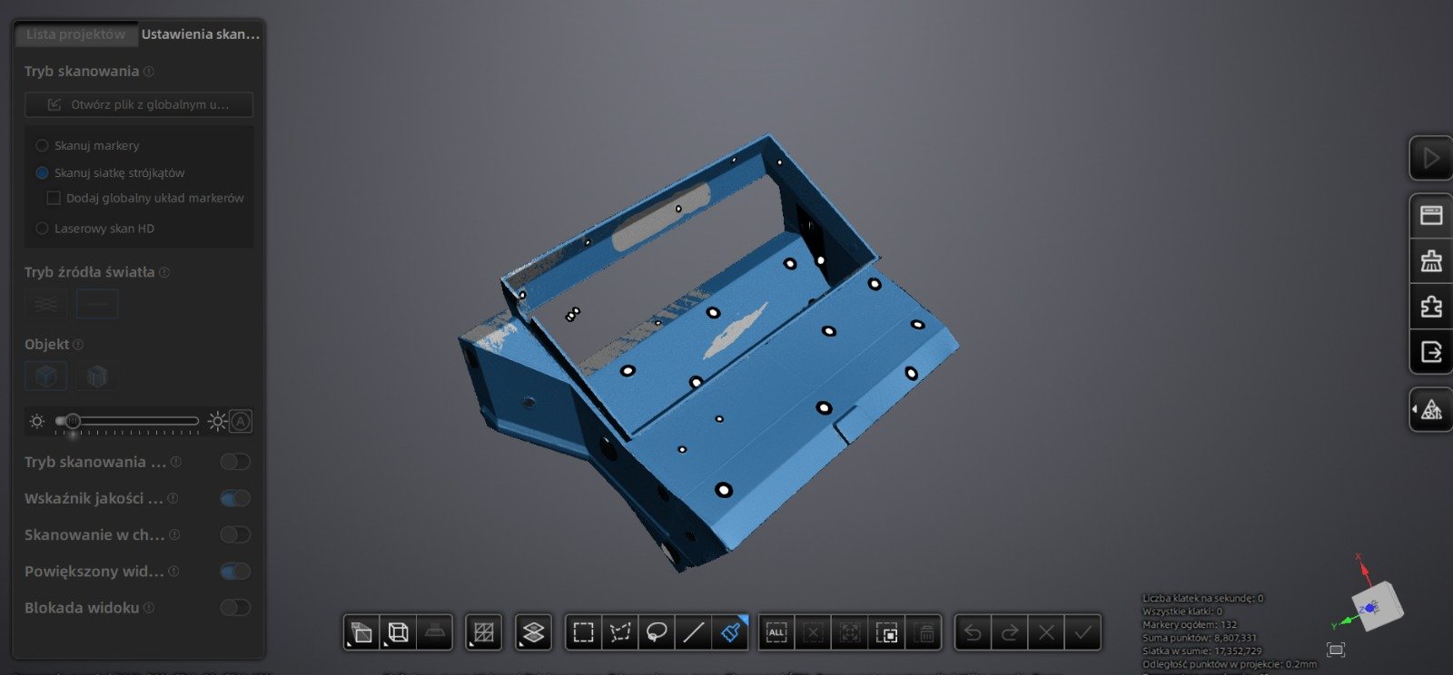

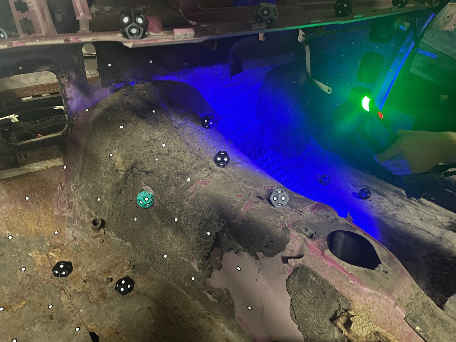

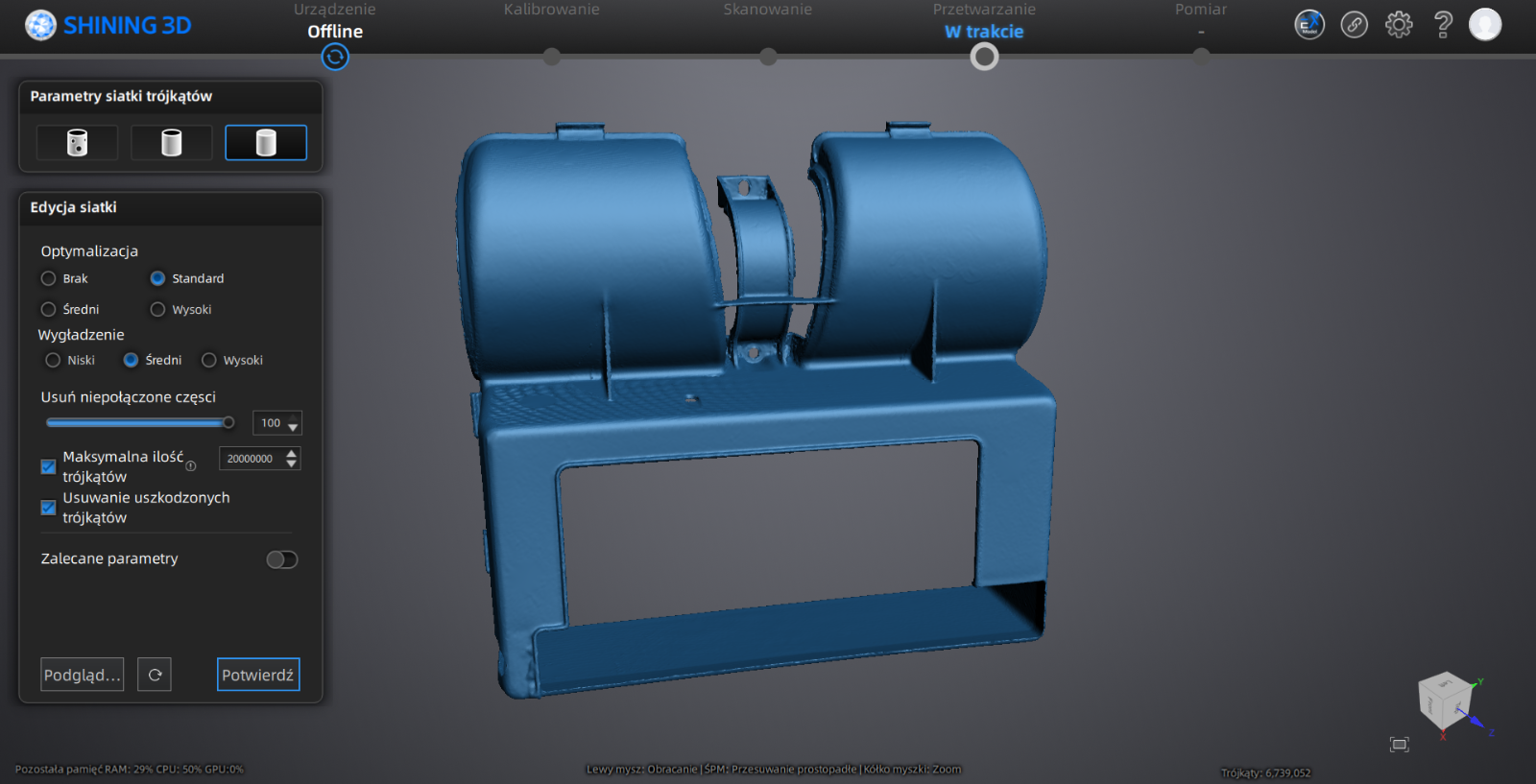

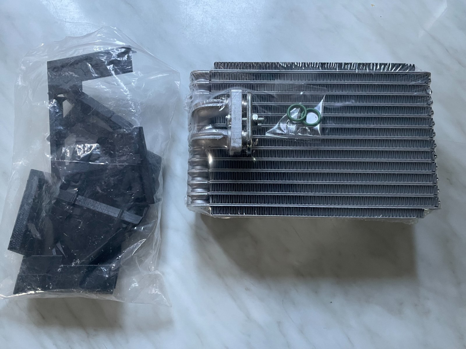

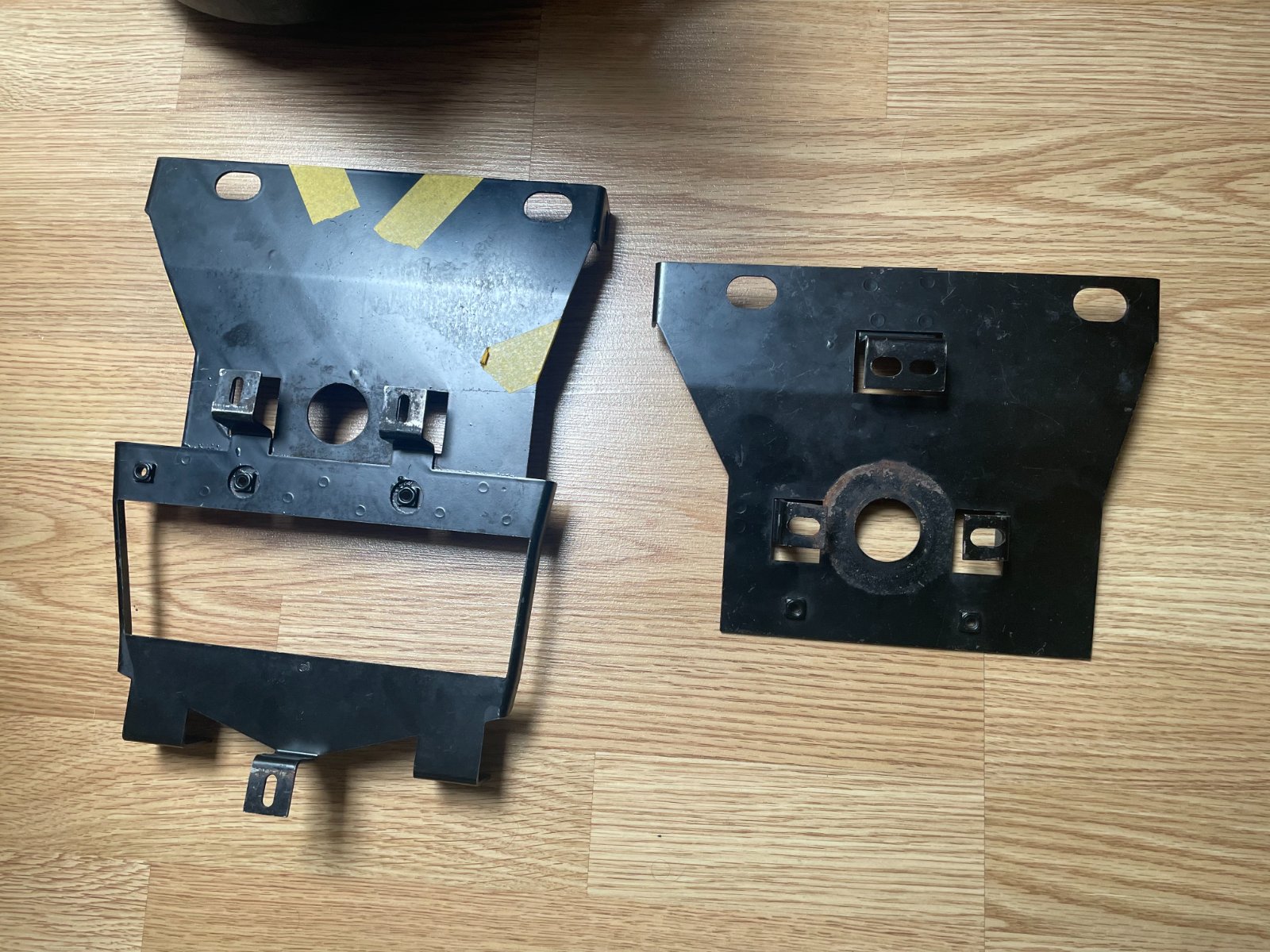

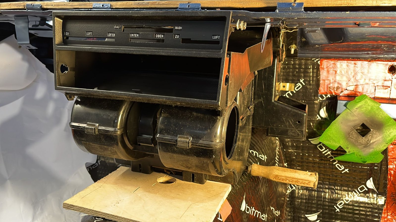

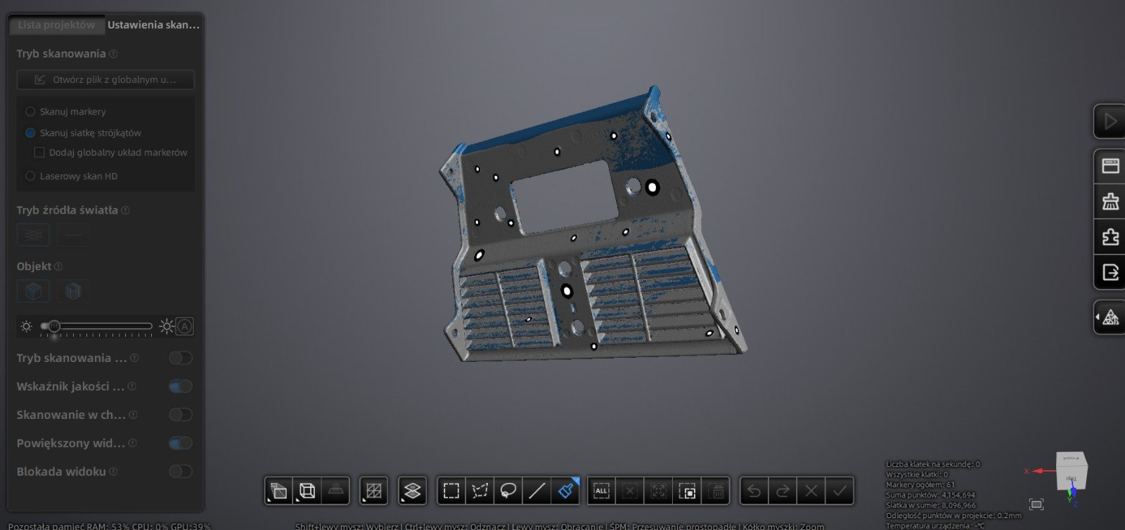

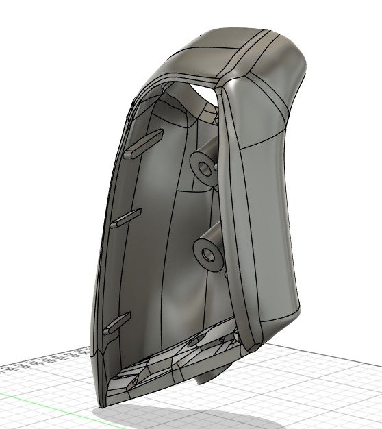

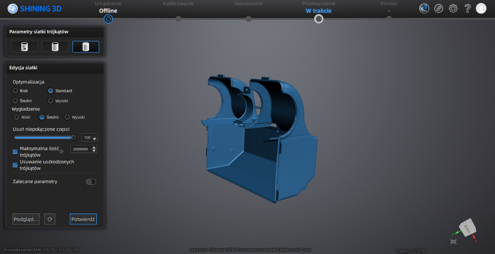

Hello forum members.

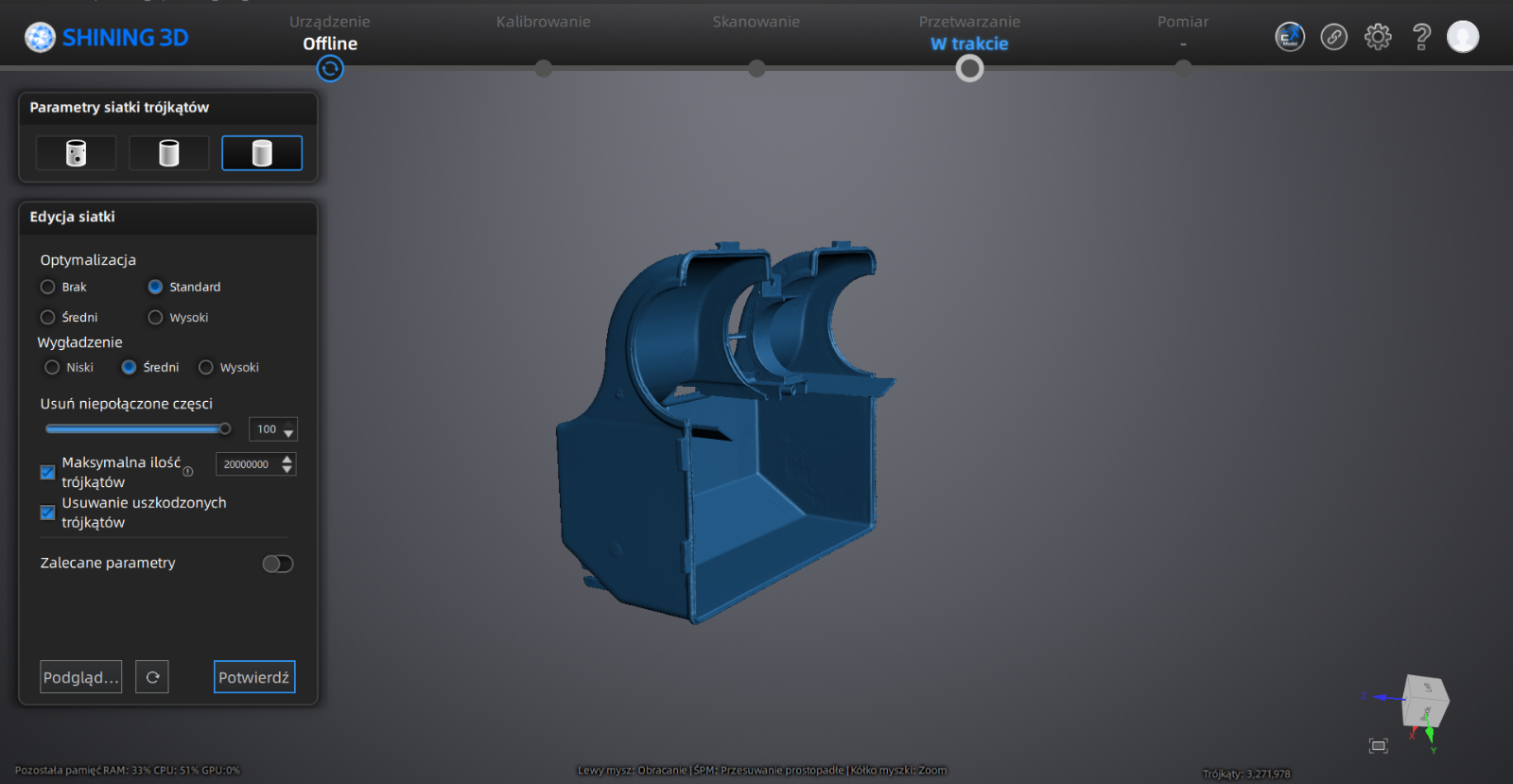

I've been away from the air conditioning for a while, but work is ongoing, and the new evaporator, equipped with a new core and a modern, much more efficient fan, is almost finished. This week, we'll have the modern air conditioning evaporator unit ready.
We've also refined the surface texture of the evaporator's side air intakes.

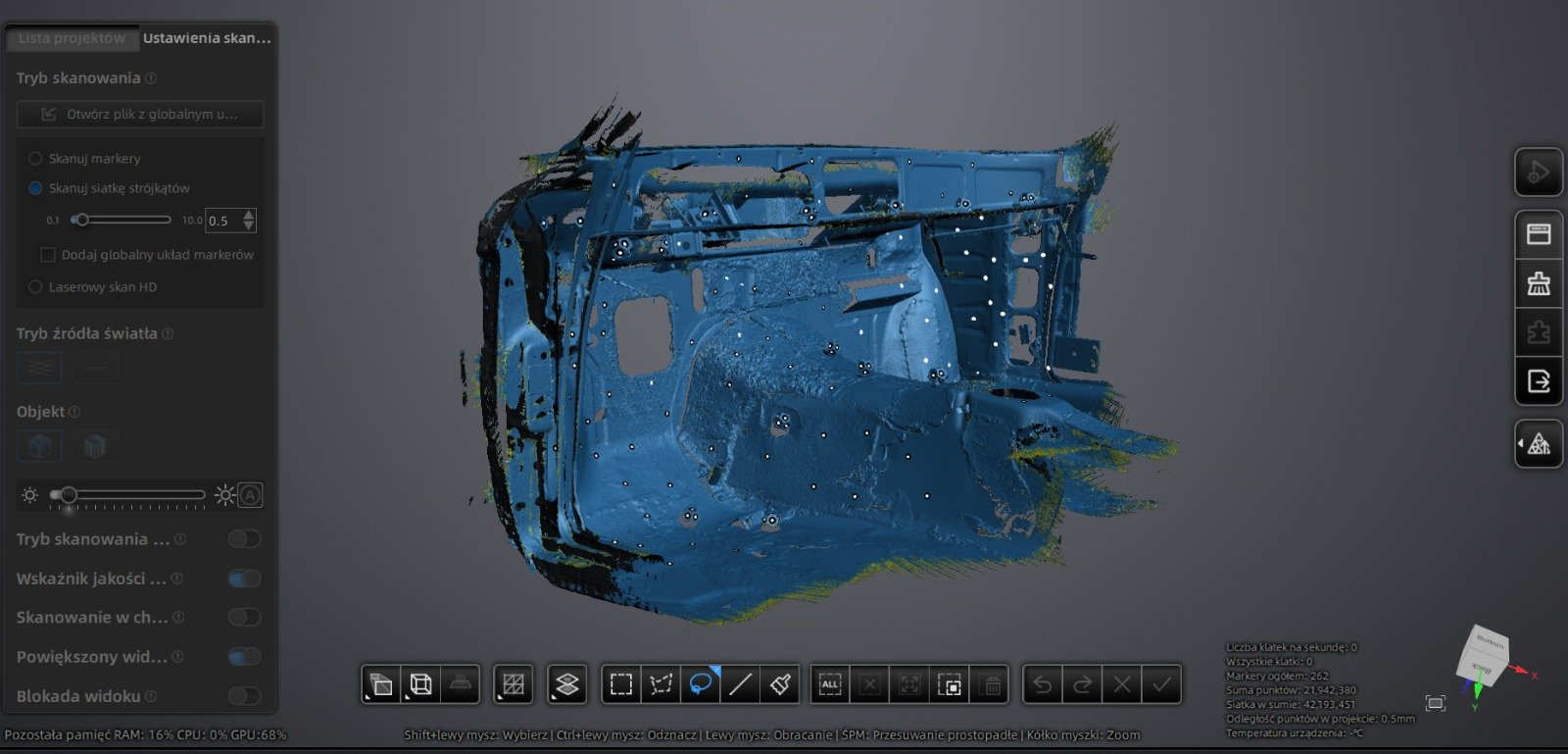

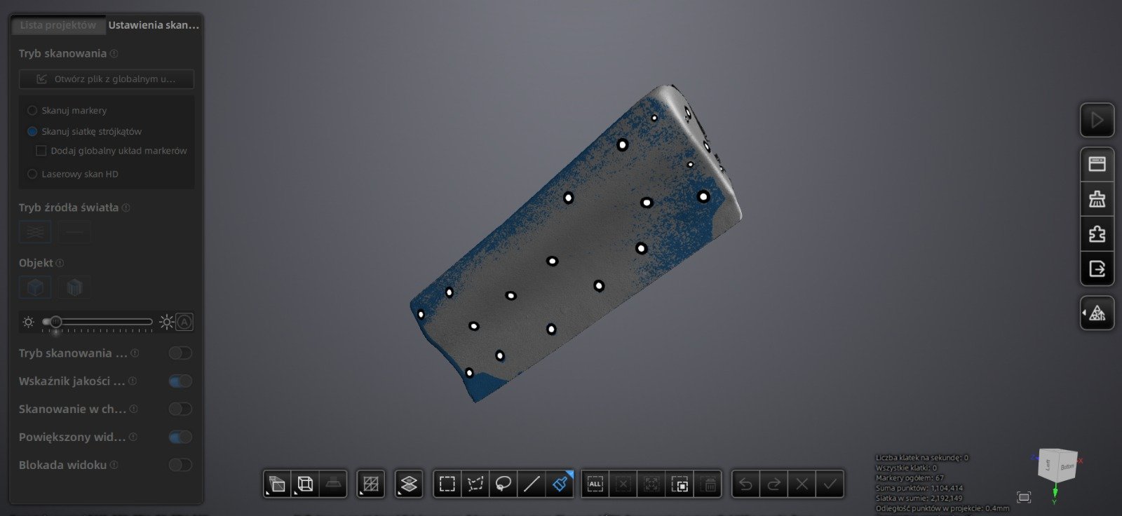

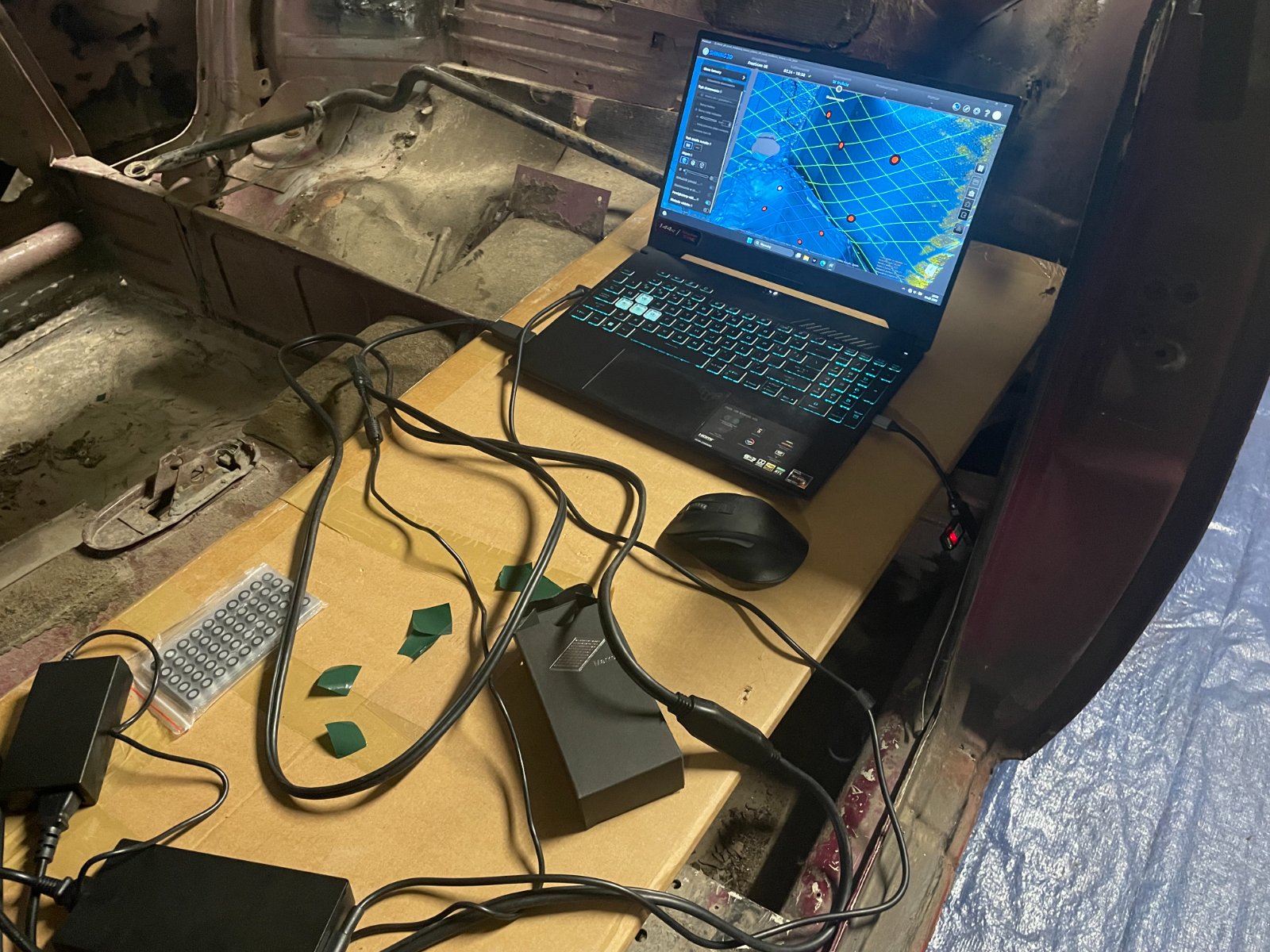

In the meantime, among other things, the interior of the BMW E9 has been scanned, and work on improving the cold air flow efficiency will soon begin.
We have an idea for adding an additional air duct, the installation of which won't require major modifications.
We're currently redesigning the original evaporator base, as the design and shape of the original base are difficult to replicate.

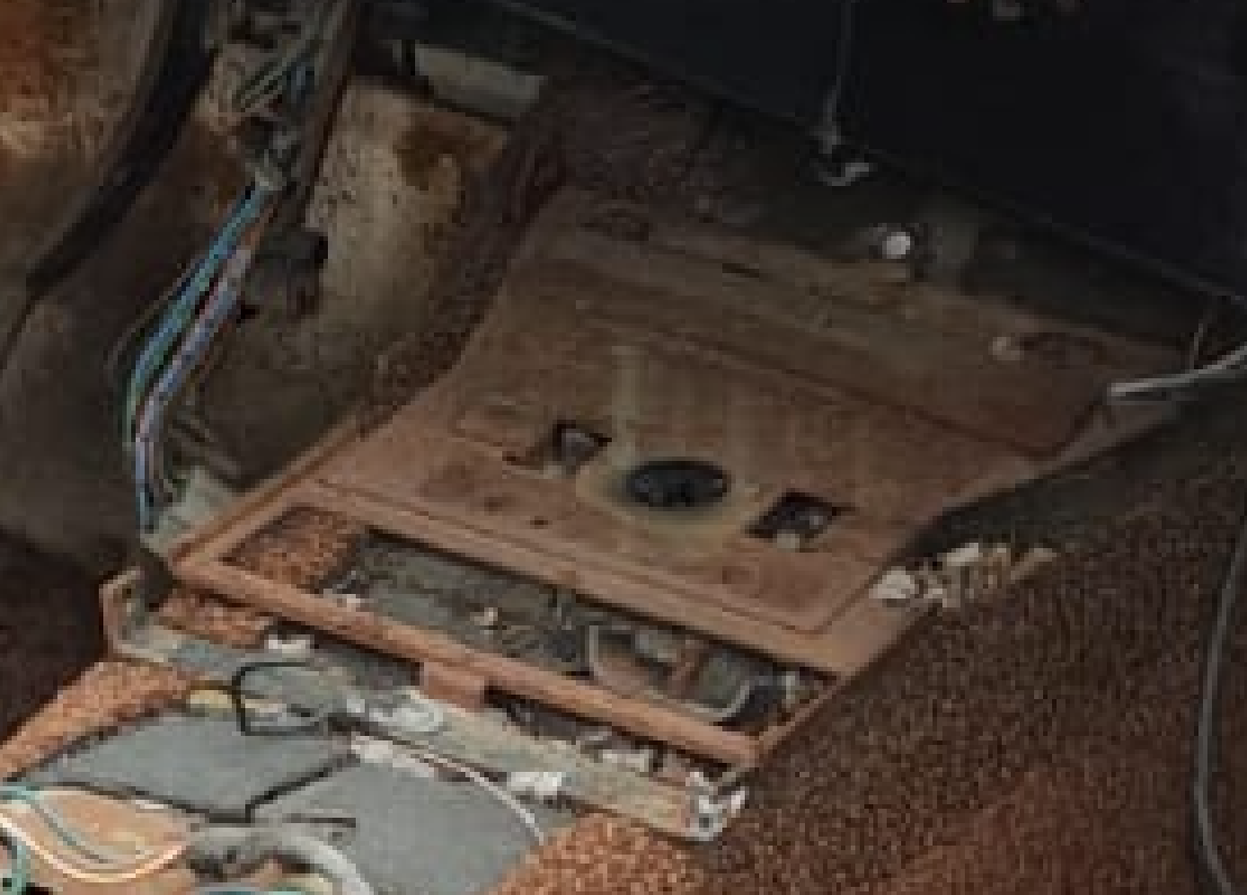

We're also having trouble identifying the evaporator bases.
The photo shows two versions from the E9, but I own a car imported from the US, and the evaporator base inside it is even different.
BMW's bluebooks don't clearly show this either.
Does anyone know why these bases are so different and what causes this?
All comments and suggestions are welcome.
