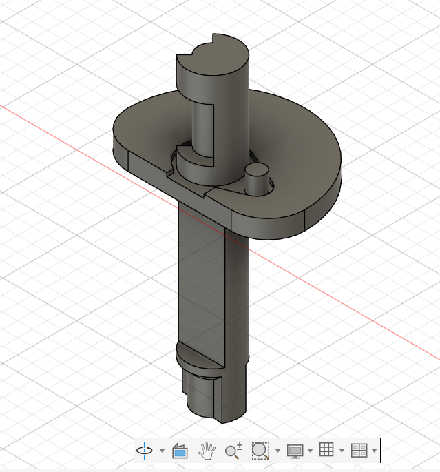

I've been experimenting with a couple of e3 ignition switches that I've ended up with. Both had the same problem, which I understand is common, of not being able to turn the electronic portion of the switch far enough to engage the "start" position.
I took apart the steering lock assemblies and determined that the problem with both was wear on the ends of the intermediate shaft that connects the ignition barrel to the electronic switch. I also noticed similar wear in the end of the ignition barrels. Altogether, this created enough slop that the electronic switch wouldn't move completely through its range to "start" when the key was turned all the way.
I know new steering lock assemblies are available, but I also know there are a few different types and I wasn't confident that I'd end up with the correct one. So, I decided to try to copy the intermediate shaft in Fusion 360.
After a few iterations, I have a design that works! It's a pretty faithful copy of the original metal piece with the exception of extending the ignition barrel end by 1mm to help it reach past any wear on the end of the tumbler socket.
It needs to be printed out of a stiff material... even once I had the design down, the test prints I made with PLA would twist too much axially and not engage the start position on the electronic switch. When printed in carbon-fiber reinforced nylon, though, it works great.
The only issue with that is that with the nozzle I have the carbon fiber filament is kind of a low-resolution version of the part, and needed some cleanup with a file. But, maybe another stiff filament would work, or a print using a finer nozzle (I'm pretty limited in the nozzles and filament I have on hand right now).
Anyway, I thought maybe this could help someone else. I don't know durable this will be in the long run, but I'm going to try using it for now and see how it goes (this photo is of one of the PLA test prints). If anyone wants the file just let me know, I don't think I can post it here.

Expertly done part, especially considering how much overhang there is!
My favorite 3D printing trick is to design a hole through the middle of the part and then drive a screw in as a final step. Voila, a perfect plastic part with a steel spine that won't bend or twist. In this case I can't tell if the shaft would be too narrow make hollow. It would require a pretty particular screw, like M2 x 100mm or something.
Great reverse engineering!
Great work.
I'd like a copy of the model , can work with Fusion (beginner level though).
Having the model also will allow to get a qoute for a metal 3d print.
If it works in a plastic 3d print, but the torsion is critical, then we have little other options than moving to metal.
I'll pm you
I think it'd be tough to run a screw through the center because much of the shaft is a half-moon shape. But that's a great idea for other applications, thanks! I'm relatively new to 3D printing so any tips like that are helpful
if it comes to torsion, the perhaps it would be best to Epoxy glue a 2mm square rod in it. It'll act as a "spine"
Benefit over threading in a M2 thread (cut from a 1 meter section) in there is that you have more 'intact' material around the spine to transmit the rotation forces
And one thing to prevent in plastics is if the spine is oversized, thus pushing the plastic outward even a tiny bit, it'll crack the plastic radially. That's why i'd undersize the spine, and fill the gap with Epoxy.
An update to this... I tried designing a version with a 2mm square hole through the center, and while it theoretically works, there's really not enough clearance on the flat side of the shaft (the printer can't actually print it that thin). I think that with the carbon-reinforced filament it's stiff enough without it, though.
I also tweaked the design to add 5 more degrees of twist to the end that plugs into the electronic switch (for whatever reason, the original metal shaft has this end slightly rotated from horizontal, and I was just guessing at the angle initially). I had it at 5 degrees from horizontal originally, but that seemed right on the edge of actuating the electronic switch to start. So the new version is 10 degrees from horizontal and that seems to work better.

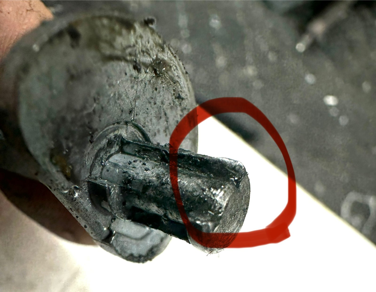

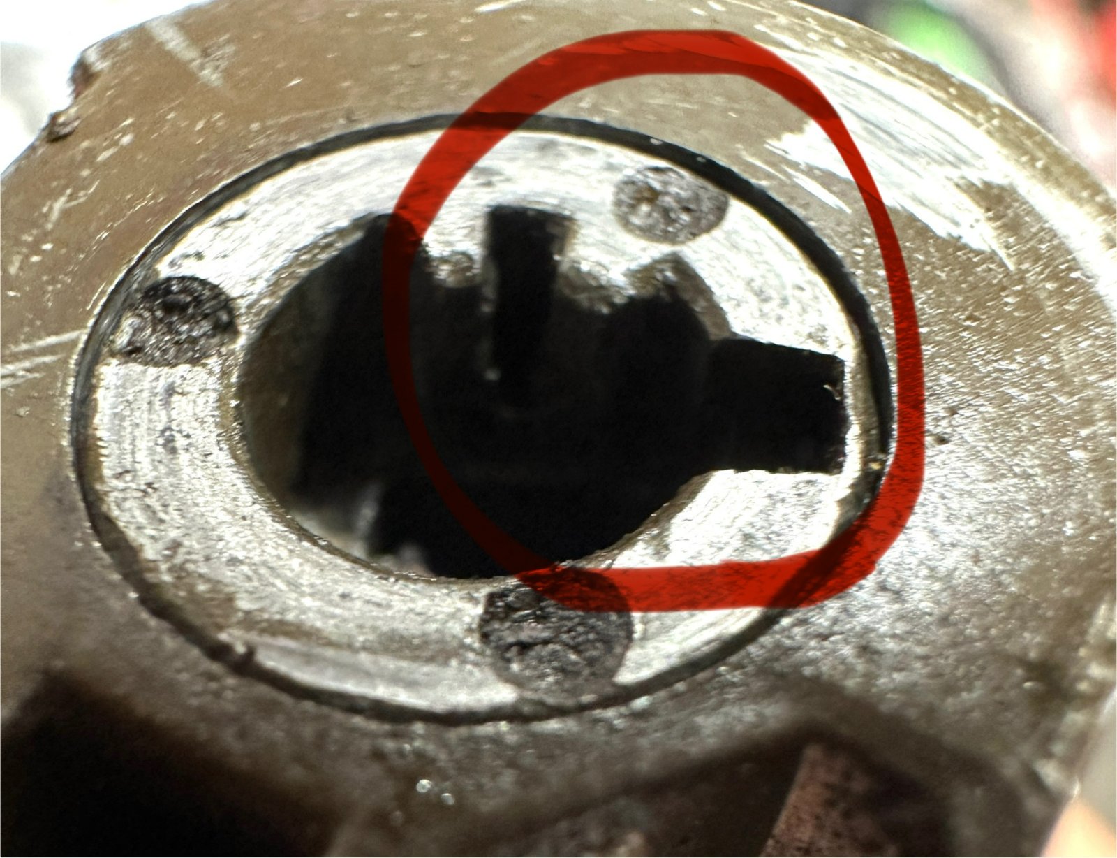

To better illustrate the problem this solves, here are a couple of photos of where the wear occurs on the original metal shaft and the socket end of the ignition tumbler. There's a nub and track in the tumbler that limits the total movement of the key to about 170 degrees, which is also about what the electronic switch requires to activate the "start" position, so it doesn't take much wear for this to no longer work.

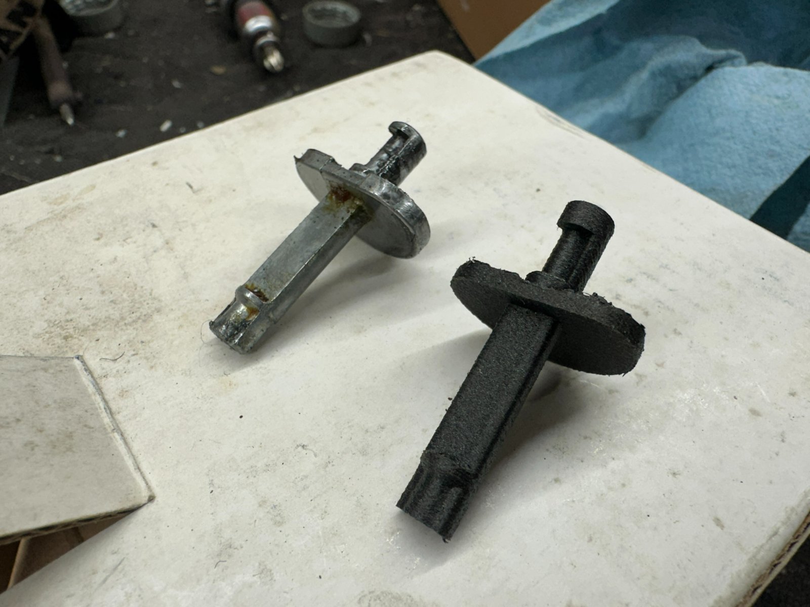

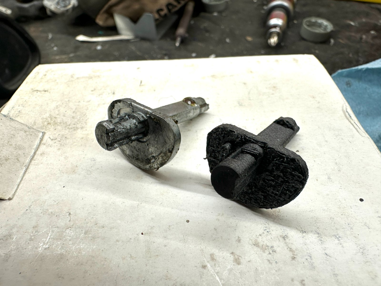

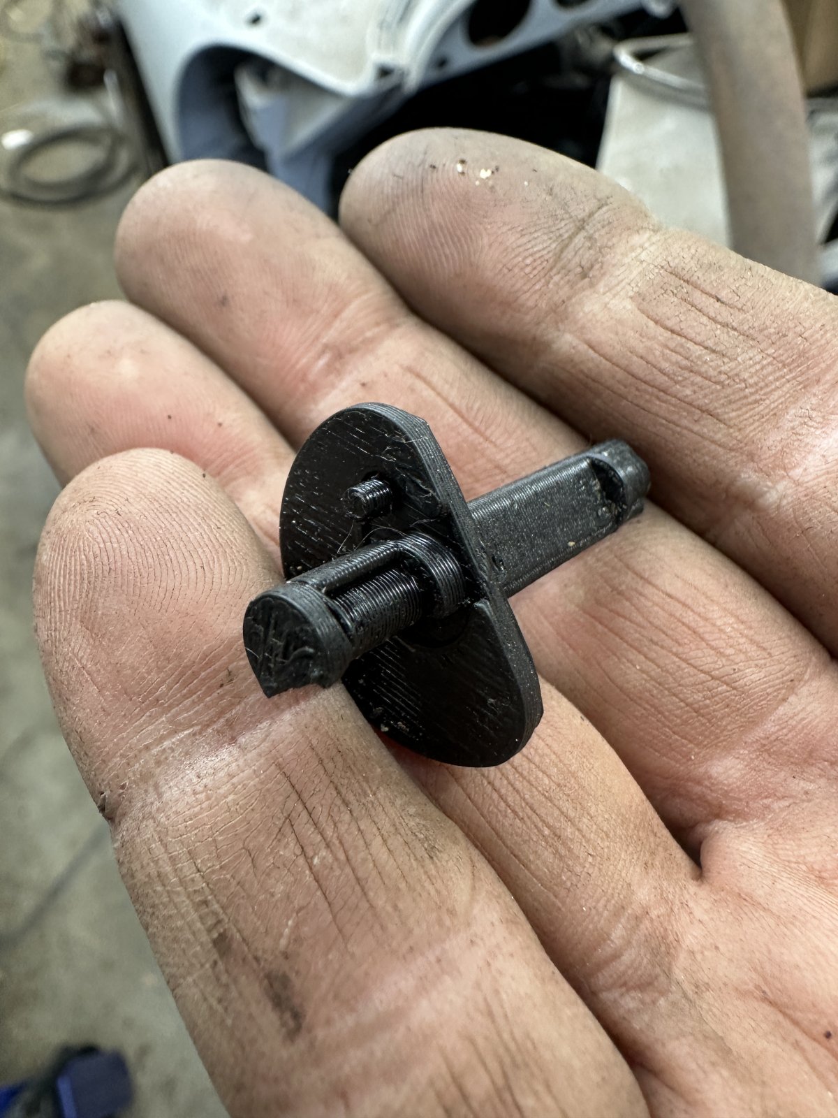

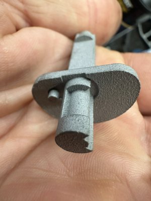

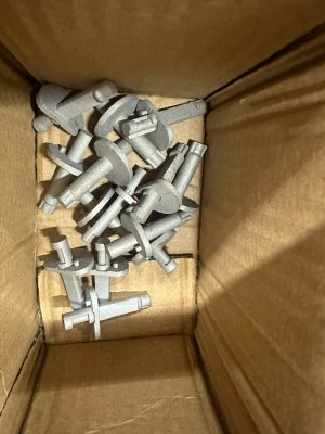

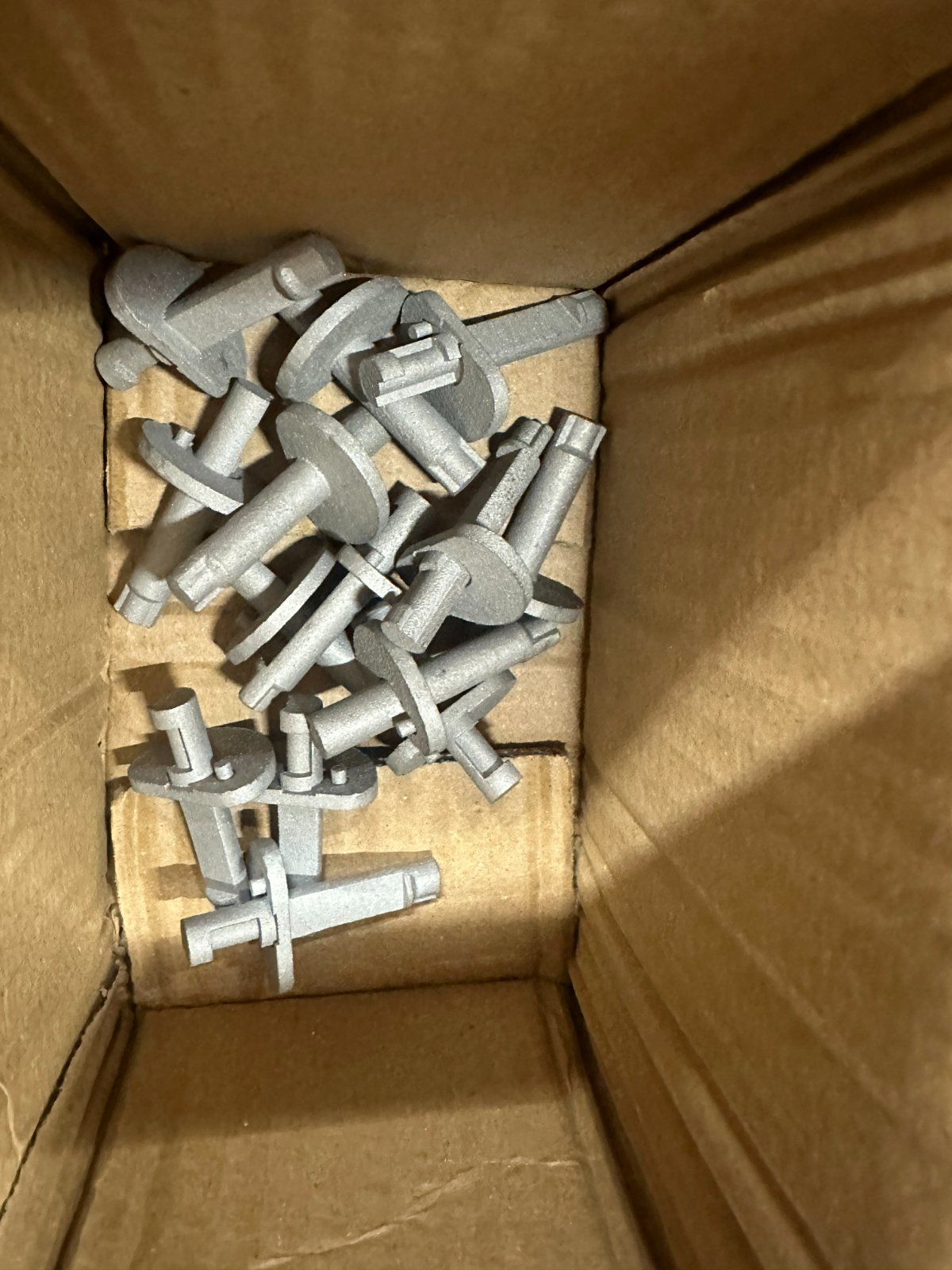

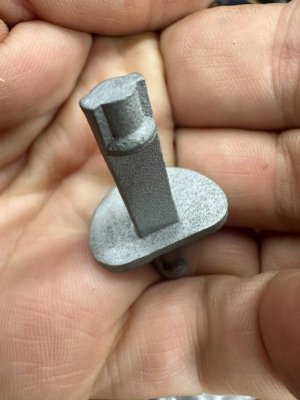

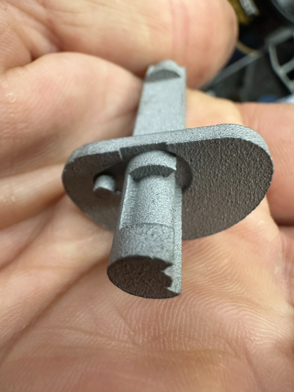

I know this isn't the most exciting thing in the world but I figured I'd post an update on my continued adventures in ignition switch repair. I decided to go ahead and have the part printed in metal via one of the online services that provides this (I used craftcloud). It was one of those deals where it was the same price for one or like 15, so I got a bunch of them.

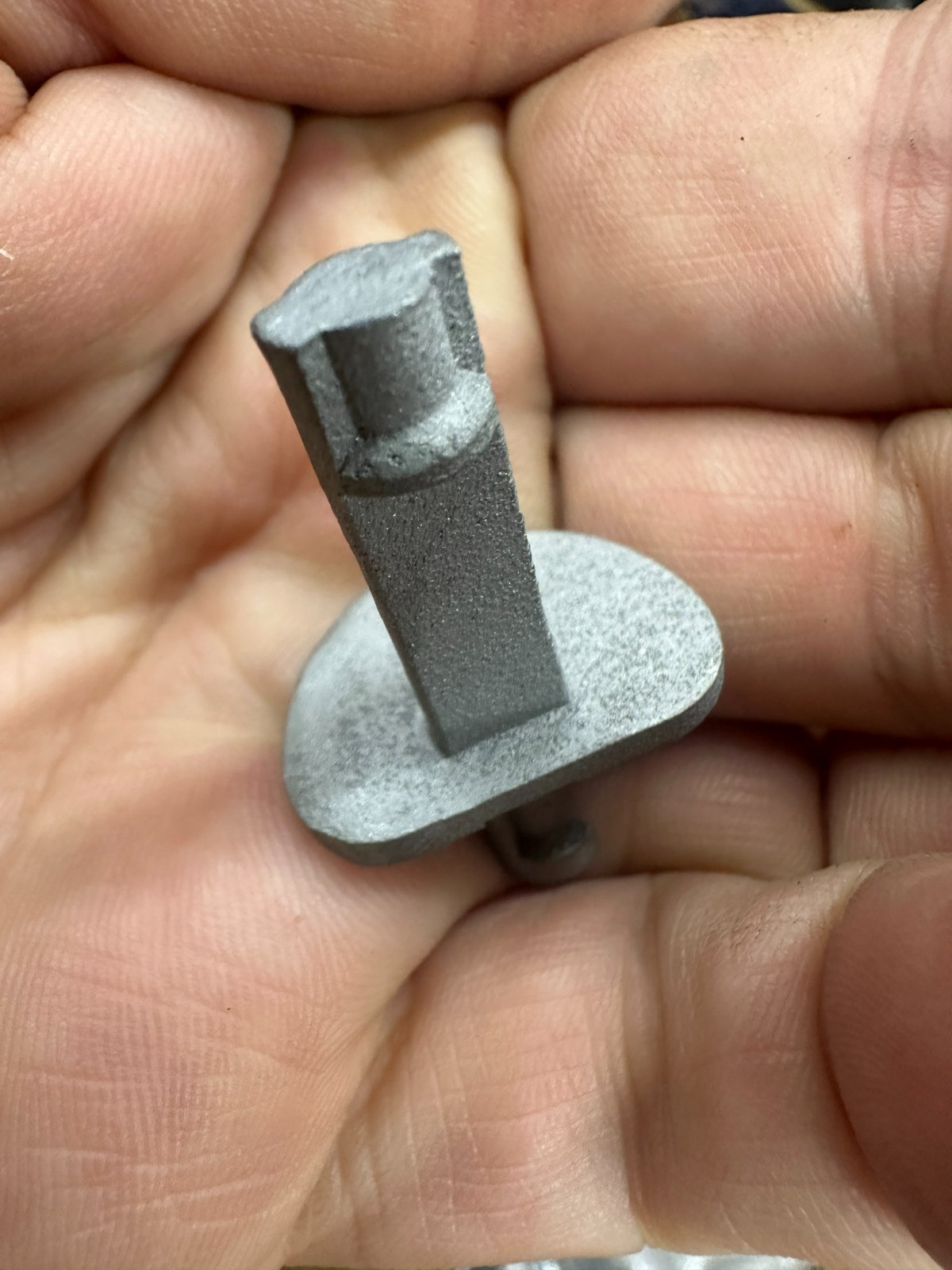

They work! I assembled my ignition switch and it works great. I made the extension on the lock cylinder end like 1/4mm too long (it's longer than the original part to better engage the end of the lock cylinder, which wears along with the original part), but it all still snaps together and this would easily be corrected with a grinder if wanted. They're stainless steel and should be pretty bulletproof.

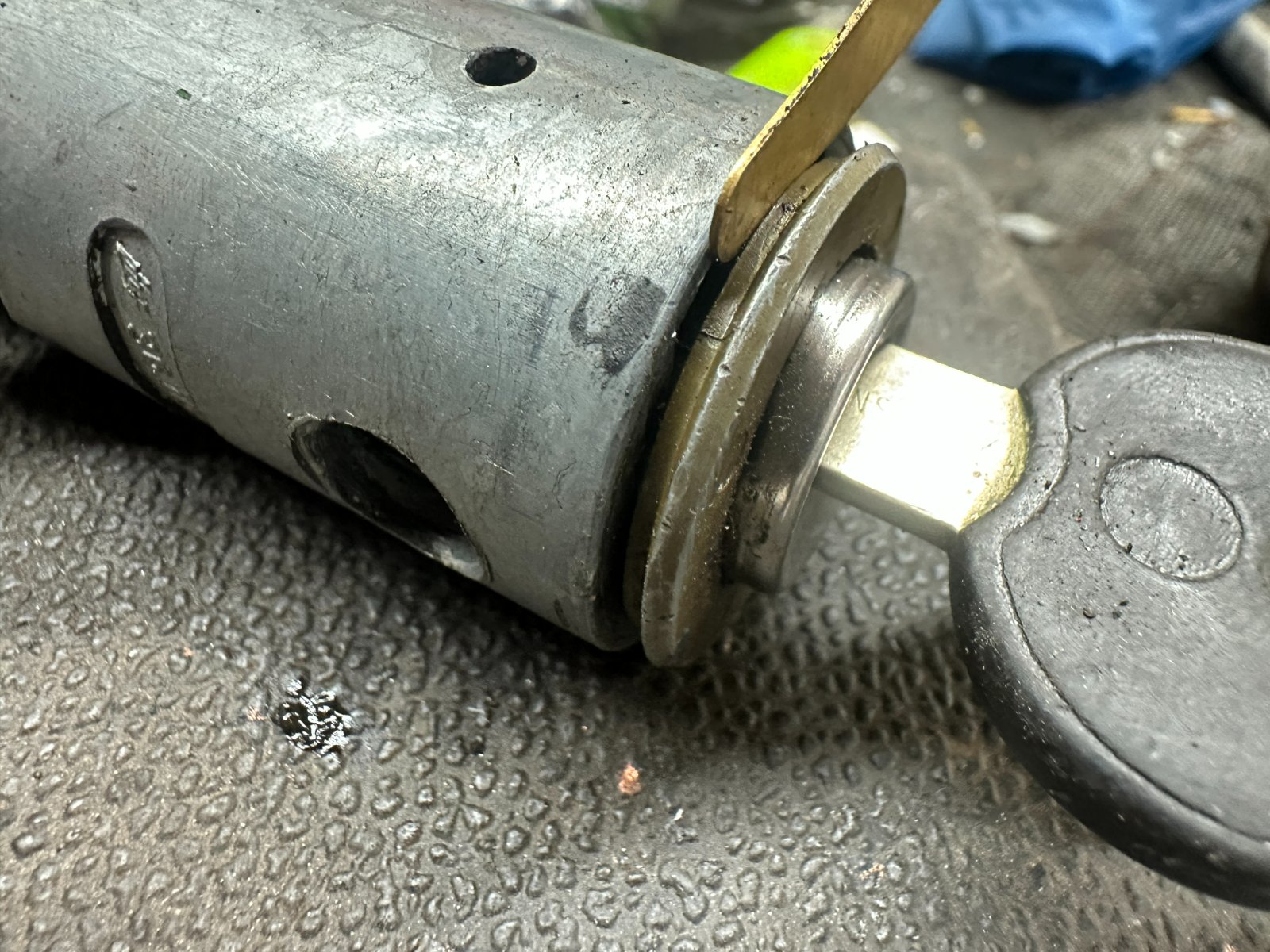

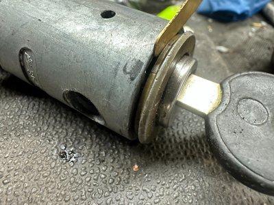

Edit: Just to be super clear what I'm talking about with it being slightly too long, take a look at the last photo... that's a .5mm feeler gauge measuring the gap between the tumbler and the steering wheel lock barrel. They should be flush up against one another. So, while it does snap together like this, it would probably best to take ~.5mm off of the end of the part I made (the end seen in the second photo).
If anyone wants one let me know, I'd be happy to send one out for 20 bucks or so just to cover my time and shipping.
