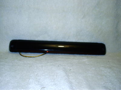

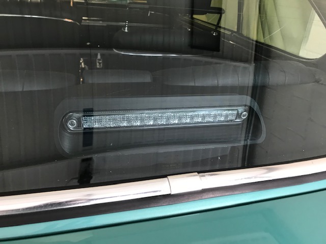

Hal Boyles from the 2002FAQ made up a nice 3rd brake light assembly for '02s. He responded to a request from E9 owners and just came out with a unit shaped to the E9 winshield.

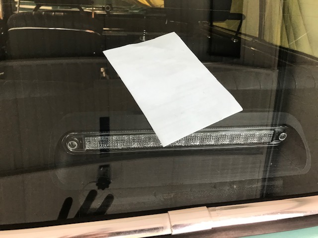

It's a good fit. Not much more than a folded paper in gap from edge to center.

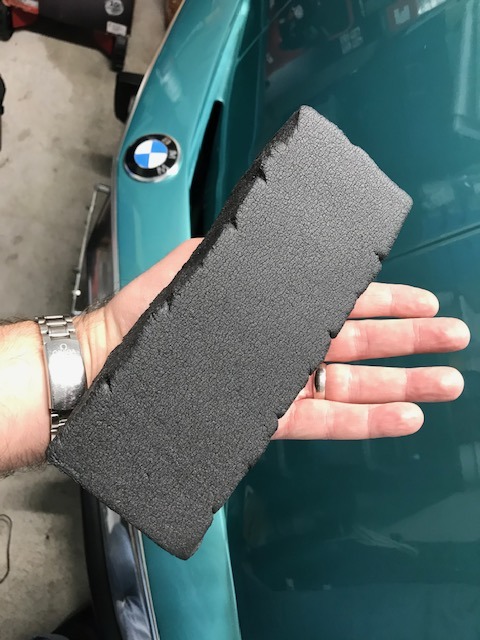

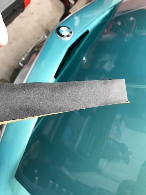

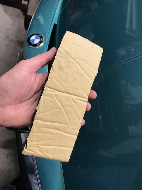

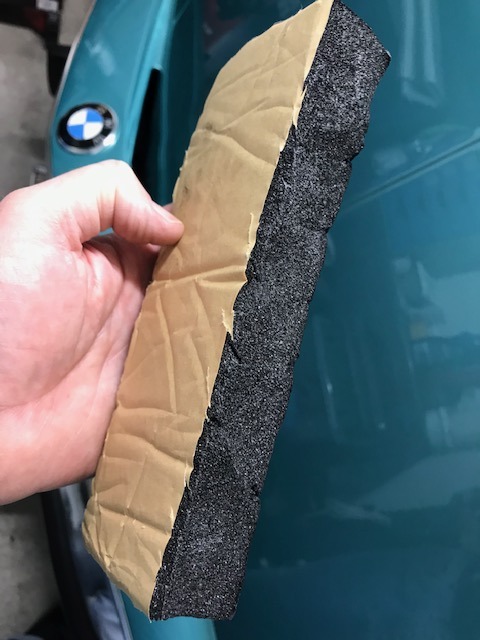

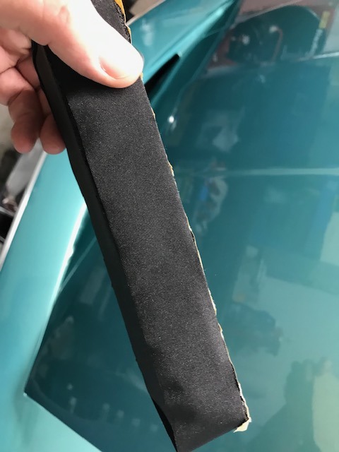

I used some left-over 3cm closed-cell foam as a stand-off.

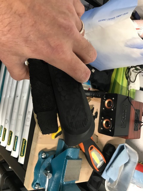

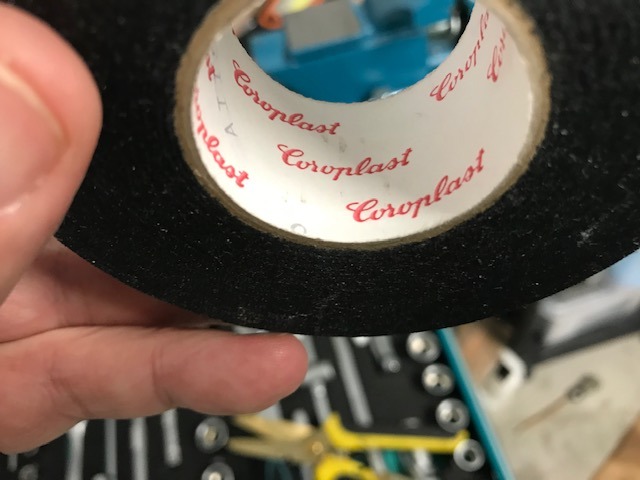

It's almost impossible to cut a clean edge on such a thick piece of foam, so I used fiber tape to dress the edge:

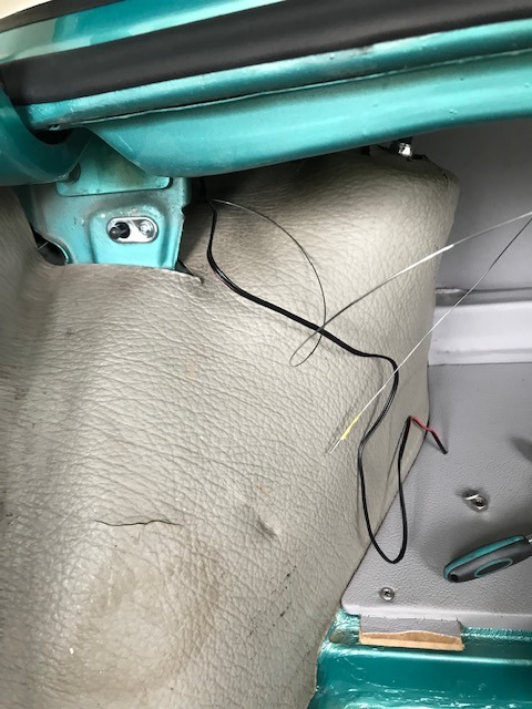

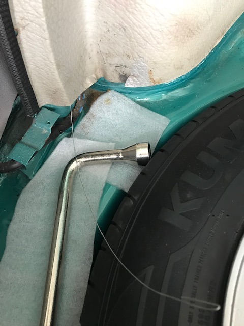

It comes with about 2 meters of wire attached, so I was able to fish it under the elephant skin.

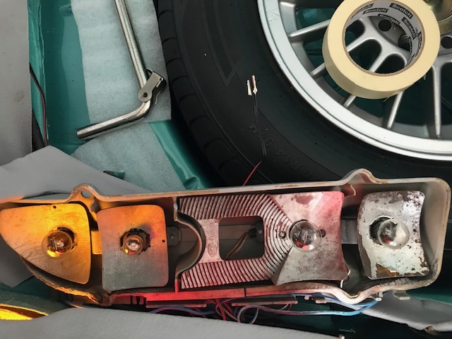

My tail light needs a reflector rehab, and I ran out of time to make the connection,
but the mounting turned out well. I have it offset from the window about a CM, rather than flush against the window. That way I don't need adhesive on the glass and no vibration tapping.
To order the brake light unit, contact Hal on the FAQ:
I will wire in a flasher unit as on my Tii - Three short, three long, then constant ON; instant ON, no delay.

Willem and I were the first to buy Hal Boyl's 3D printed brake light. Several months ago I got Andrew's light bar info for the top of the rear window,but couldn't find the red neon light strip. I helped Hal measure the angle needed to make his light. The angle of the light is correct, but the curve is too flat to allow the supplied clear 3M double-sided tape to attach the light-tight to the glass. I could also slide a folded piece of paper between the glass and the brake housing, even after filing both ends of the mating edges. The light needs to be tight to the glass to prevent the bright LED red light from reflecting back on your rearview mirror at night. The photo will show how the tape is now only holding the light to the glass in 2 spots on both sides of the top edge. I think putting a double layer of tape across the middle of the top edge should allow contact in a longer part of that top edge. The LED light is very bright and should help drivers see the car. Hal has also made a 3D printed light for the 2002.
