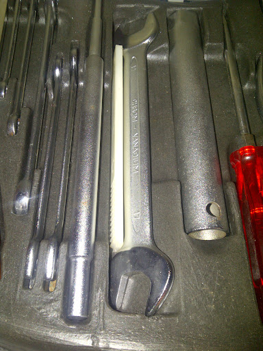

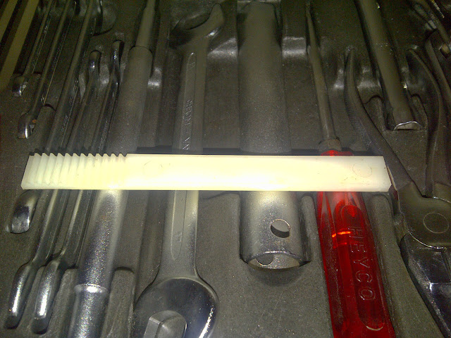

This is the access tool, I remember my old 73 seemed to have one with more teeth (where are the window access tool police, and what year did it change?). I store it in the tool kit alongside the big wrench. I estimate it would take a week to get a window down using this thing so I went ahead and rebuilt them all. There is an article in the Registry about the window motors and holes, I will see if I can find and post it.
Boy, wish this tool was available when I had to manually raise the driver's side window close from the fully down position due to a dead battery. Just a very tedious and unpleasant task, it took just about 1000 flicks of the finger on the tooth spindle to fully close the window (yes, I counted) :).

BTW--the BLUMAX also has one of the unobtainable nylon "combs"--the rare emergency window tool. And it does save fingers being bitten when urging an over-run window--I'm sure there are members who have experienced the "bite" from the wheel when the motor suddenly engages.
Someone should undertake re-producing the "comb".
