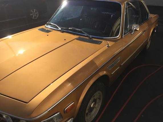

Rick - a bit of Vancouver just arrived in my shop...
It's a 225 car with AC from Tim
Hi Don,
Thanks, just bought it. The Ceylon car looks great, the other one up here sold a couple of days ago, went across the water to Europe. Howmany does Tim have now???
Thanks, Rick
