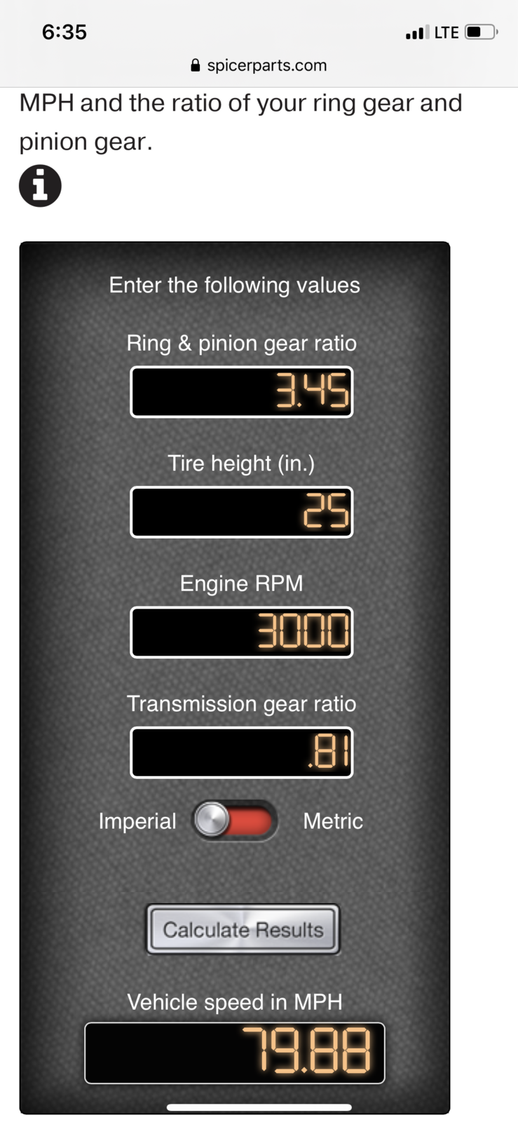

Has anyone had a rebuild or 5 speed conversion by Metric Mechanic. They claim to have a new improved "Ultimate" replacement. What differential gearing is best for 80 mph cruising speeds?
Gear ratio Calculator
I’m a little skeptical. You are either getting a G265/5 or a G265/6. The G265 was offered on other cars so I’m sure other ratios are out there used and new. There are some places like gr-box.sm making custom ratio and FIA homologated 265/5’s.
I don’t have any personal seat time behind a G265/5/6 but the experience is highly documented. Plus there is that thing called math which I tend to rely on too heavily. The 265/6 already works great with several e9 diffs, and the 265/5 is really no different than a factory 260 as far as final drive.
