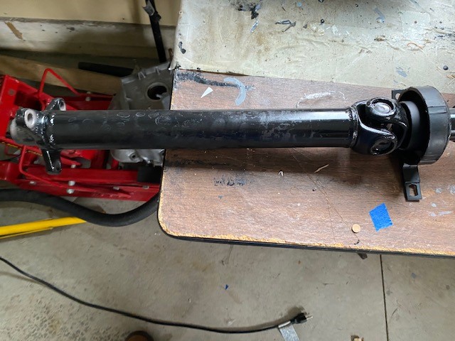

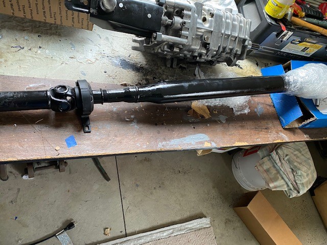

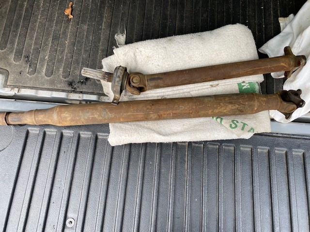

Found an old DS that was still in OK condition and sent to Oceanside, they shortened it, rebuilt the entire shaft cleaned and painted and balanced it. My kit is ready to install. Oceanside did a nice job.

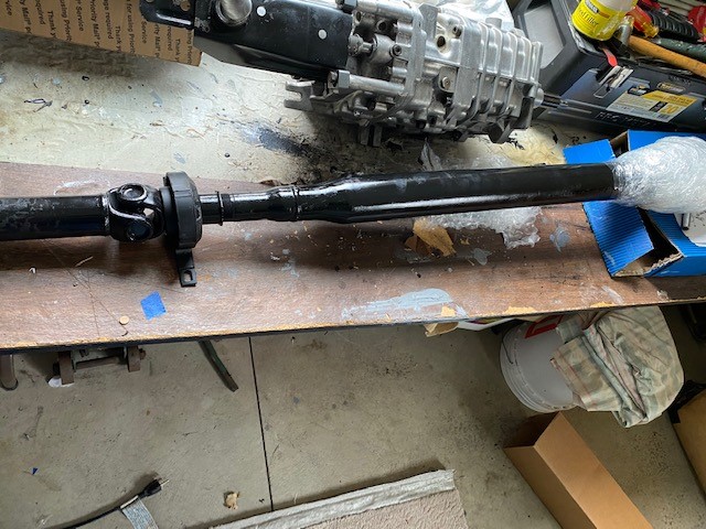

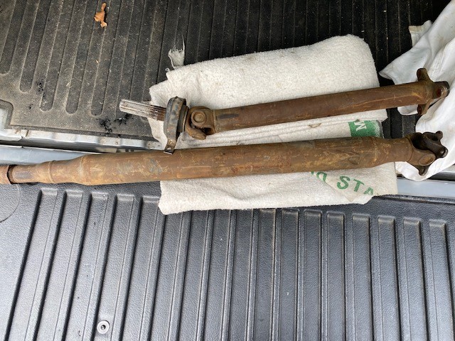

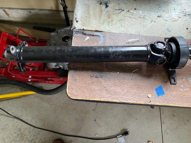

Wow that was quick!
