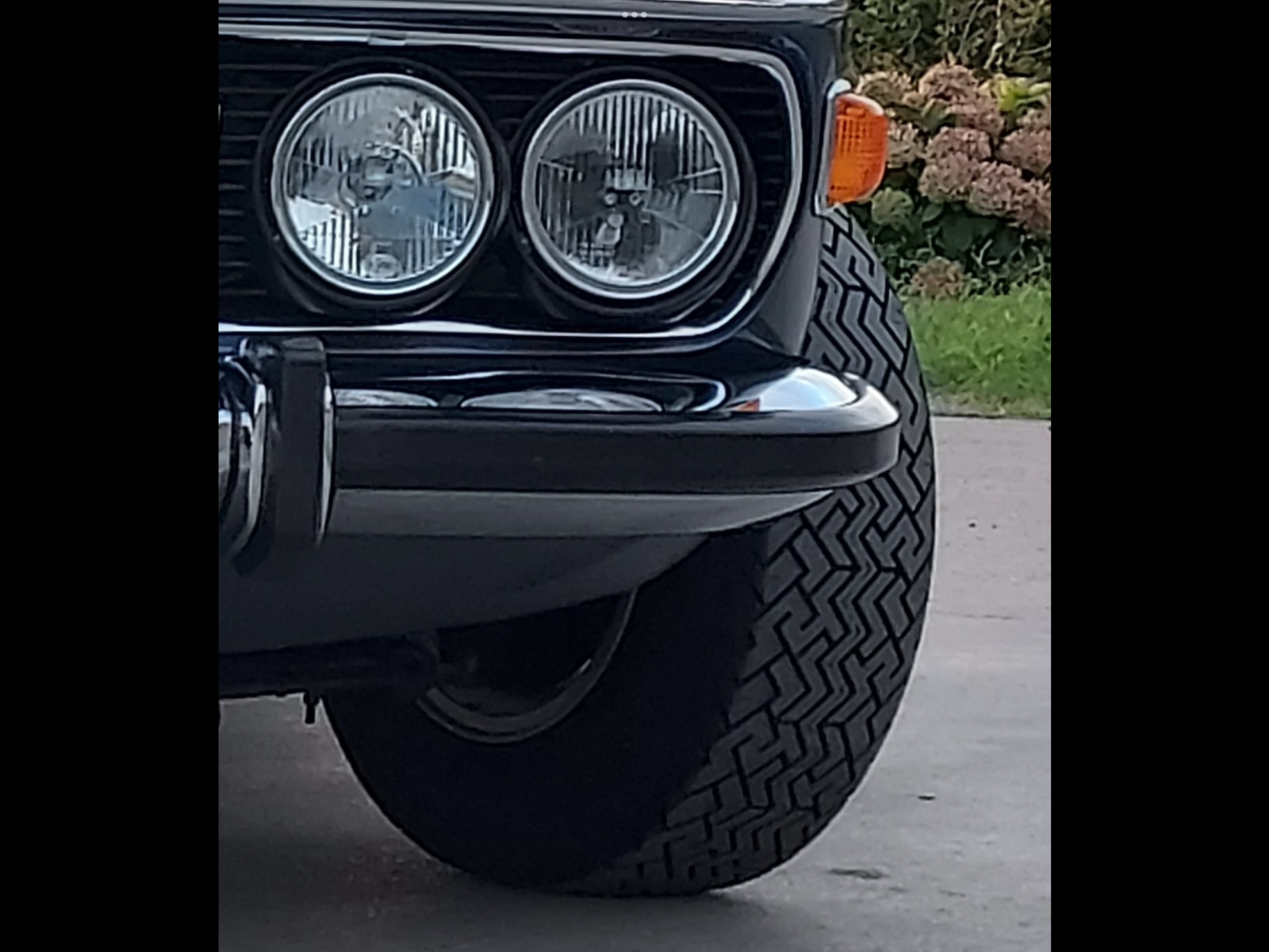

I get a few years ago, there wasn't a good tyre in the correct 195/70VR14 size, and importatnly nothing of the right sort of carcass structure for your cars so people were fitting the 205/70VR14 XWX which is a great tyre, but the wrong size. However things have changed. Pirelli now make the 195/70VR14 Pirelli Cinturato CN36.
BMW do have history with the CN36, there is this picture, but also CN36 were the tyres that Alpina were fitting on the 2002. They are a fab tyre.

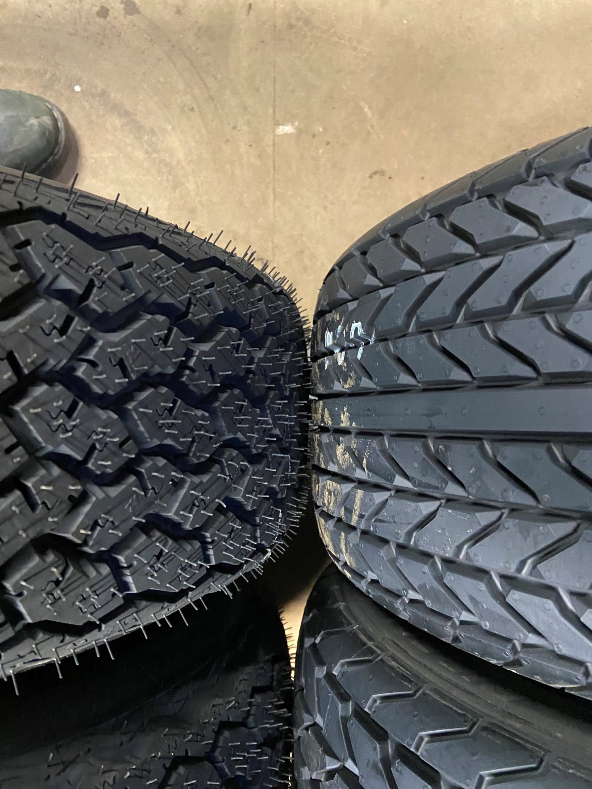

This is a fun picture which shows 2 tyres of the 205 size. The one on the left is the 205/70VR14 XWX. That is a suitable carcass structure for you guys. Sadly they don't make the 195/70VR14 XWX any more which is a shame because it was one of the OE tyres, and the tyre fitted in the majority of cases. The other tyre in tht picture is the 205/55R16 Pirelli P7 (incidentally OE on the BMW M1). But imprtantly what you can see is how much more rubber it puts on the road, this is enhanced even more with a more modern tyre. But what is happening in this phase of car design is the cars were moving away from Progressive handling, because they were developing the technology to keep these wide foot prints on the road, so they were moving into a phase of ultimate grip, which wont happen on your car. you wont get the extra grip of a fat modern tyre, you will just degrade the nice handling that a proper tyre will give you.

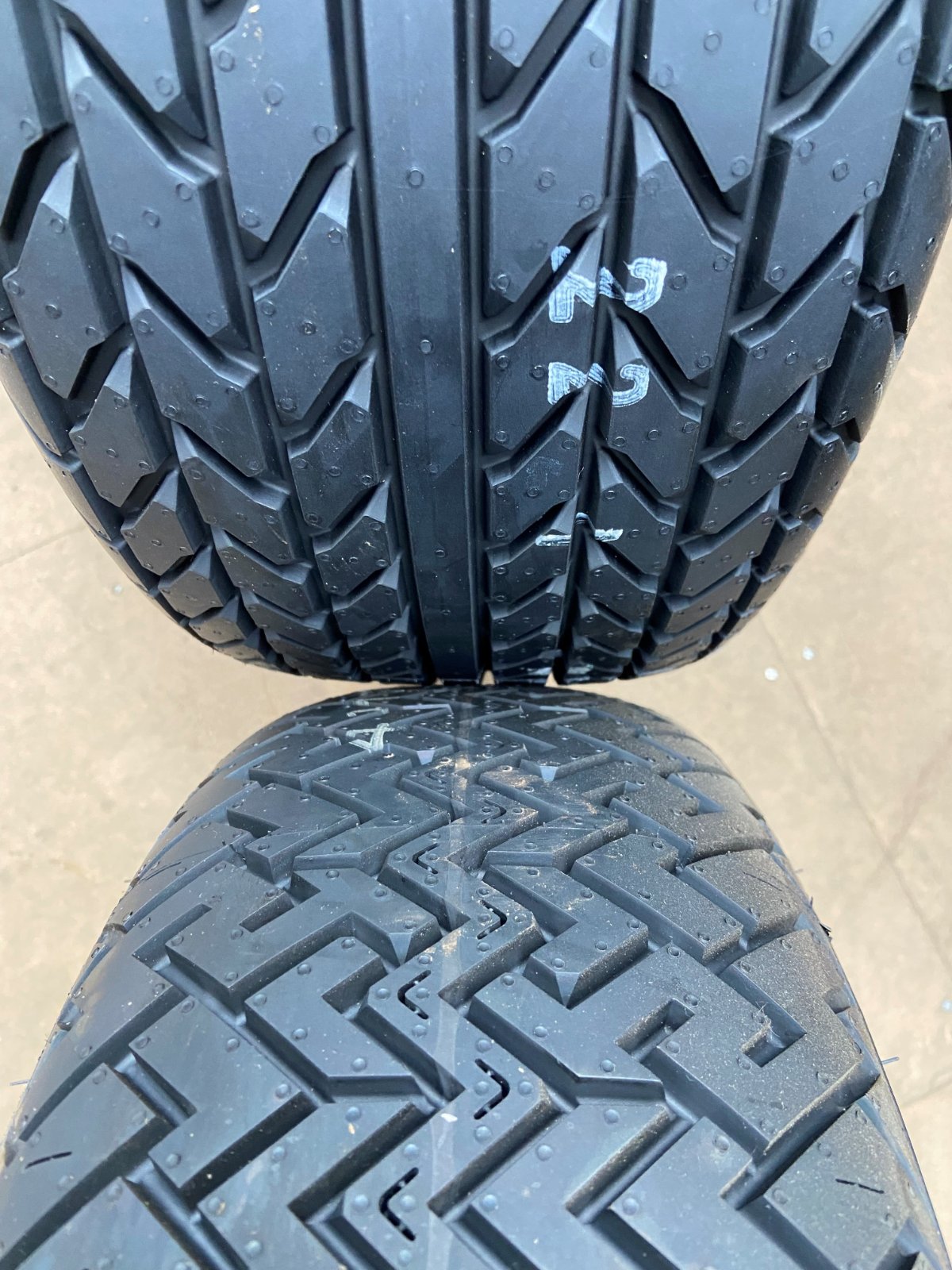

This is pretty much the same thing be done with the proper 195/70VR14 Cinturato CN36.
Both CN36 and XWX are perfectly suited to your cars and will handle brilliantly. I think the XWX might be a bit more durable, and if you knew you were going to be pileing on the miles, specially in a hot climate the XWX might tip the balance, if they made a tyre the right size, but in generall the CN36 is pretty fab and currently by far the best road tyre for your car.
