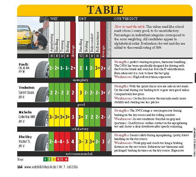

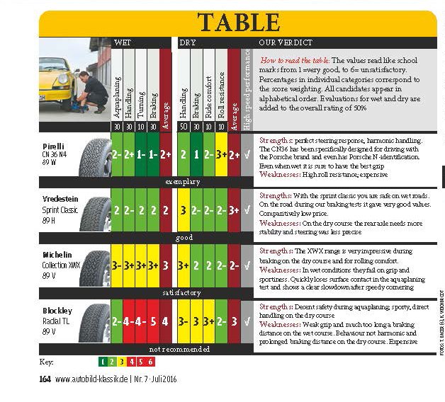

I must say i am suprised by your experience of Pirelli. It certainly is contrary to everybodies experience of the current production of the CN36
I must say i am suprised by your experience of Pirelli. It certainly is contrary to everybodies experience of the current production of the CN36View attachment 199572

Hmm well they were a really famous tread pattern, from 1968 in the early 1970s they were the business tyre on cars like the RS 911, Ford Mexico, etc. then i suppose their thunder got stollen buy the P7 in the later '70s. However, they arent suited to your car. You are better off on the CN36. it better suits your chassis 9or the Michelin XWX if they made the right size.)

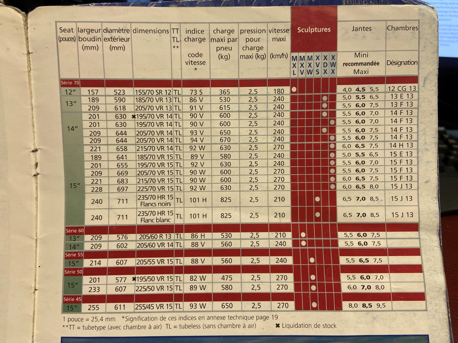

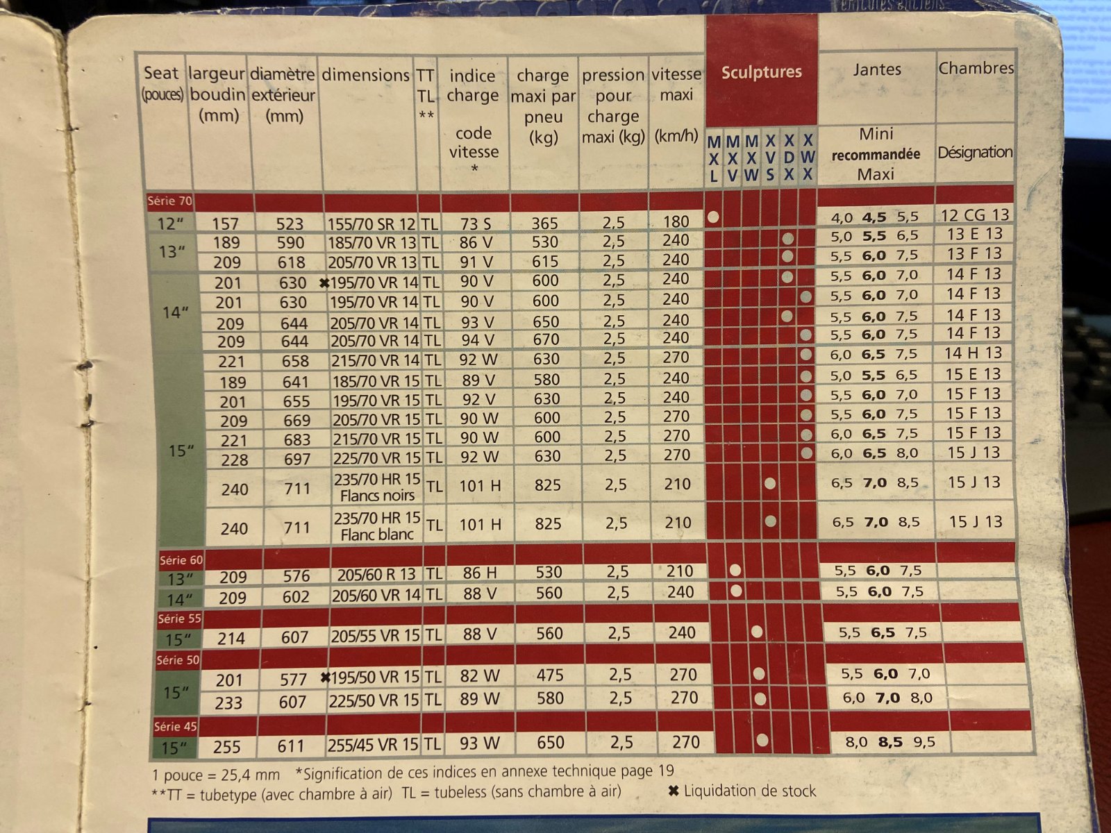

This is what the Michelin brochure said ion 2000
I guess they list the E9 because lots of them fitted XWX as OE. 195/70R14 is a difficult size to justify making. It is a small volume tyre size, and for a company like Michelin to make a 205/70R14 XWX (which also fits) and the 195/70VR14 is difficult to justify.
