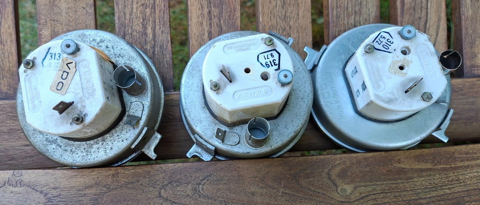

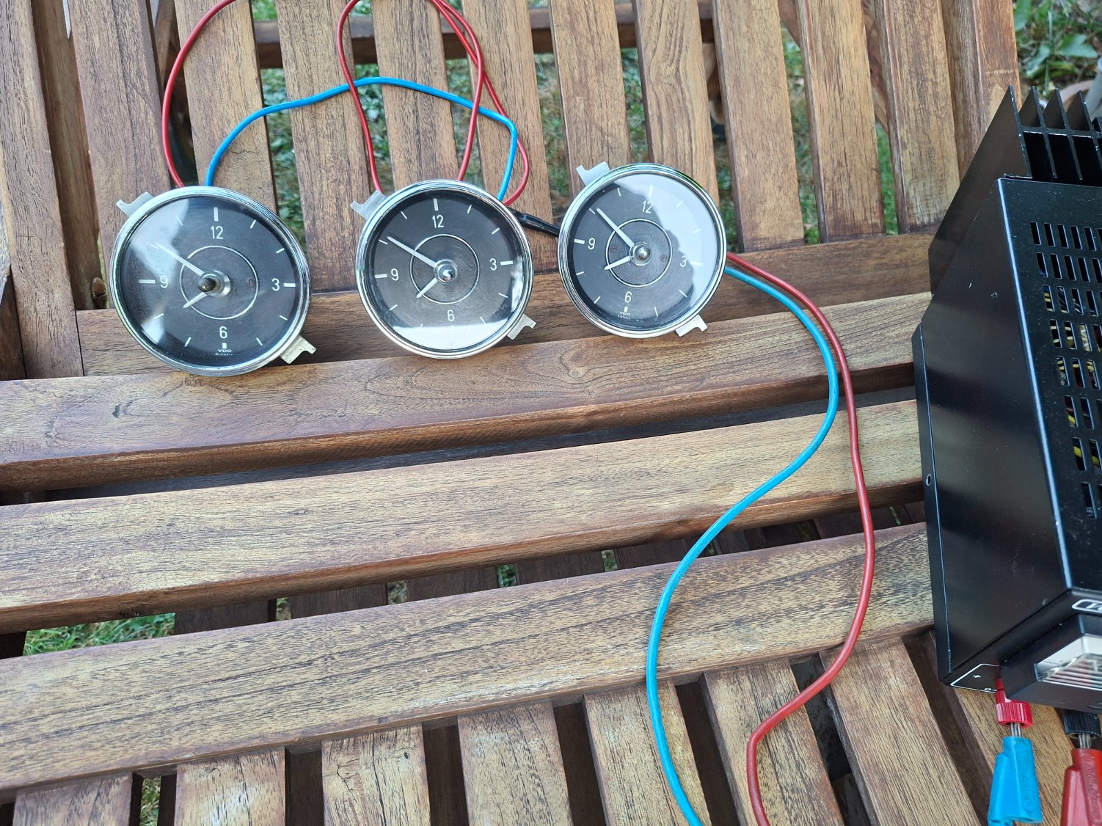

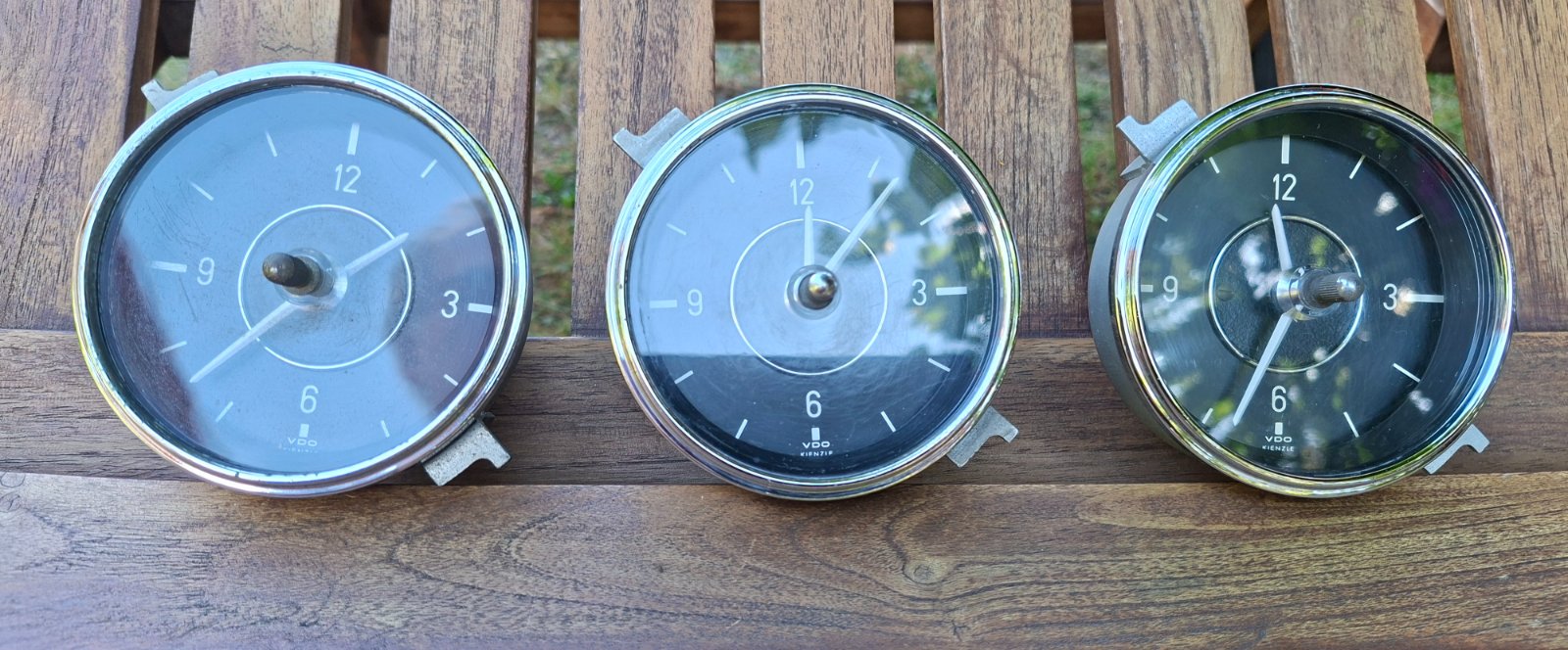

They have been tested and are working fine.
Prices vary from 70€ to 100€. Plus shipping from Germany.
Thomas
