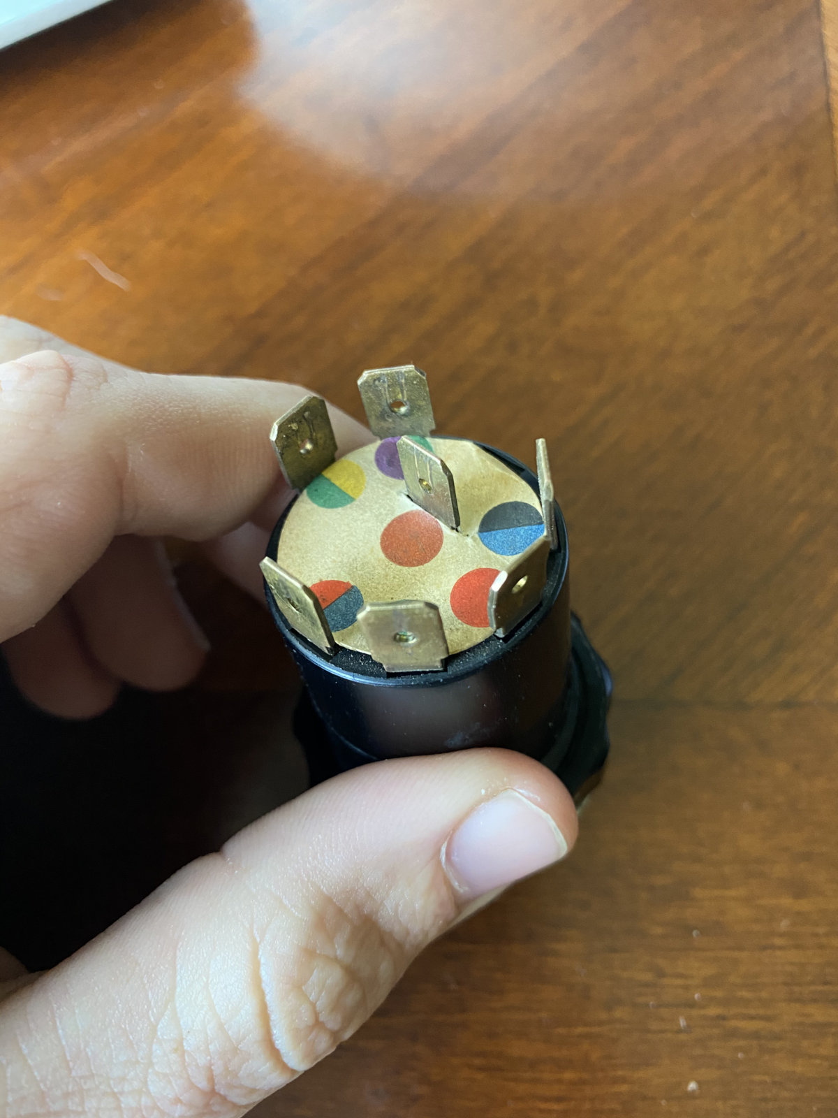

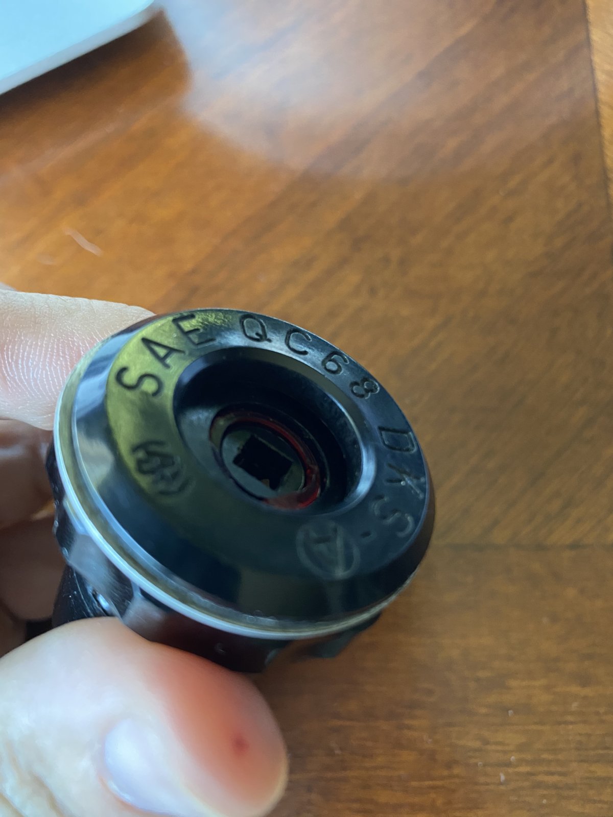

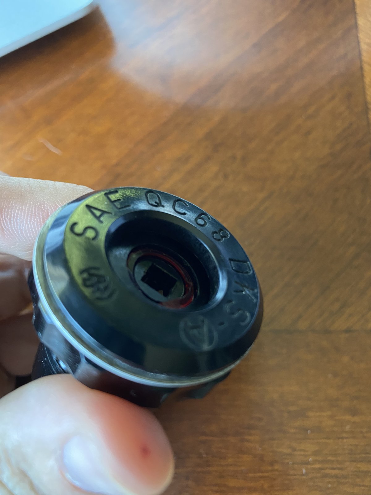

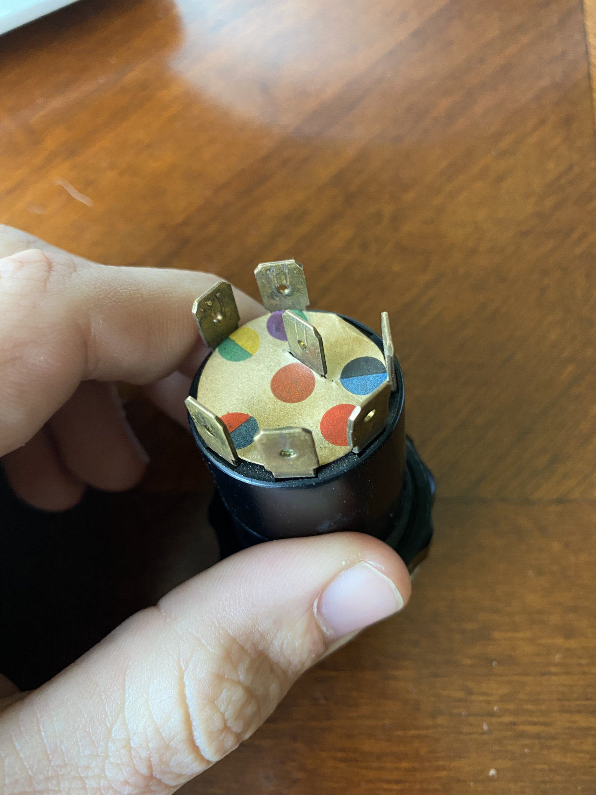

Hey all, after using the search function for a while I didn’t notice anyone who has a hazard switch with seven prongs (like mine). It appears the hazard switch is usually a six prong or eight prong switch. The front of the switch says QC68, not QC69. I’m trying to locate a replacement which has proven to be a little difficult. I’m running into the no turn signal issue and so far I replaced the hazard/turn signal relay, fuses and all exterior bulbs. The car needed those items by the look of each part. Any help on the topic would be much appreciated.

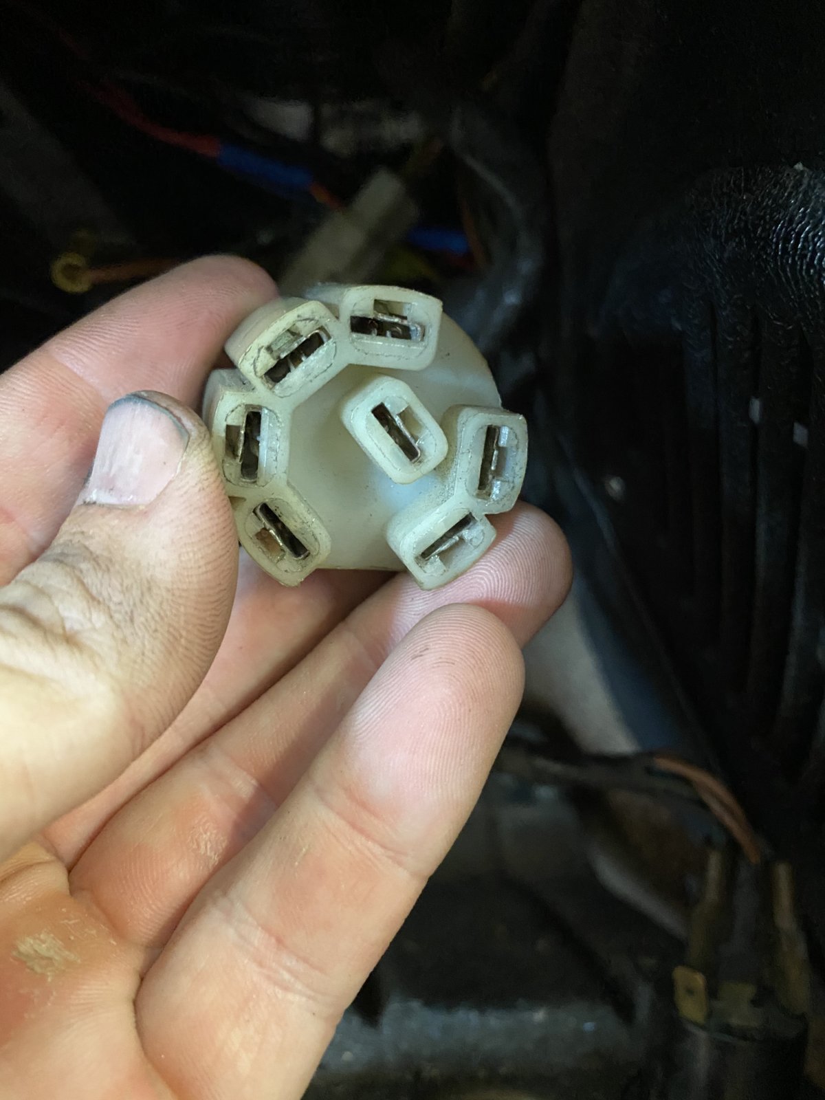

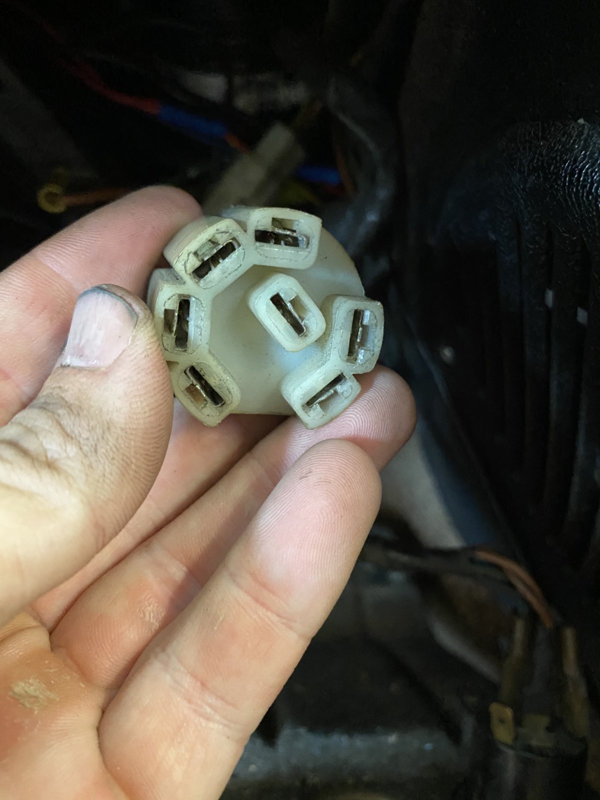

Got a picture of the wiring plug w/the 7 wires on them?
It’s a 1970.

When I bought the car, I was testing everything out and I pressed the hazard switch and then the hazards permanently stayed on. I pulled the fuse for the drive home. I ordered the new hazard switch and plugged it in even though it has one too many prongs. It’s obviously not the correct one and I am not going to use it but it did allow the passenger side turn signals to flash when I would use the indicator. Very funky indeed!
Perhaps obvious tip to get you on the road. When these hazard switches wear out they won't latch "in", or off. If you hold the switch in with tape or wedge it with a toothpick you might find the blinkers work again.

I originally thought the hazard switch was too damaged since the button was getting jammed at an angle if you pressed it in/made a rattling noise. But, it's now fixed since I took it apart, bent that arm and cleaned the contact points.

The turn signal current passes through the emergency flasher switch; if the switch is disconnected, your turn signals won't work at all. If you make a short jumper wire with male terminals at both ends, and use it to connect pins #30 and 49 on the e-flasher switch connector (obviously with the connector detached from switch itself), the turn signals should work without the e-flasher switch connected. It would be interesting to know how things work with that hack in place.
For extra credit, you could check the switch for continuity between its pins #30 and 49 with the button in (should be connected) and out (should be disconnected).
