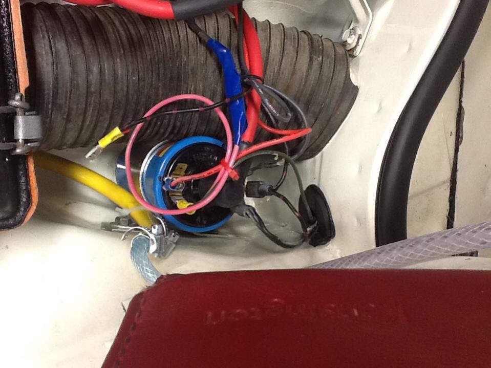

I think I just found a loose connection... The black and spotted red wire on the outlet side of blue coil was pretty much disconnected... Could this have caused these symptoms? This wire used to jump from the top of the ballast to this outlet side of the old coil, now it is disconnected on the old ballast end and I just connected to the outlet side of coil.

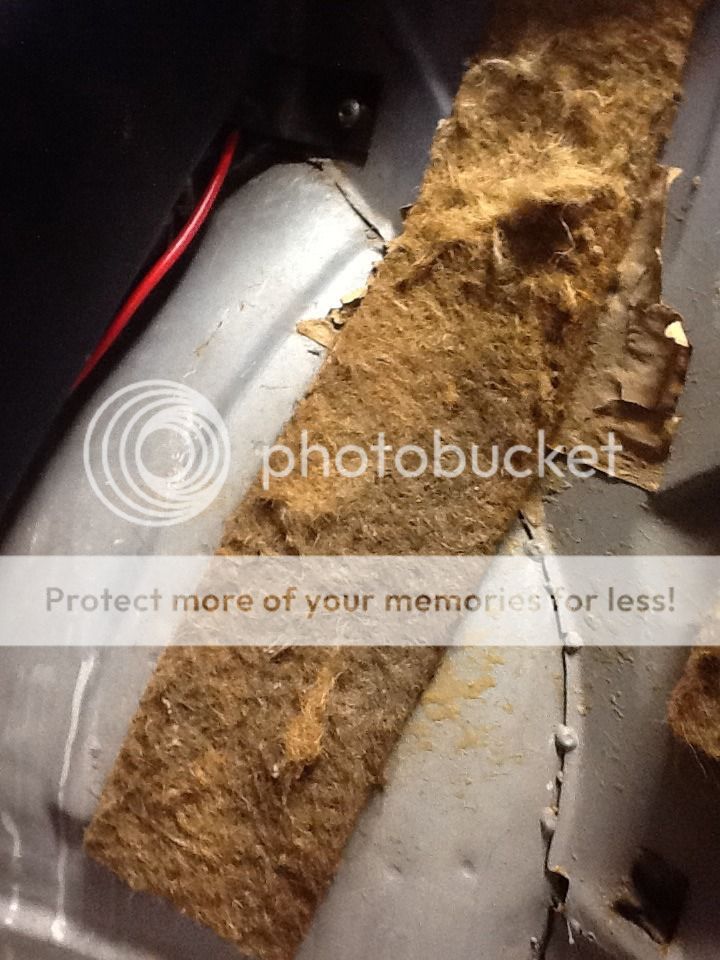

Ok Pamp, I did my chore:
Had difficulty figuring out the best way from ECU to engine compartment, so decided to temporarily go through to the trunk
And while there, double up on ground:
Then I zip-tied to my brake lines underneath and came up through fuel line opening, finally ending up here:

So then I tried to start her up; just kept trying to fire. Had fuel pressure, battery, so I checked the coil wires again. My black and red-dotted wire that used to connect to my ballast then jump to the negative side was plugged in only to the negative side, so I tried to study my new laminated diagram:
And got confused... Made an idiot mistake and plugged the old ballast feed into the positive, tried to start up, saw smoke, came back to the coil:
And quickly unplugged both -- black and red-spotted #16 insulation melting in my fingers...
****. Looked at the diagram, tried to figure out what I need the #16 plugged in for? Not understanding why; goes to starter on one feed and used to goto ballast and feed speed relay 1 (?) and 2... I don't get it. I went back and tried to start it -- fired right up! That is with the unplugged #16. What am I supposed to do, leave it unplugged? The old ballast (or "resister") connections I guess are plugged into the positive side of the coil now but #16 is just flopping in the wind... Should I have left my resister in for these "Speed Relay 1 & 2"? Do these speed relays need #16 connected to them to communicate with the ECU? Hmm...
