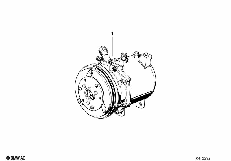

    Per all the feedback it looks like a Sanden SD-510HD compressor New - unless there is another better choice??

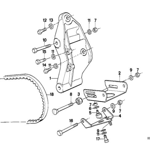

    Please review the attched photo of the bushing I am missing - any Ideas?
  17. Stevehose
    Stevehose Well-Known Member Site Donor $
    View My Showcase
    Messages:
    8,794
    Likes Received:
    1,185
    Trophy Points:
    113
    Location:
    New Orleans, LA
    Hmmm not offhand, perhaps remove them and measure then try a place like McMaster Carr to see if they have something. Perhaps others here have ideas.

    That is why using the York bracket should be your last resort. I have been told you can take a poly alternator bushing and turn them down on a lathe to the right diameter. Mesa Performance offered this suggestion.

    Well Gentlemen I have a 528i bracket see attached - no bushings and per the forum not too much to adapt the Sanden compressor to the bracket - maybe a better way to go?

    ac1.jpg AFTER LOOKING AT MY SYSTEM I USED THE STOCK OEM M5 COMPRESSOR
    FOR THE S38B36 IT WORKS WITH THAT MOUNT WITH A TOP BRACKET
    MAKE BOTTOM AND TOP BRACKETS FROM THE EXTRA PARTS
