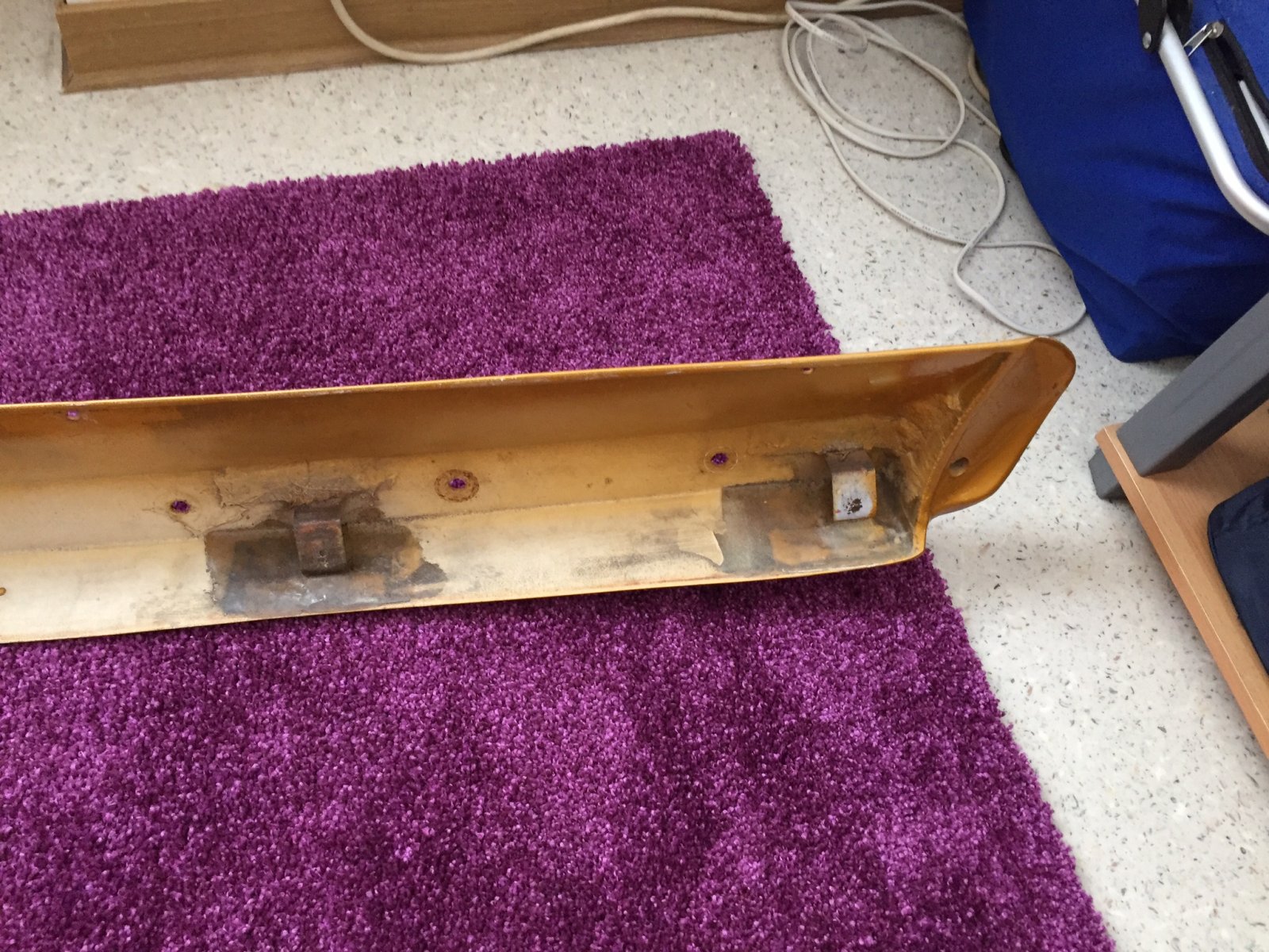

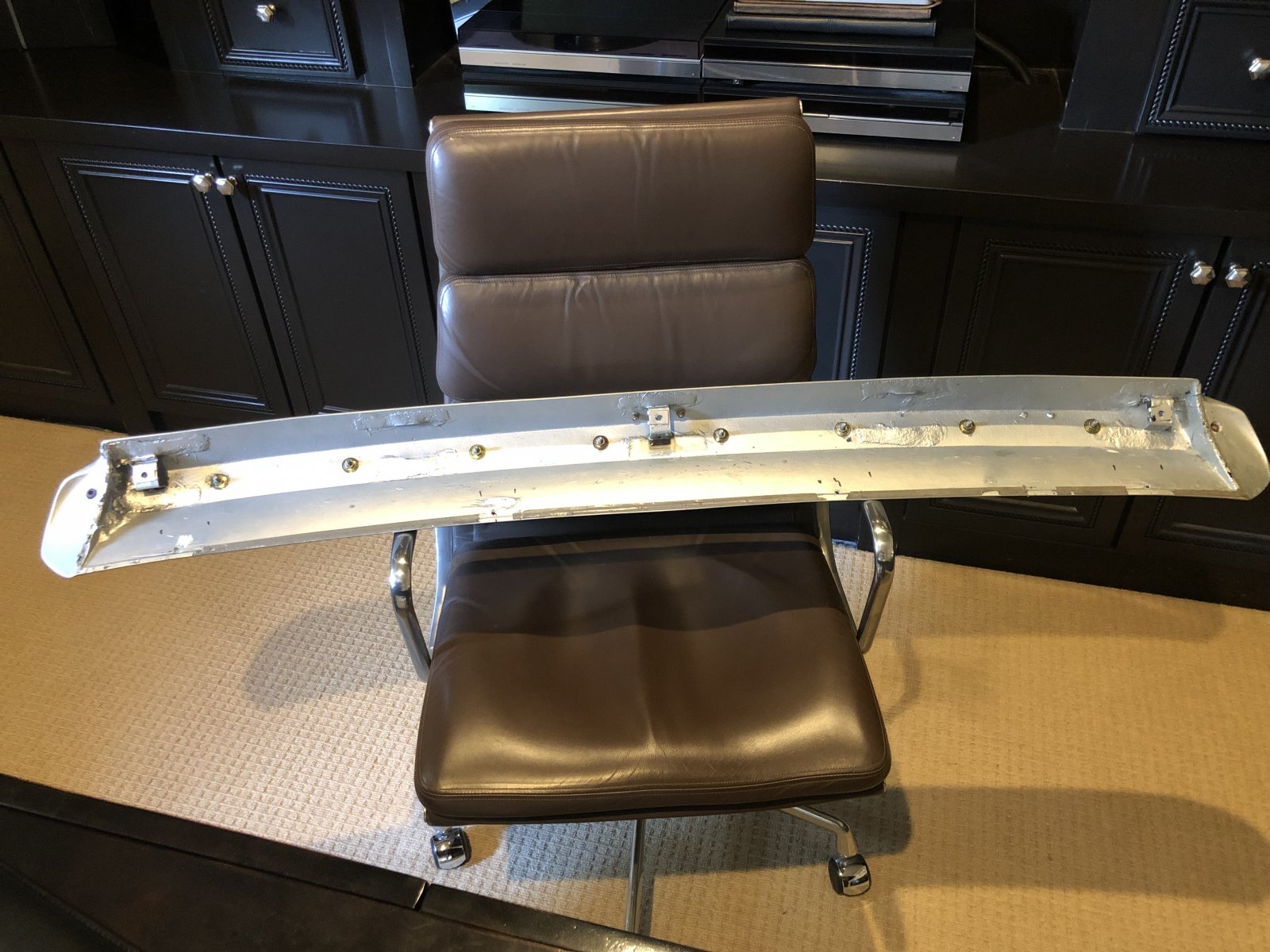

Every expert member I've consulted agrees that it looks to be OEM, with two easily replaced brackets gone missing, probably deliberately. It has the unobtanium correct rear spoiler roundel in 3d form. I'd like to run it on my CSL if it may have been factory delivered, otherwise not.
Opinions appreciated on chances it was on there, and any knowledge anyone may have as to when they were 1st available etc:

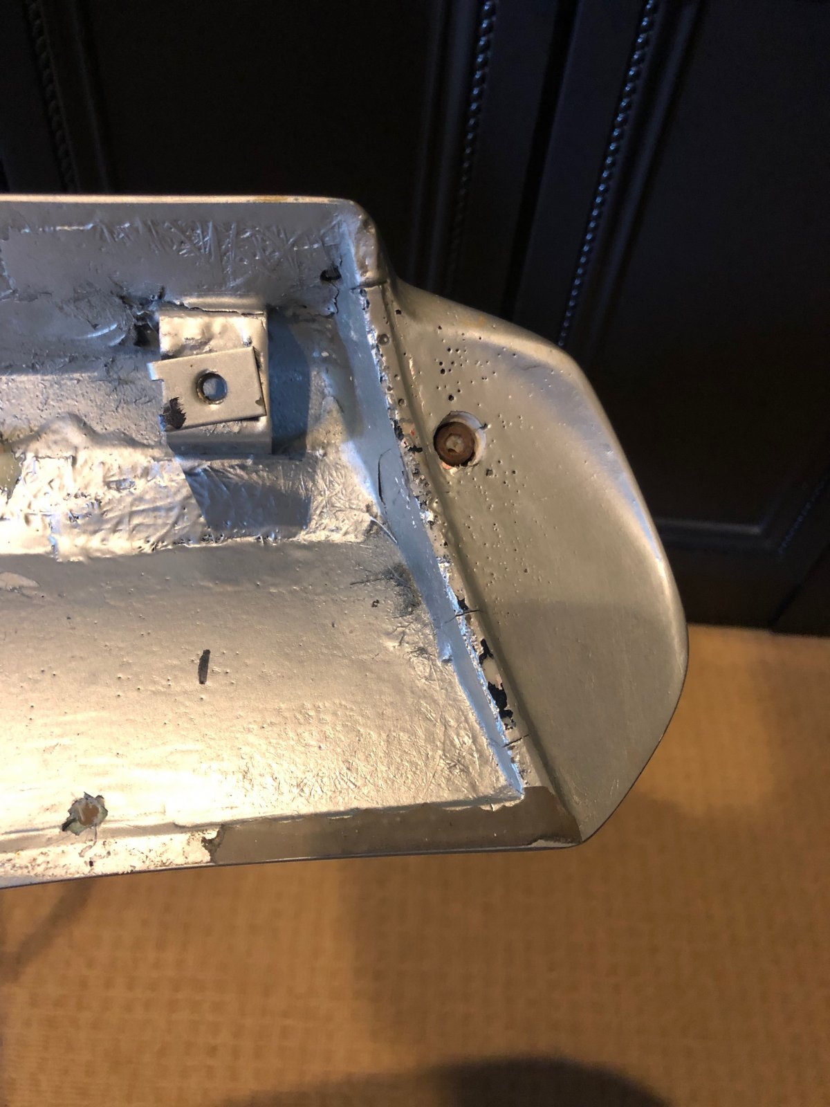

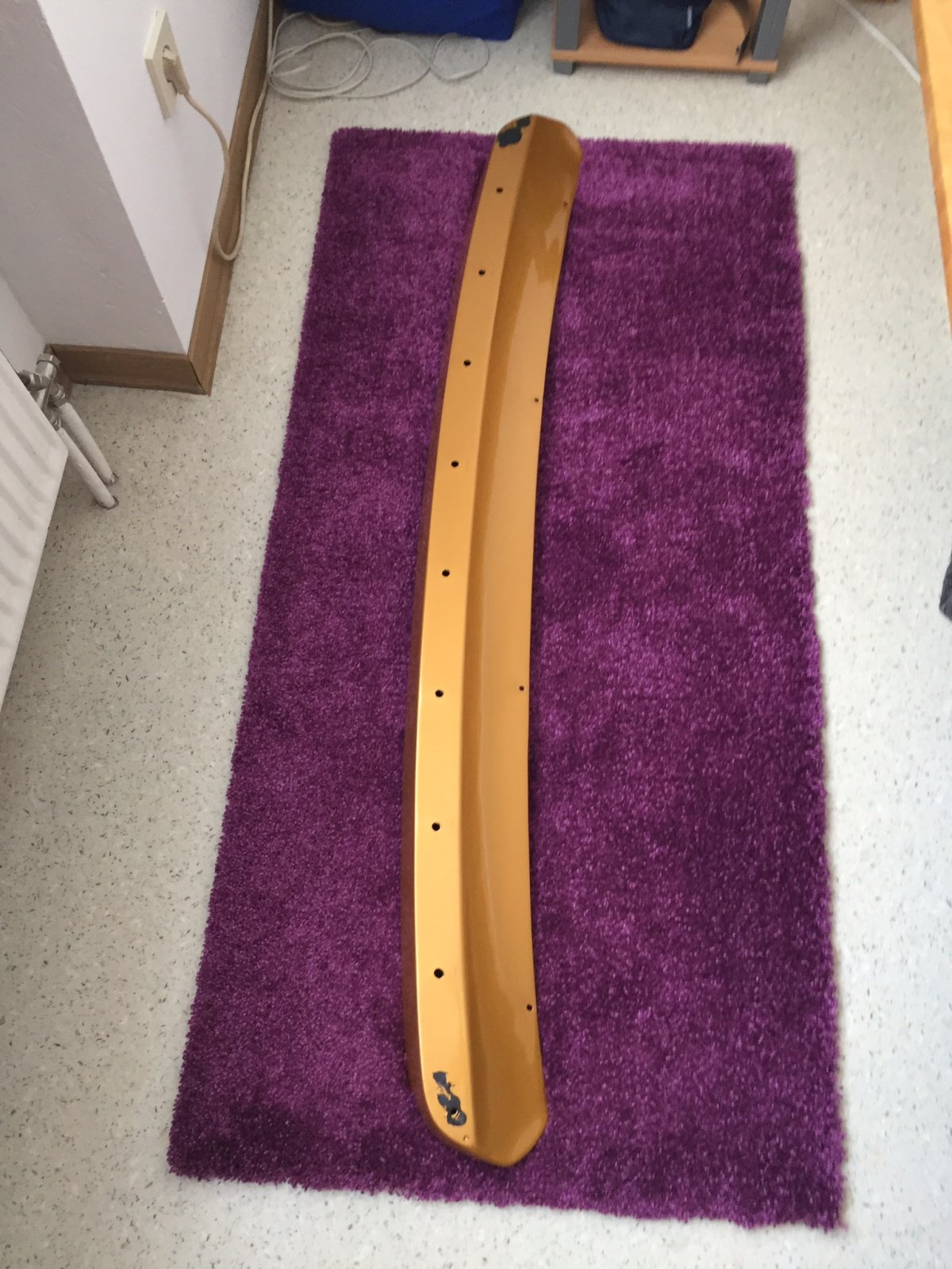

On this smaller spoiler, the 4-5 I've seen, I've seen consistency on the screws along the top edge (a not particularly esthetic solution) but have seen some weird mounting solutions along the rear edge, especially the corners. Wondering if there was a "factory way" with special screws/bolts, or the whole thing was somewhat jury rigged by owner/dealers.

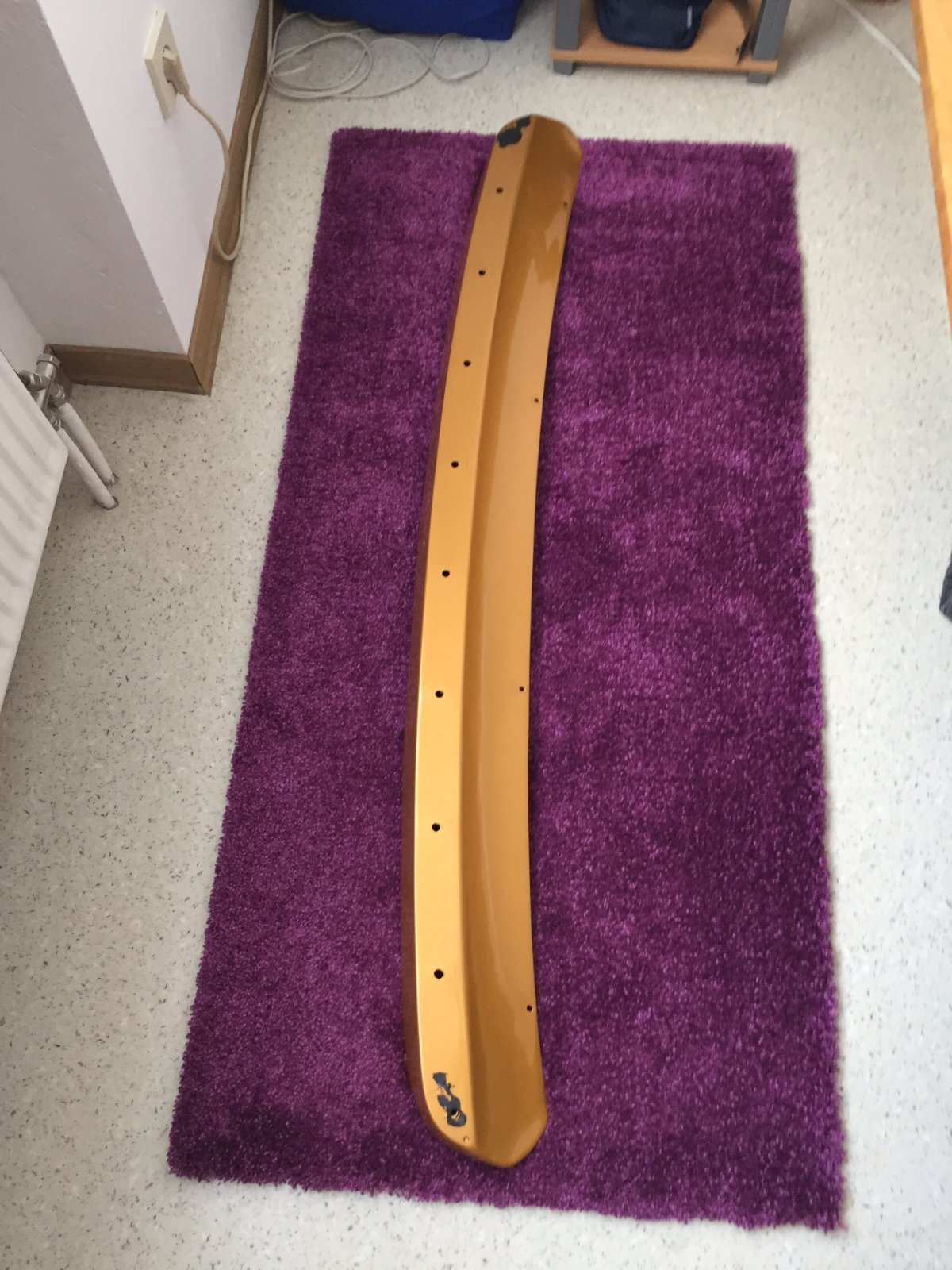

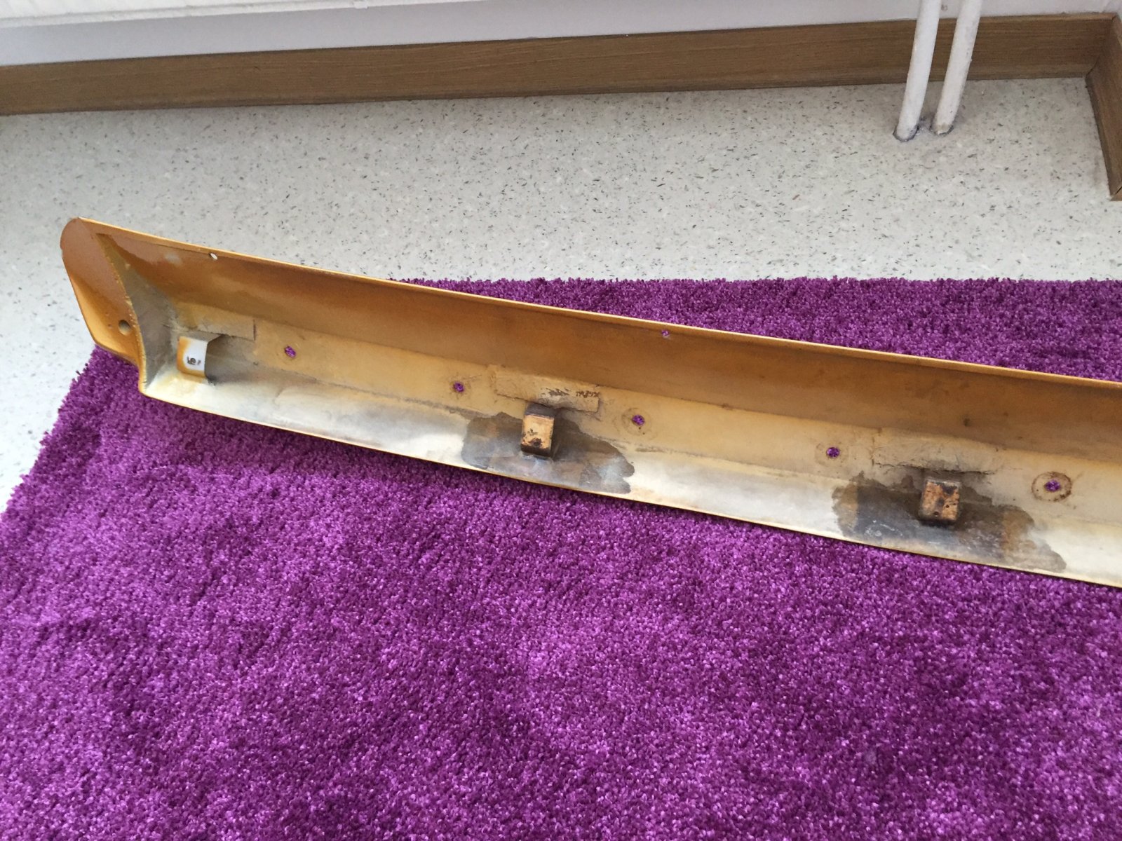

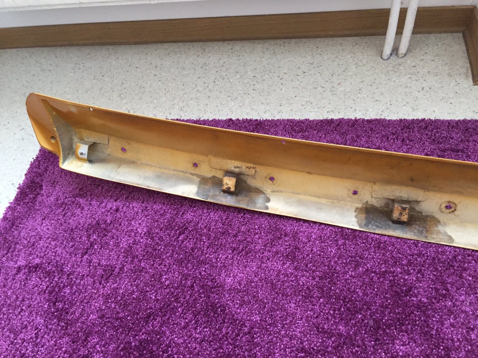

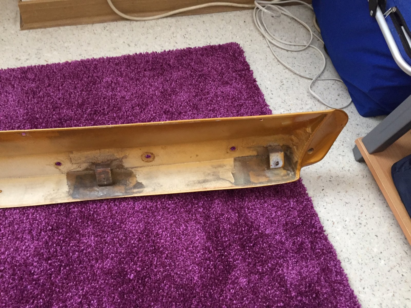

The small ones were mounted by BMW if ordered on a new car. 4 screws on the top part and 5 at the bottom end from the inside of the trunk and into the spacers as seen in the pics. Today one would only stick it on (I used look alike screws not wanting to damage the Alloy trunk).

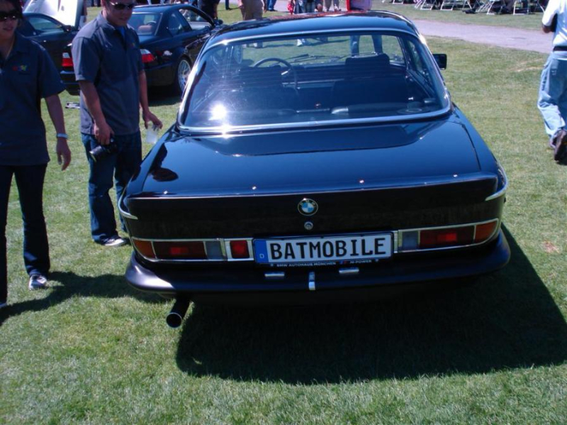

The large wing was only for the Bat’s, 110 first series and 57 second series cars found it the trunk. And that too only if the car was ordered with that spoiler package from factory. Those cars also had steel trunk lids to take on the added weight and the downforce created by the big wing. Apart from the big wing, the rest of the spoiler package (front spoiler, rear small spoiler and roof hoop, possibly also the wind splits) were found on non Bats too, via the factory depending on what configuration was ordered.

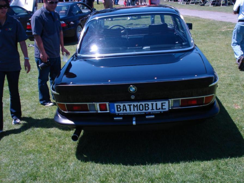

This black Bat Csl has a factory small spoiler and the large wing in the trunk......

Questo Bat Csl nero ha un piccolo spoiler di fabbrica e la grande ala nel bagagliaio ......
