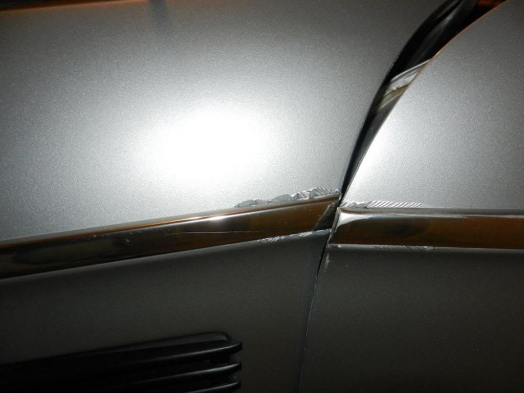

guys -
here are the worst pics of the car - the belt trim at the doors (both) and the only significant rust i found on the car (small piece within the rear fender well). along with the best looking rear side of the firewall i've seen on an unrestored car. and very clean fender wells (rust wise).
if the owner fixed these minor issues, might be worth the money.

Wow! The paint work is scary looking. Looks like the paint will peel off in one piece. Appears to be a single stage paint failure and not the clear coat that is flaking off. Think he will get half what he is asking.

Bert,
that's the worst 2 inches of paint on the entire car. it could be repaired easily. this is the best unrestored original car i have seen (overall)- period. perhaps there are some in california that are just as well preserved - but precious few.

Well Scott, I respect your judgement. I stand corrected. Hope he gets his asking price. Thanks!

Bert, that's why i wrote that those first 2 images were the worst pics of the car. both are areas less than 2 square inches. believe me, i crawled underneath it ... i looked everywhere i could. when i first saw the ad, i went to look at it for me. it has several things my coupe does not - an original engine and a sunroof. i learned that it was an auto conversion - so is my 2800cs. if this car had been a stick vin we wouldn't be having this conversation ... we'd be talking about my black '71.

Clean looking car
guys -
here are the worst pics of the car -if the owner fixed these minor issues, might be worth the money.
That looks like a great starting point! The pulled paint is minor and I agree it could be touched up with an invisible localized repair. Did you feel up in the front fender pockets to see if they were smooth inside?
