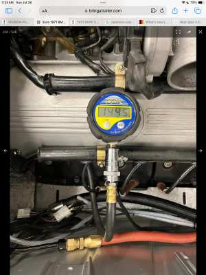

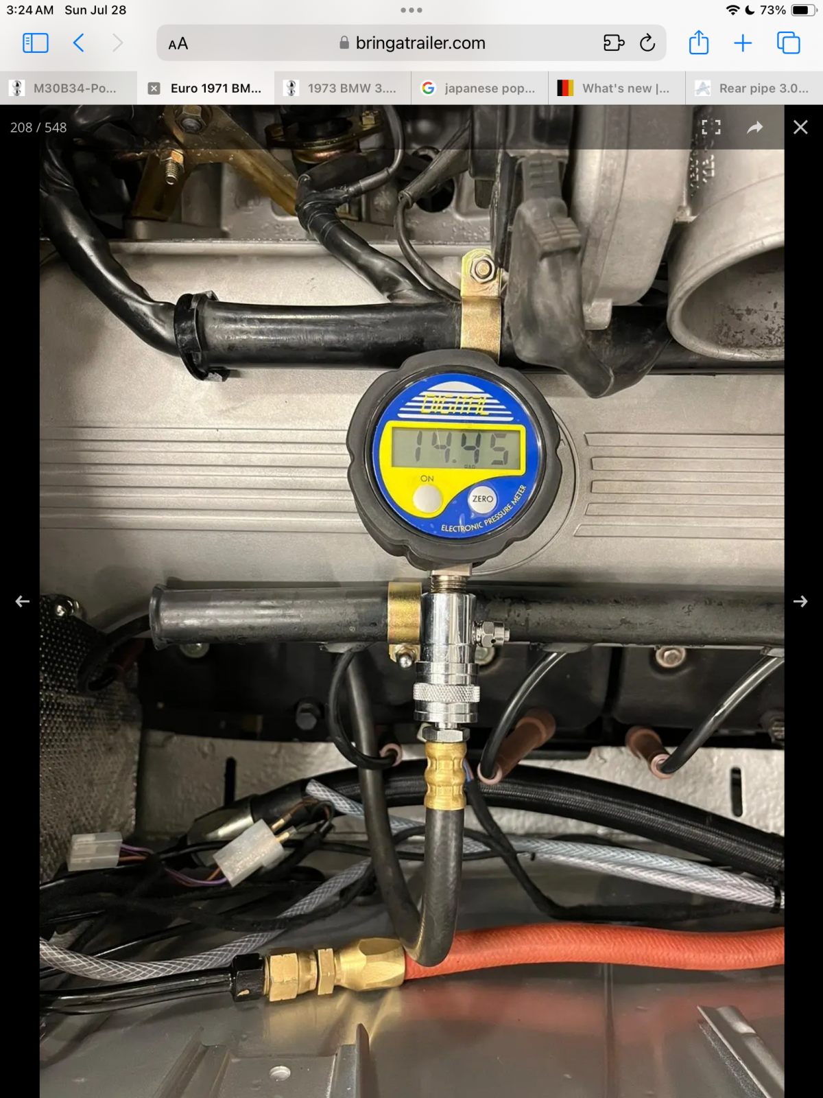

We opted for original BMW pistons specifically designed to complement the engine's original specifications. Our primary goal is to maintain the integrity and excellence associated with BMW engineering. In this case a M30B34 engine with a 10:1 compression ratio resulting in a compression of approx. 10 bar / 150 PSI.
Our engine builder has 30 years of experience with BMW M30 engines and he determined that decking the block was necessary to restore their surfaces to factory specifications. This process ensures a perfect seal at the head gasket.
Given the adjustments from decking, and selecting the OEM correct pistons we have matched the original performance metrics of the European BMW M30B34 engine, 3.4 liters and 218 HP. As you could see on the pictures of the compression test, we achieved the correct compression ratio.

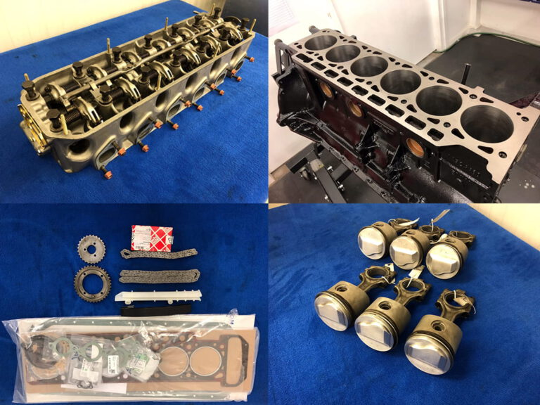

Suggest you look at your own website to remind you of what a piano top high compression piston looks like.
10;1 pistons are about 200psi compression.
10:1 piano top pistons look just like the ones on your own website.
I sincerely hope you just got your photos mixed.
OK- I posted on BAT. You have co-mingled pictures of early and later engines in your ad.
you need to fix this. Coupes don’t have 2 fuel pressure regulators.

1. Clarification on Piston Types: The pistons featured in the images on our website are general pictures for the BMW E9 3.0 CSi engine and not for the BMW M30B34 engine in the Granat Red BMW E9 in our current auction. The M30B34 engine from our BMW E9 on BaT uses correct OEM BMW pistons designed for its specifications, ensuring the achieved compression pressure of 10.0 bar (approximately 150 psi). The images shown are with a cold engine.
2. Compression Figures: As mentioned, our compression tests yielded a consistent 10.0 bar (150 psi) for the M30B34 engine. This figure is appropriate for the high-compression version of this engine model. We understand that higher compression pistons can yield higher compression figures, but our results reflect the specific configuration and condition of this particular engine after precise decking and piston selection. As stated on BaT, reliability of the engine is key.
3. BaT Image Mix-Up: We made a mistake by mixing up the photos on BaT from another engine, and I apologize to you, all members here on the forum, and those following our Bringatrailer auction. With several projects here in the workshop, we strive to document everything correctly and be fully transparent about all the components used for this E9. This mistake should never have happened, and I am fully responsible for this.
I will add two extra pictures on BaT to ensure that the engine is correctly represented to prevent further confusion and correct our mistake.

Eric, i am no engine expert, but 10:1 compression should translate to somewhere around 190 / 195 psi in a euro m30 b34. i own one of these engines. the 150 psi number seems more indicative of a 8:1 compression engine - standard 3.0L m30 engine.

"The pistons on the B34 engine are either an 8:1 low-compression piston, or a 10:1 high compression piston. The 8:1 pistons have a deep dish, and are cleary recognizeable. The 10:1 pistons have a dome, with a grand-piano-esque shape.“
