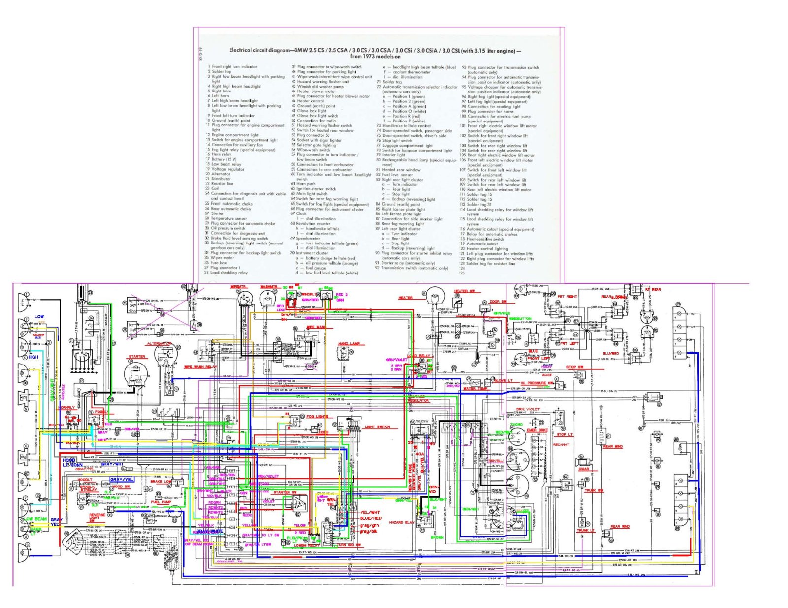

IM AN AN EXPERT ON THIS ONE
so the first thing to do is open the back zipper to expose the motor and transmission.
pull the switch to get access.
check you have power to the switch w/ the car on of course
it goes to fuse 10 if power . then connect volt meter to roof motor
hit it and see if votage most likey yes. or maybe no - most likely its just a corroded contact
then test motor motor to see if it goes
if it does -then it would be the transmission
test em and post again
also u can use a window switch to test that part
ok
