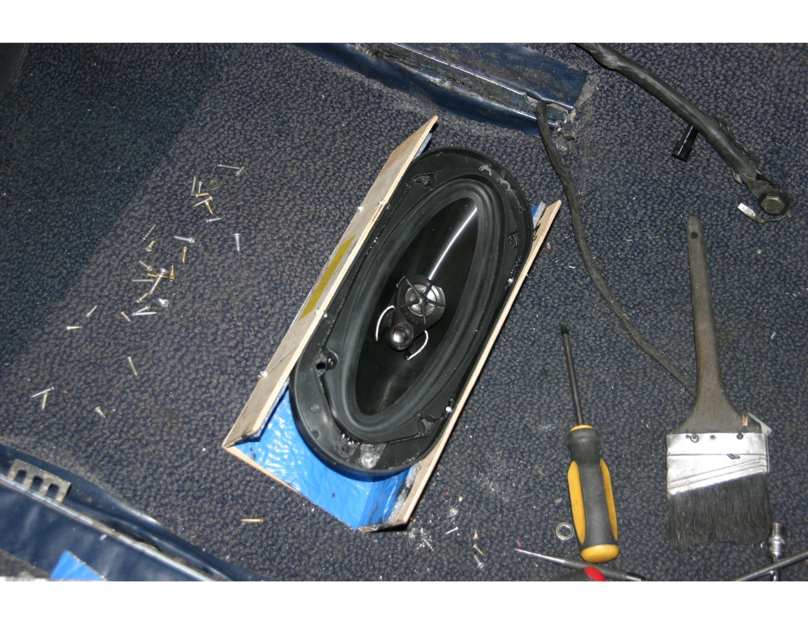

HI ROD I THINK I MAY HAVE PHOTOS
YET THE OEM HAS RAISED PORTIONS THAT RUN UP THE SIDES OF ALL MOUNTING AREAS WITH A VINYL TRIM ON THE EDGE
I FING PIC
