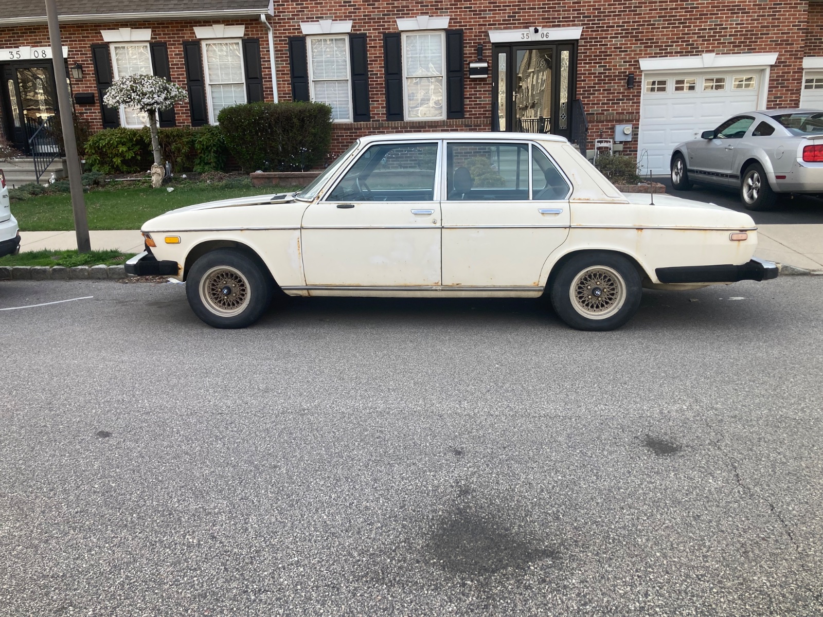

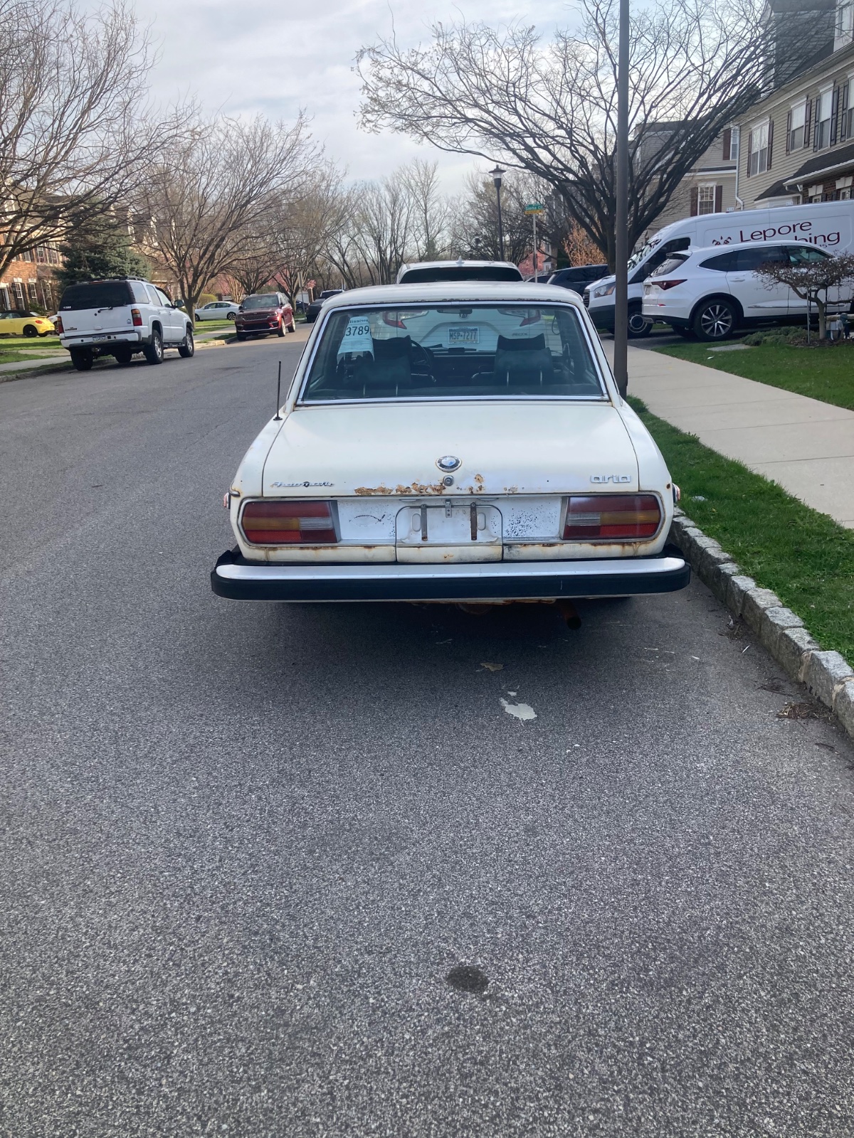

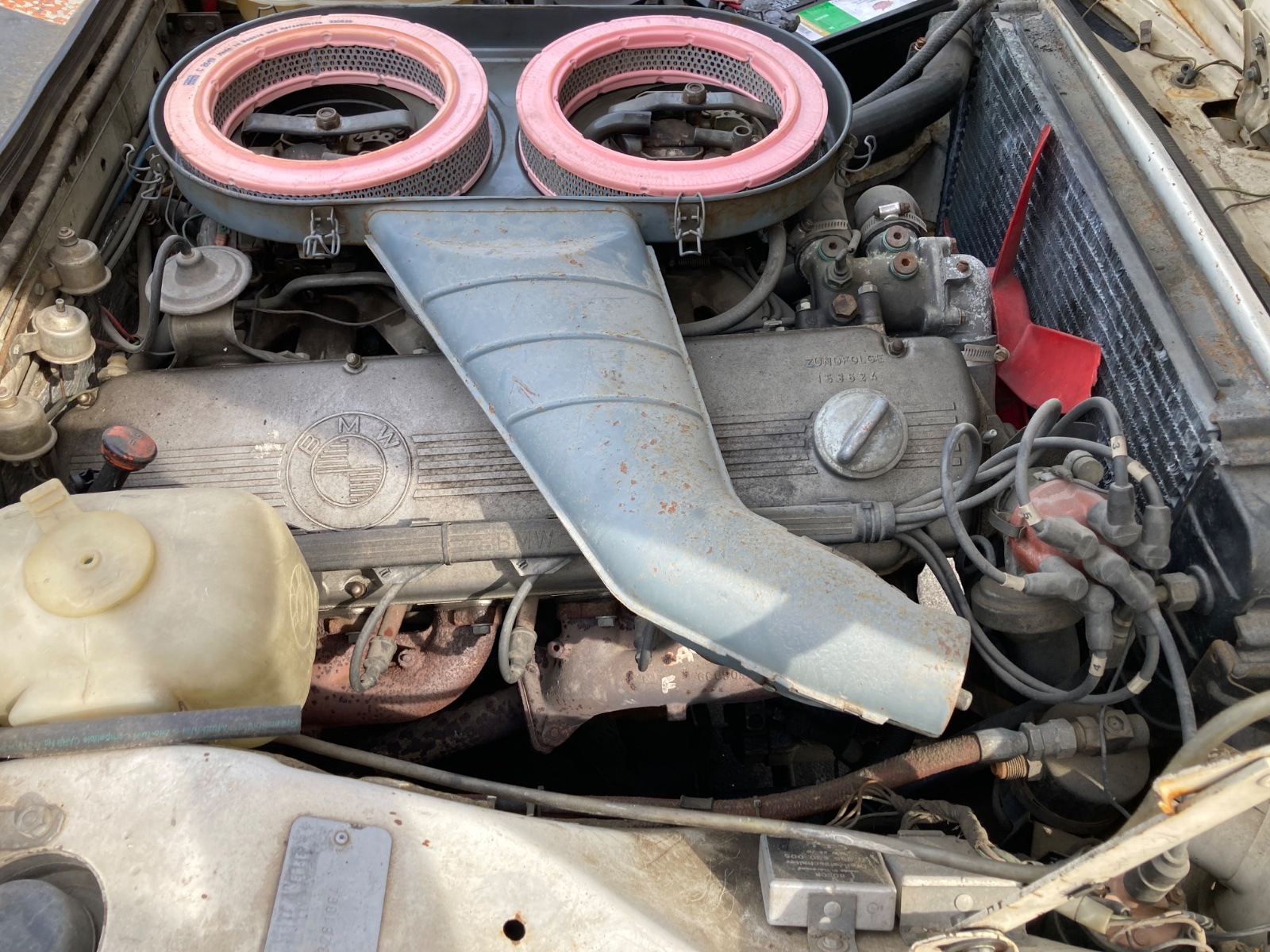

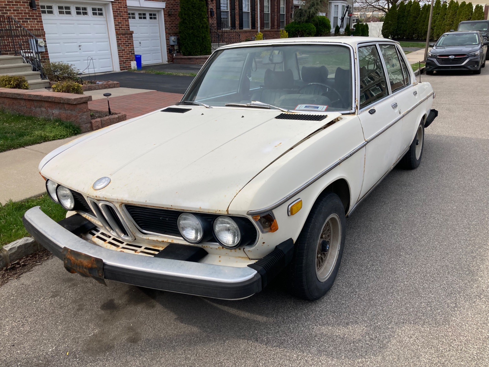

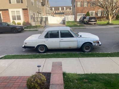

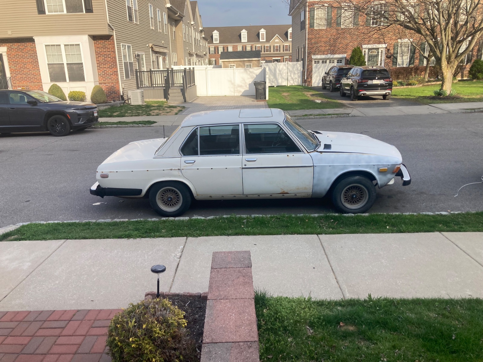

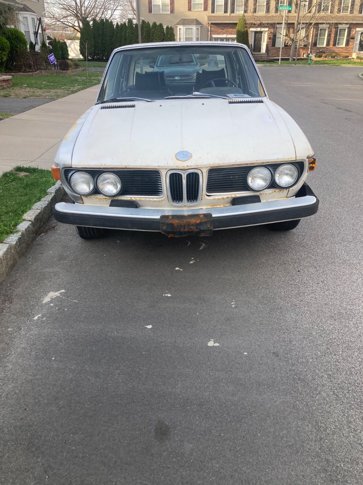

Here’s a few pics, my not so short short list. NOS or aftermarket radiator, front and rear windshield seals( some I’ve seen some outrageous$$$), side view mirrors. And whatever it takes to get the engine running properly, tune Zenith carbs, spark plugs and consider replacing points with electronic ign., check for vacuum leaks. replace or re-key doors and truck lid locks. repair or replace driver side window regulator( manual). The car Sat for about 10 yrs. The previous did a rebuild on the engine, early 2000s. Although it runs rough it’s very quite no valve lifter noise!

Good thing there is no lifter noise as you don’t have any! Change plugs and wires, Pertronix is a good choice, and all fuel hoses (a search here will help you). Good luck!
You could also have your existing, original radiator recored by a local shop. The front and rear windshield seals are going to be tough. Periodically, aftermarket producers run small batches of both. Keep turning over rocks in your hunt. Develop relationships with enthusiasts here and especially in Europe where these cars are most popular. If the car has been sitting for 10 years, the carbs will probably need more than tuning. Rebuild kits are available.

Getting old and not thinking this early 70s engine is a OHC, never the less she’s quiet. Thanks for the tips!
