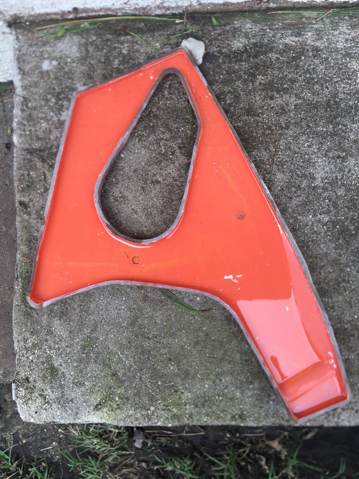

Here is the first half one panel. it was very difficult to unmould.
The hex you see in the photo was an aid to help separate, but will disappear in the final parts.

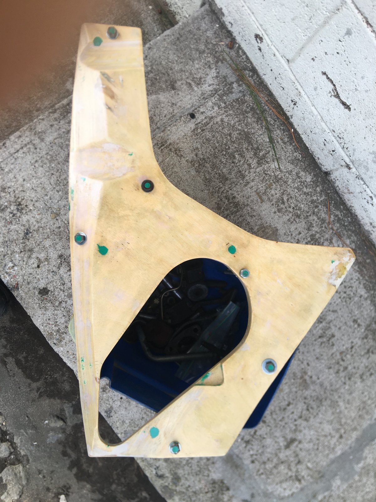

New side panel Mould being produced.
We had not worked with wood (TP) in a mould, a lot of varnish, then wax to aid in removal.
Now we use bolts to separate.
Regards, Alberto

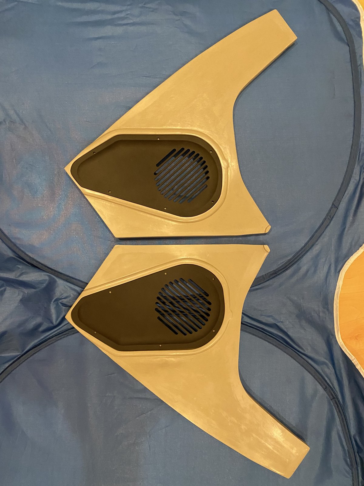

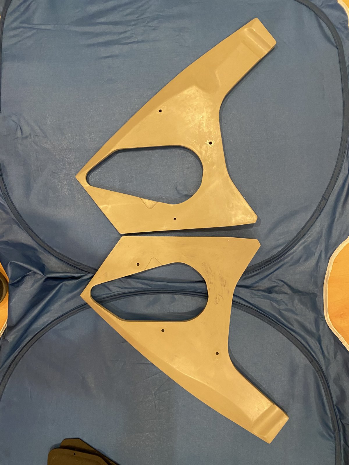

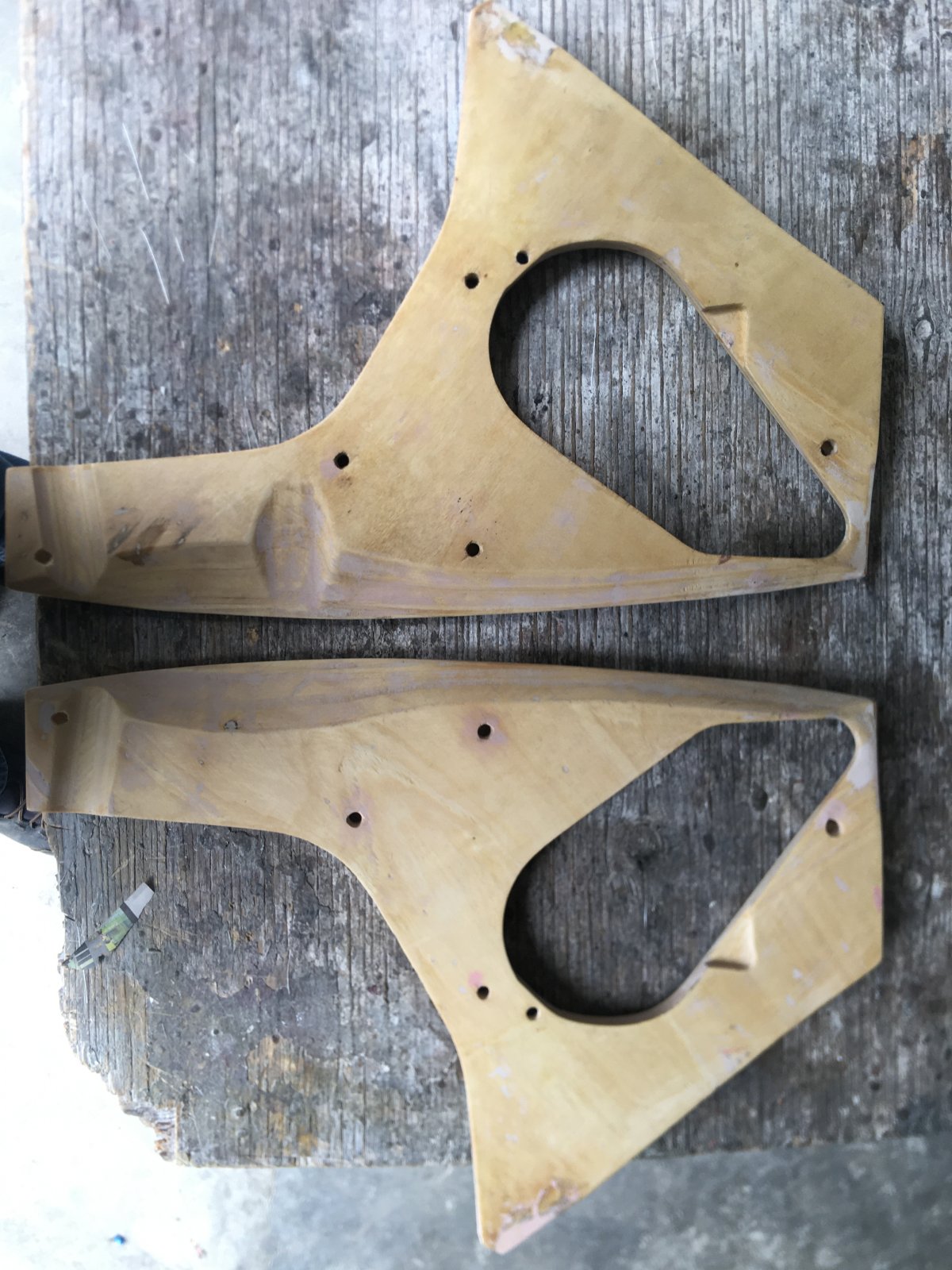

Shown, are the 2 restored sides ready for mould making.
Holes shown, would only be mild indentations, ready for drilling.
Otherwise, they would be a 100% perfect replicas, with the large vent openings included, ready to be upholstered
Regards, Alberto

1. repaired the reasonably decent, original, samples, refinishing the surfaces by sanding and varnishing
as the release agent will not unless 99% smooth, and even then...
2. Pulled the 2 moulds. The samples would fall apart unmmoulding, these original parts had been made with a mix
of Plywood, papier mache, TP, and some glue to give it the XYZ shapes. The originals were somehow made in a mould.
No way, were these parts made one by one as by a carpenter. Had to repair moulds as the parts that stuck, were embedded.
3. Experiments: made one totally solid, and the other with 3 layers of matting. The 1st one was 1 Qt. of resin , ridiculously heavy.
The second one (always 2 parts to a side) with the 3 layers, turned out to be the winner, albeit kind of hefty. The ones looking for lightness,
skip a burger or two for a month. Gluing the 2 halves together, another story, very good results.

Such a crazy difficult item to make.
I remember peeling the vinyl off one and saying Oh Crap!
8 layers, multIple angle changes, soft shapes, hard ring on one side.
I can see having thousands of dollars into making the first set.
I saw them today and the workmanship is amazing. They weren't that heavy and all the 3 dimensional bends and curves look spot on. Definitely a complicated piece. There's a lot more to them than meets the eye, for sure!
