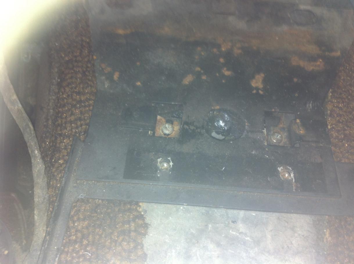

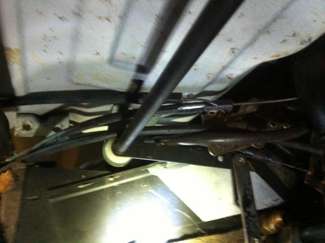

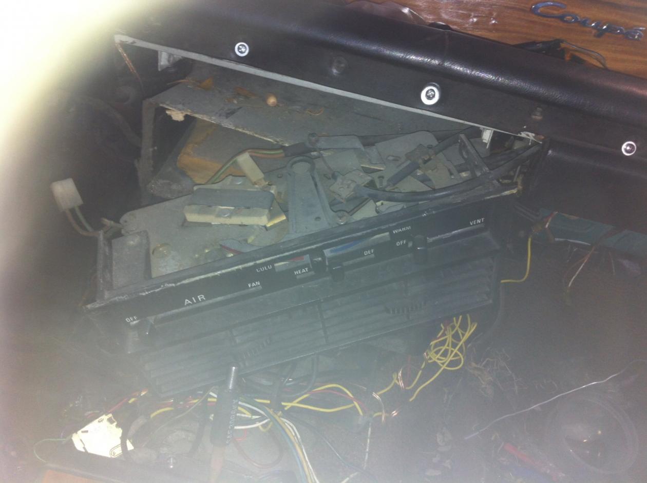

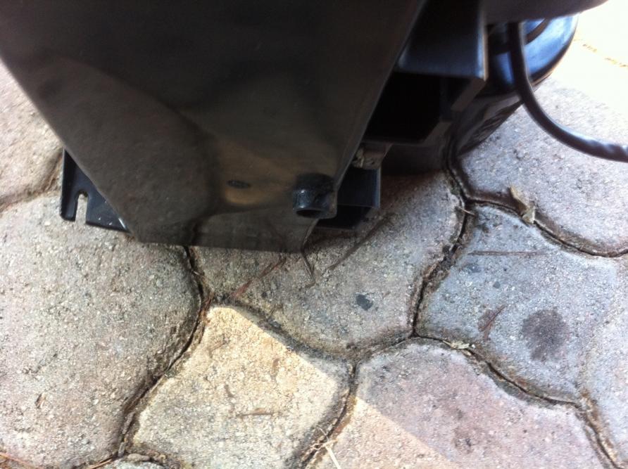

Chris,
Having recently removed and re-installed the evaporator I can confirm it is a major PITA.
If all you want to do is to replace the two hard lines connected at the evaporator then you do not need to remove it.
If you want to remove the evaporator then yes, you will need to disconnect the Bowden cables (4) AT the evaporator. Once this is done, you will need to lift the evaporator about 1/4-1/2 inch and pull it out.
The reason you need to lift it up is so that the drain plug from the evaporator is lifted out from the drain hole. I had used a long thick screwdriver for leverage to hold it up and then pull out.
I suggest you take pictures of the position of the Bowden cables vis a vis each other and where they are connected or mark them. You may not remember which goes where as two are fairly close in length.
To disconnect the cables you will also need to remove 'clamps' that hold them in place. When removing those clamps (not easy) they may get slightly distorted making it hard to re-use. You may want to buy new ones beforehand just in case. I had provided pictures ( provided by Bwana) of those clips in a post I made about 2-3 weeks ago.
I would try if at all possible to not disconnect the Bowden cable thats located all the way in the back. Its hard to reach making the reinstallation difficult. You may not have a choice though.
One more point, when you remove/pull out the levers control box you may inadvertently disconnect the electrical "plug" connection for the heater blower. Just be mindful of that when re-installing.
Personally I found it easier to work by removing the glove box.
At the left in the 1st picture you'll note the white electrical plug for the heater blower mentioned above.
The 2nd picture gives you an idea how/where the cables are located. The 'bar' is what you see with the glove box removed.
At the bottom of the third picture you will note the drain plug/protrusion from the evaporator. It needs to be lifted out from the drain hole.
The last pictures is that of the drain hole above the transmission for the evaporator.
Hope this helps.

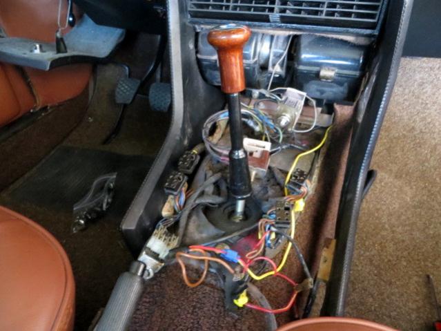

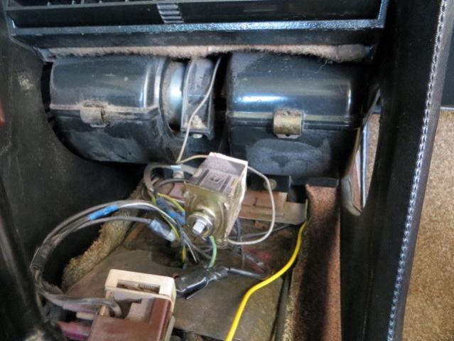

After I got all this working I found that the temperature control switch with capillary tube would not do its job of turning the compressor off and on therefore my evaporator would freeze up.
BMW shows one for the E9 and I ordered one and took on my trip to Ofest.
When I had some time I was going to replace it only to find that it won't fit the space behind the grill when it is mounted through the hole for the knob.
I zip tied it there so I could have a working AC but will now have to find some other alternative. I think Vintage air has a possible substitute.
HTH
Gary
I have a new switch with tube if I need it as well. I turned the old one on its side so it wouldn't interfere with radio. I may do expansion valve while I'm in there. Again, cables do not need to be disconnected.
I did have to disconnect some of the cables. Like said take a picture and if careful with clips all will go back. Yes BIG PITA.
Check fit of new switch while grill is out. I think you will see what the problem is?
