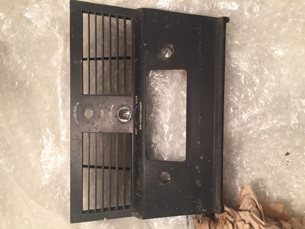

I managed to find an uncut radio faceplate. However, the surface is pitted. Has to be bead blasted - what would you suggest is the best method to replicate the factory finish? Powdercoat? A type of paint or method?

I've been using a truck bed spray paint but it is a bit too textured. I think Alan recommended using a tooth brush to splatter on extra paint after you have your base coat. I will be experimenting soon with my final revision of the :D printed plate. I'll probably paint it in a few weeks.
This is the rustoleum truck bed rattle can..
looks like a satin slightly splatter. SEM makes great satin, perhaps over something that gives the texture.

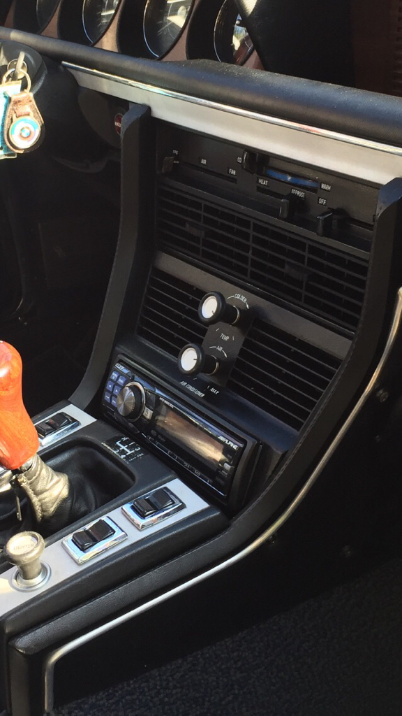

This is the existing along with nasty shift knob that must be glued on with epoxy!
Maybe if you sanded it down a little before top coating it would flatten out some and still keep a just a little texture?

It almost looks like "hammered" paint. so may try that next.
Edit: If you look at my second iteration of the 3D face plate, it is in fact hammered paint. Still a bit too much oarange peel IMO.
