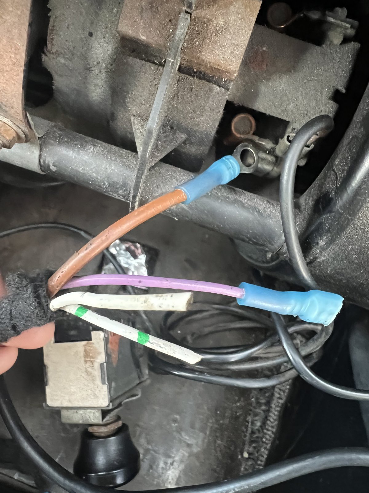

Hi everyone, I have reached the final stages of my 72 csi’s wiring.
In the pictures below there two groups of wires, one for the radio and the other presumably for the ac.
For the radio, the brown wire is ground and the purple is power, what about the white and the white/green?

I've been dealing with the wiring in my car too, including the radio wires. Mine looks like what you've pictured. According to the wiring diagram in the blue book, the two white wires are for the optional rear speaker. The strange thing about this is that I can't find any reference to the connectors for the front speaker. Seems odd, but there you go. I haven't tried real hard to trace the white & white/green wires yet, but they don't seem to be painfully obvious in the back of my car. Could be there though...
I'm probably going to mess around with it some more tomorrow. I let you know if I find the other ends of them. In the meantime somebody will probably jumped on with a more complete answer than mine.

Ok sounds good, thanks for the info

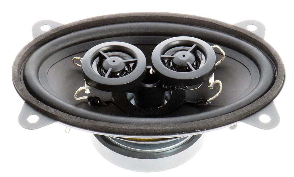

2) since this is a stereo setup, what should I put behind the original speaker grill? I had heard that 2 3.5in speakers have been made to fit. What about this it is 4 dual voice ‘stereo’ speaker

Alright, any thoughts on speakers that will fit in the stock location upfront, I have read in previous breads that people have stuffed two 3.5 in speakers in that spot, any other ideas?

I already have two speakers in the parcel shelf, my thinking was that I could get both left and right (like you said information from both the right and left channels) without cutting my already finished side panels or door panels
That certainly makes sense then! That speaker you linked to with the two drivers seems like an interesting solution as long as it fits.

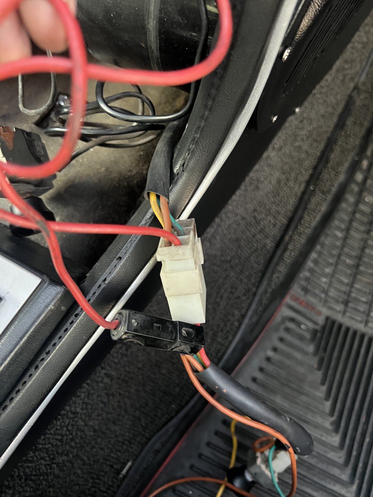

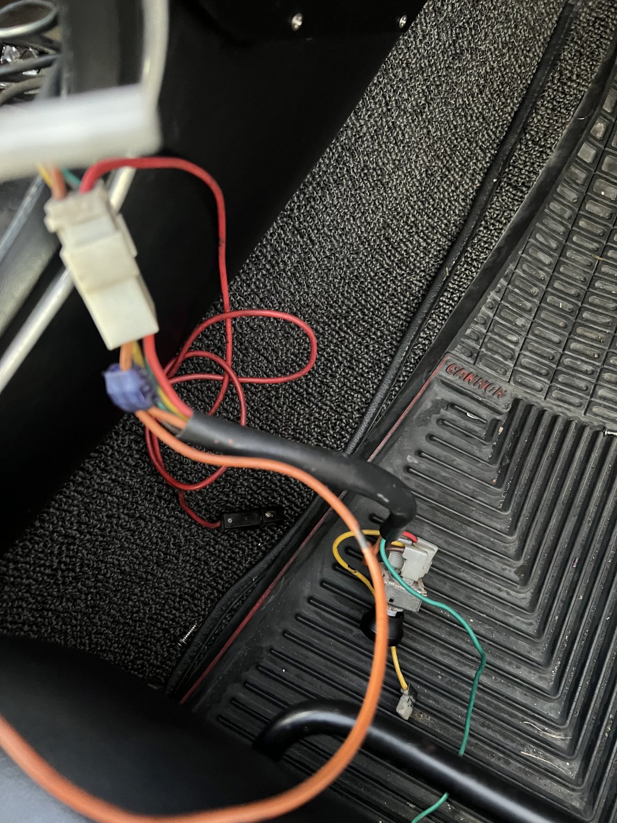

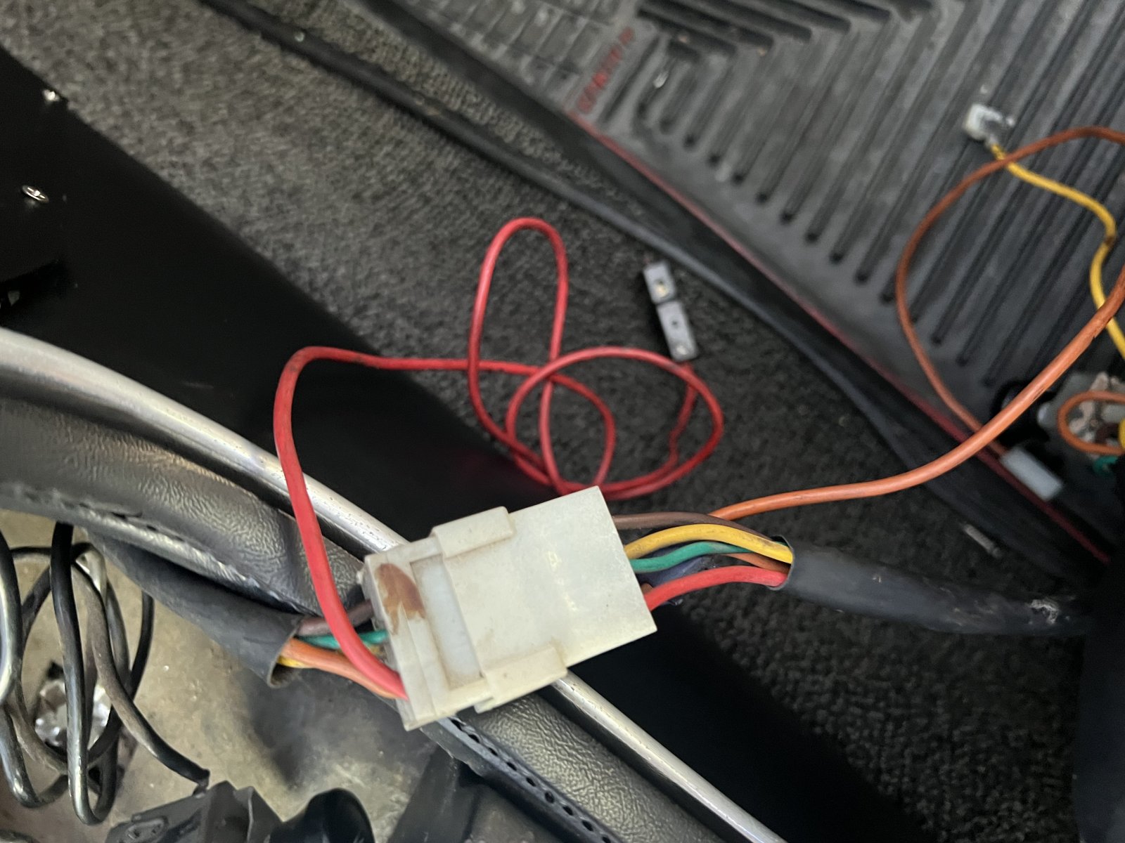

1) this connector separates the harness that runs into the eng bay
2)

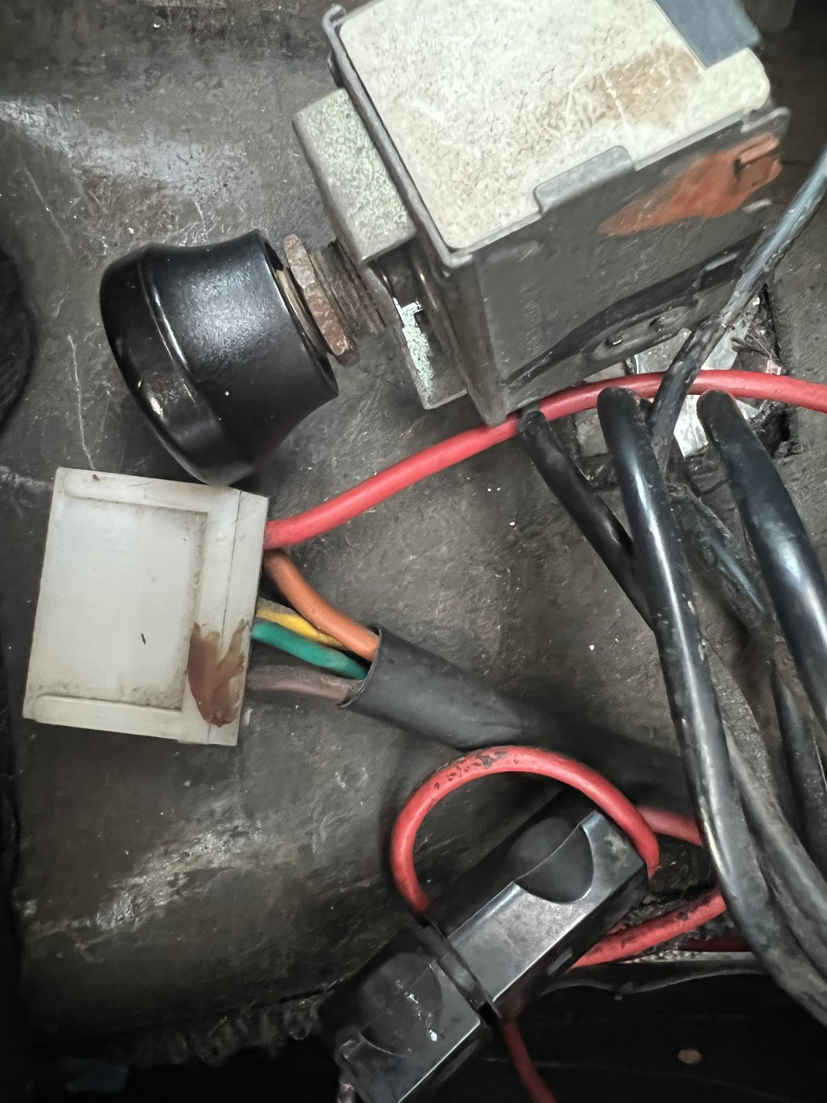

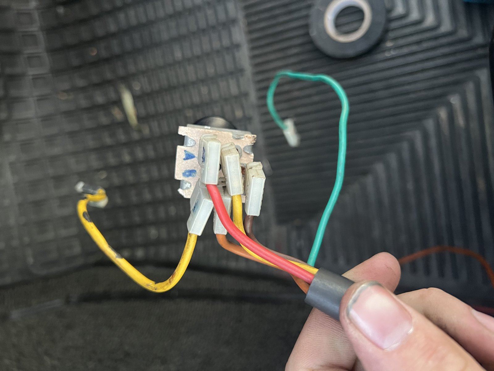

The portion in the console connects to this three speed fan switch (five terminals)
3)

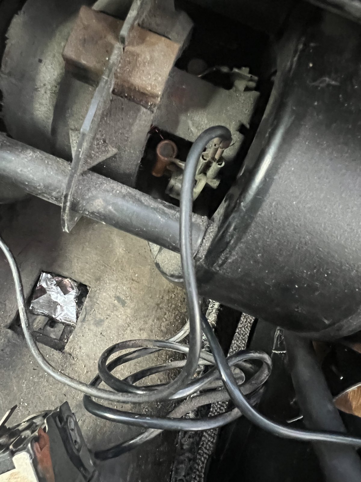

From the switch, a yellow and green wire run to where?? And the above orangey brown wire runs from the connector to some unknown point??
4)
The temp switch has two spots for wires
And the blower has one unused one as well, I’d assume they connect to those unused wire/

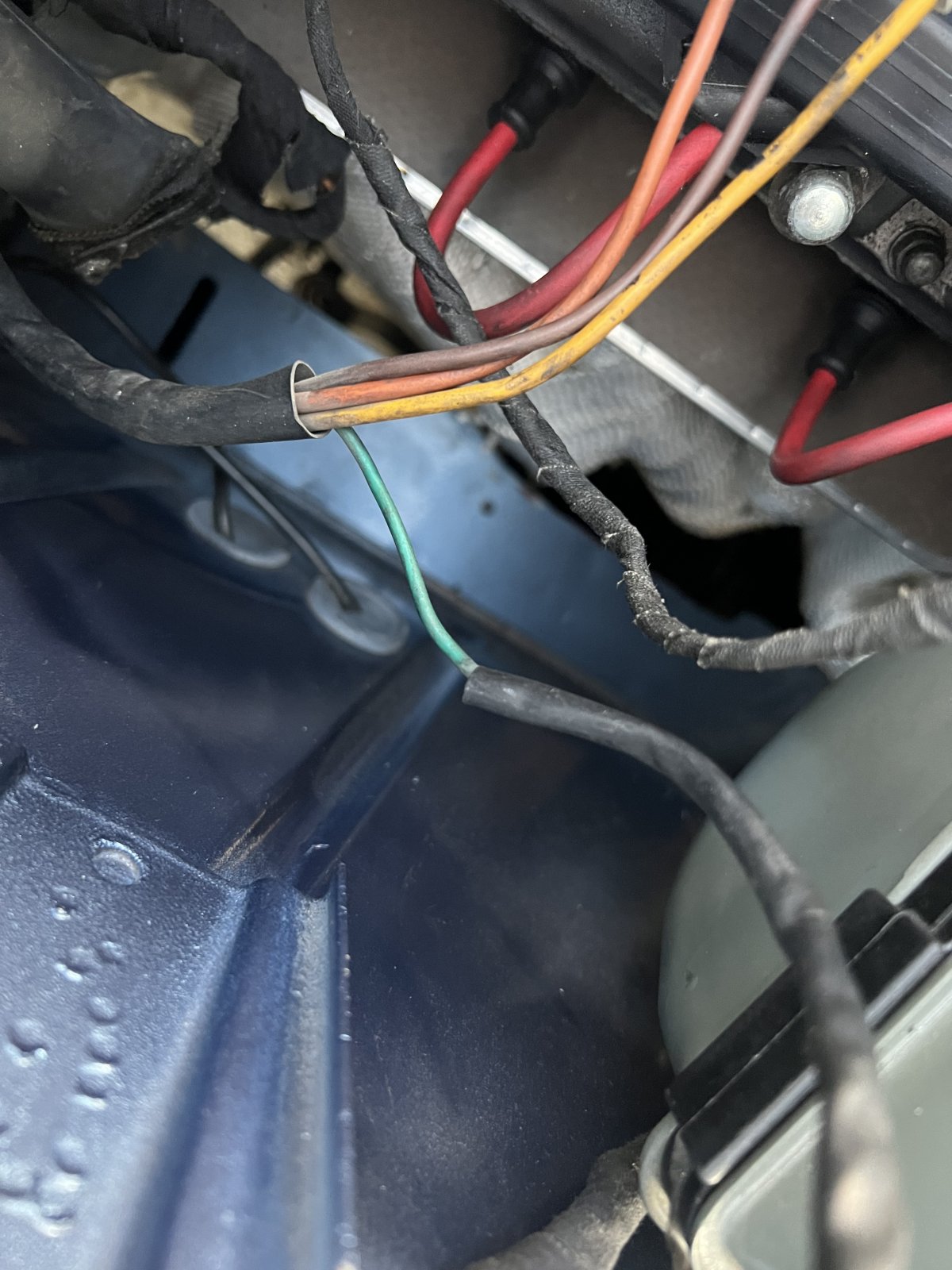

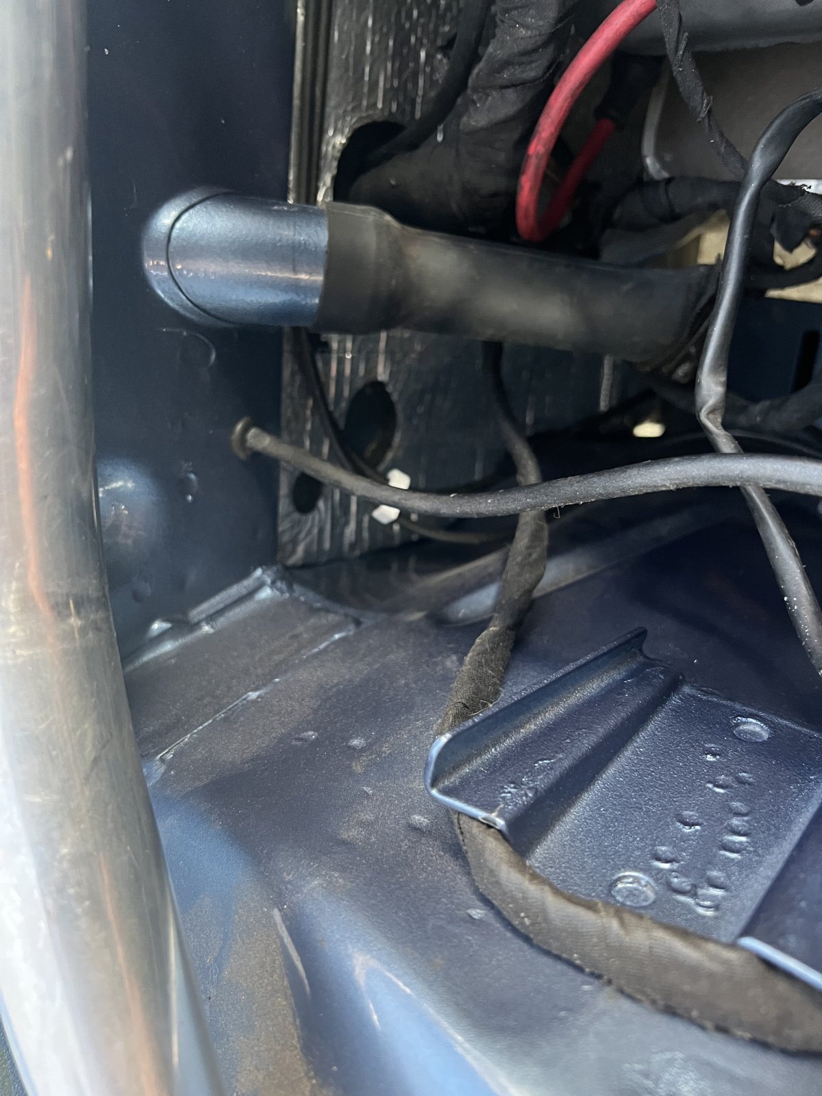

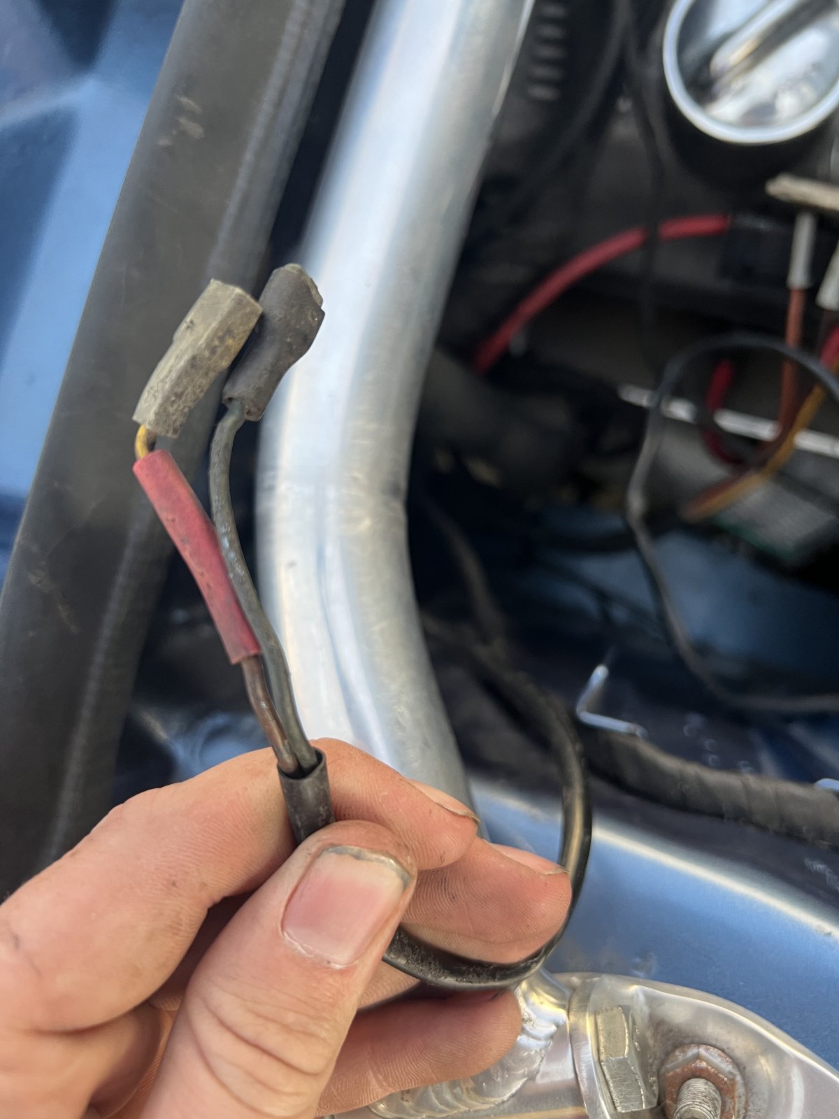

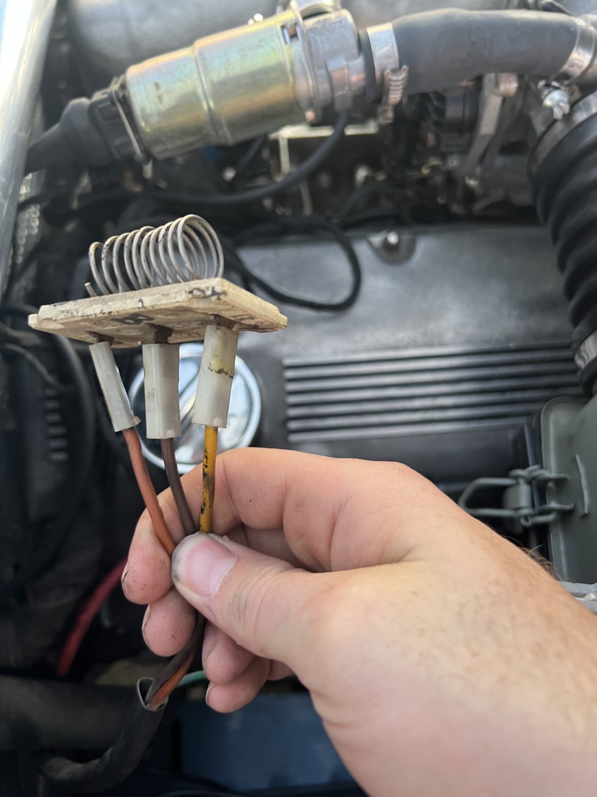

The other end of the harness runs into the engine bay
1)
2)
Green splits of before it reaches the above picture, it is the only wire long enough to reach the ac compressor so I think it is pretty obvious that is what it is for…

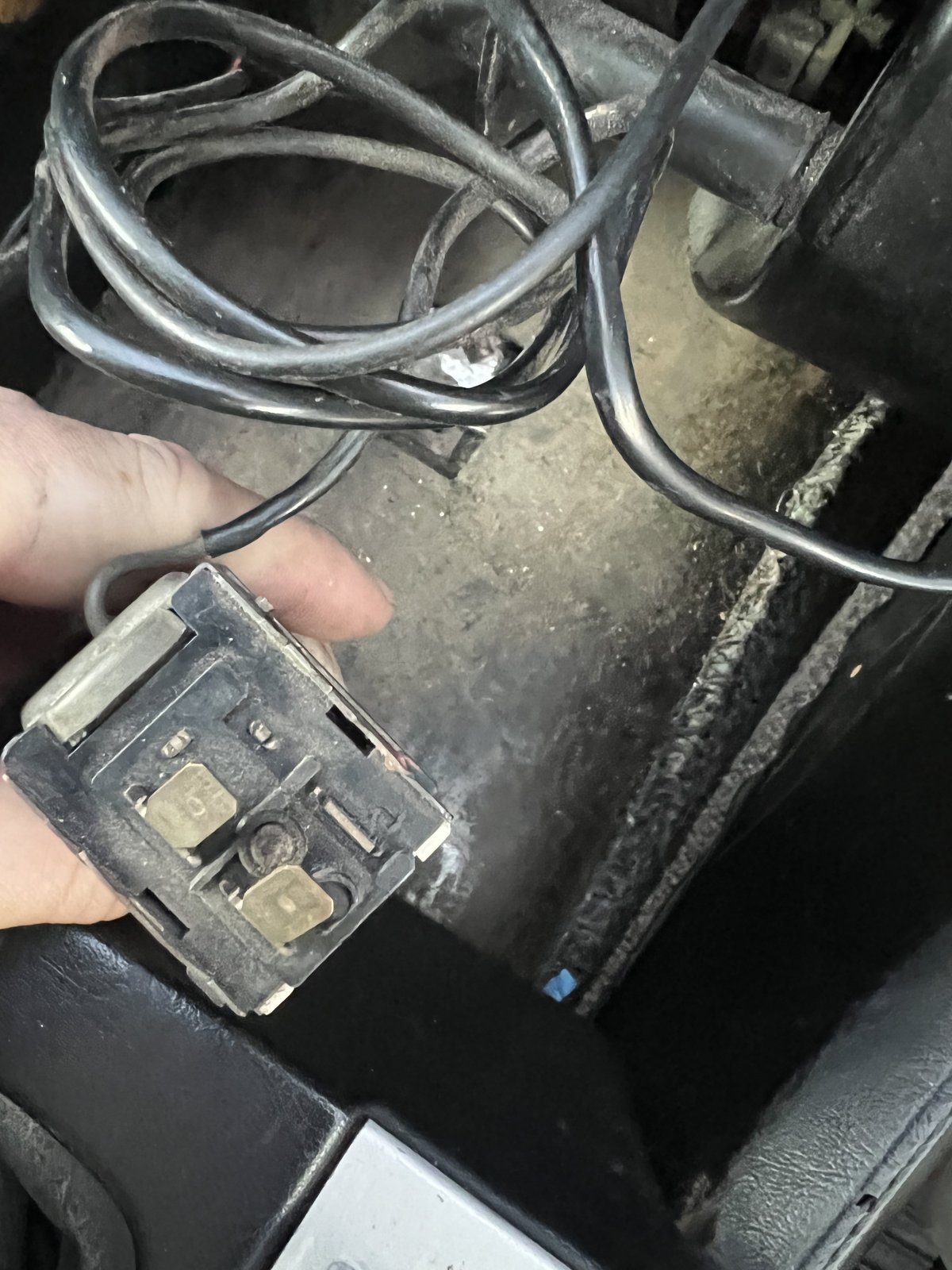

3) these two wire don’t have anything to do with the ac correct? They come from the heater blower area
According to previously posted ac wiring diagrams, there should be a relay/diode, and other things that are obviously not part of my harness, any thoughts guys?

Also if you look back in the pictures of the console wiring you will see a red wire with an inline fuse, that used to be connected to the purple radio power wire. Obviously I have removed that connection as I need the purple wire for my blaupunkt.
#3 most likely washer pump. Fan blower power goes to your temp switch the other terminal wire goes to relay under coil for condenser fan and compressor both wires black i think.
