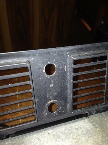

After two rounds of switches for the new AC, we are at a bit of a crossroads. I have two switches from CP, one looks to be a new aftermarket and one original. The problem is that neither of them "fit" on the back of the AC plate. Both are two wide to fit within the grooves created by the back of the vents which appear to be a little under 4mm wide at the base. If we invert the switch on the bottom it will fit but then runs into the radio. Clearly I'm missing something. Either I have the wrong face plate, the wrong switches or myself and my mechanic are missing something obvious.

Yes, my understanding is that the faceplate on the left is for an E3 and is incorrect. I used the picture of the two just for comparison's sake since I thought that would be the first question someone would ask. It also has a nasty large whole in the middle.
I don't think there were different faceplates over the years, were there?

The fan speed switch looks correct-it goes above the radio, the temp switch looks different, the back should look like this:

I think you are missing the bushing between the plate and the switch?

Just confirmed I have no bushings but the bigger issue is the ring nuts which apparently are different sizes. I'm hoping DQ has the answer for the missing fan speed nut. Has anyone tried using a c-clip or alternate fastener?
