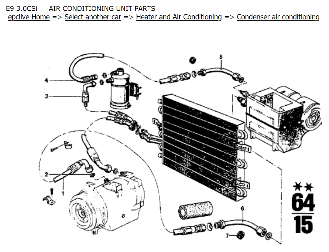

Dan Wood Well-Known Member Site Donor Messages 991 Reaction score 806 Location Newnan, Georgia Jul 8, 2021 #1 Was the vibration damper eliminated in the later 3.0CS* cars? Maybe 73 and later? If so, what change allowed for it? 1974 CSI pic.
HB Chris Moderator Site Donor $$ Messages 20,413 Reaction score 9,921 Location Huntington Beach, CA Jul 8, 2021 #2 The change from single piston York to axial/rotary style in 74.
Dan Wood Well-Known Member Site Donor Messages 991 Reaction score 806 Location Newnan, Georgia Jul 8, 2021 #3 HB Chris said: The change from single piston York to axial/rotary style in 74. Click to expand... Then it could be eliminated when changing to the Sanden SD 709? Is that what others are doing?
HB Chris Moderator Site Donor $$ Messages 20,413 Reaction score 9,921 Location Huntington Beach, CA Jul 8, 2021 #4 Yes, no longer needed.
