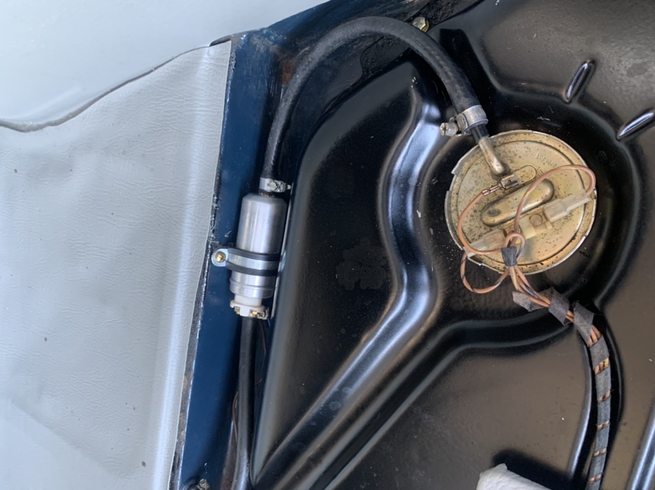

I am running a pierburg pump just like this one - http://www.piercemanifolds.com/product_p/99009.131.htm - along with a Bosch (VW I think) inline filter installed in the trunk. This is the same pump Chris has pictured in his NK.
My pump is attached to the subframe using the rubber isolation mounts, near where Stevehose has his (https://e9coupe.com/forum/threads/final-word-on-electric-fuel-pump-for-carbs.22574/post-165257).
I've also installed the revolution electronics relay, which pumps three seconds of fuel to fill the bowls when first powered up, and will kill the pump if it does not get a signal from the coil that the car is running. https://www.revolutionelectronics.com/Products/Fuel_Pump.html
