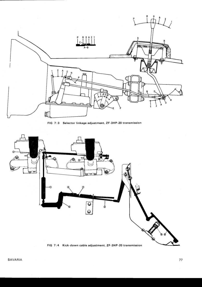

There maybe some info here
http://www.e9coupe.com/tech/autobooks/chapter7/autobooks_manual_077.htm
Great info there restart, thank you.
I was looking at those diagrams and I could not find the safety switch however. Is it a simple electric switch like the brake light switch? Can you give me an idea of where it is on these diagrams so I know what to look for when I'm under the car?

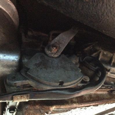

Left side behind bell housing.
Looks like this.
It looks like you may or may not have to remove that 13 mm linkage bolt to access the two other bolts for the switch at the back of the switch.
If you loosen the 2 bolts holding the switch from the back you can rotate the switch back or forth to the right spot
HTH

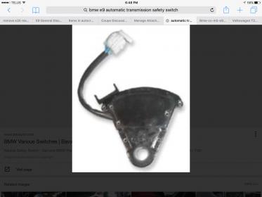

Generic auto safety switch
They sort of all look like this...ish

Trial and error.
Easier with a helper. You could put it In Reverse and move the switch till the back up lights come on. Or in park or neutral, there maybe a relay you can hear when aligned.
Basically, note where it is in refeence to the shifter, pivot the switch plate and check at shifter again. Repeat til all functions occur at the correct time.

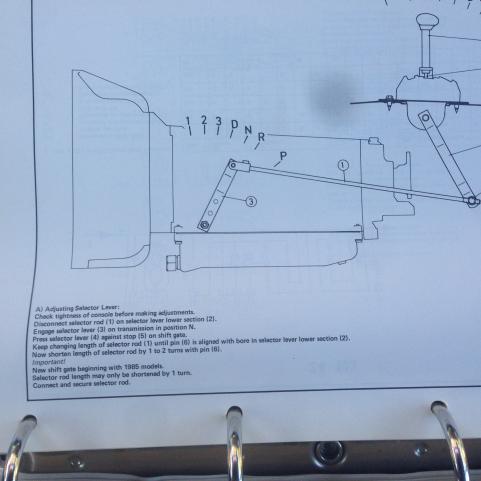

Came across this in my manual the other day
Not sure how clear the image will come through if you can't read it let me know I'll send you a pic
This is from an older e30 manual
