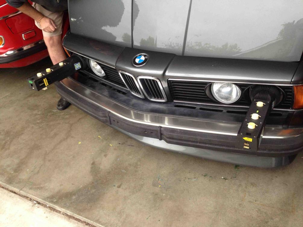

The coupe actually has them perfect but the E24 has the same Hellas and they are crooked.
My wife followed me once in the E24 and it was really annoying. Not annoying that my wife was following me you perverts, it was annoying how the lights were misaligned and reflecting in the mirror.
What is the method for getting them right?
So far no mechanic was willing to help me (including an Oakland guru that shall remain nameless). If nobody here helps me I will find where you all live and go drive behind you at night.
Terry has the equipment and is waiting to help you.

I went to the local inspection shop. They have a board to display the beam on with marks for where the beams should hit, both high and low. After taking off the headlight surrounds (very carefully - have you seen the prices?), there are screws where you can adjust the buckets up and down and left and right. It takes longer to take the surrounds off and on.
Its one of those things that, after adjusting, you say, "Holy crap, I should have done this years ago!"

Terry stopped by with the clever gadget. Did both cars, pretty cool.
Will test at dusk.
