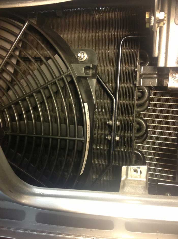

Flex-a-Lite option
Steve,
Here is what I have done on two installs. Although, for the most recent install the bracket is a bit different and mounted on the front of the fan (so the fan is closer to the condenser).
It is a 14" Flex-a-Lite 114 (Trimline reversible fan).

Sven,
Where did you get the bracket? Or did you make it?

Made them. 1/8" x 3/4" steel bar and short pieces of tube that just fit a 6 mm bolt - and some welding.
