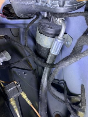

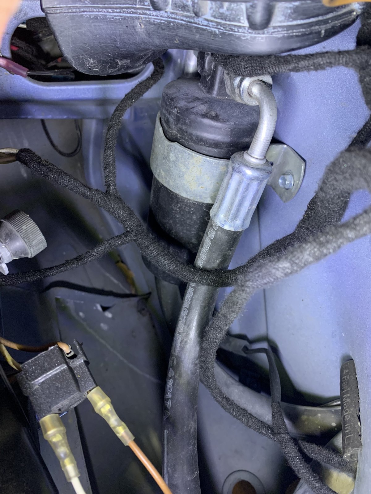

Here is mine right behind the headlight. This is before the wiring harness was redone btw

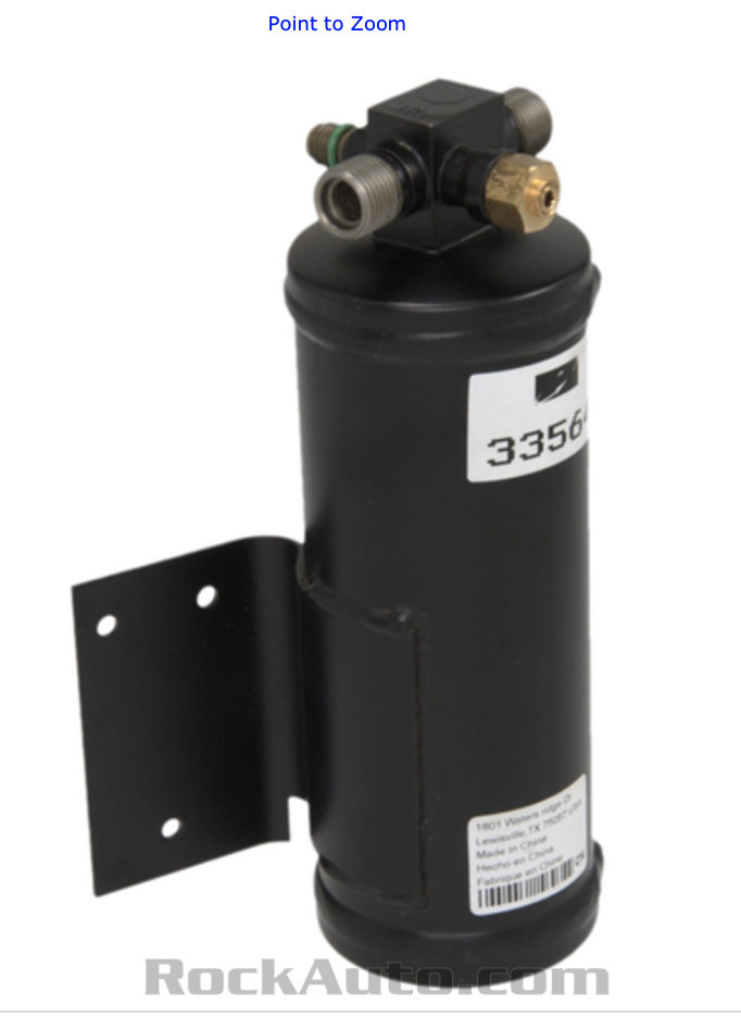

For what it's worth I used the Four Seasons 33564 receiver/dryer. Disregard if you don't plan to use #6 size o-ring fittings in that location. It's a good fit behind the right headlight.
It has a high pressure blow-off valve on it (nice) and a service port that you can keep capped. And a nice bracket that you can keep or cut off. $15 at RockAuto right now.
