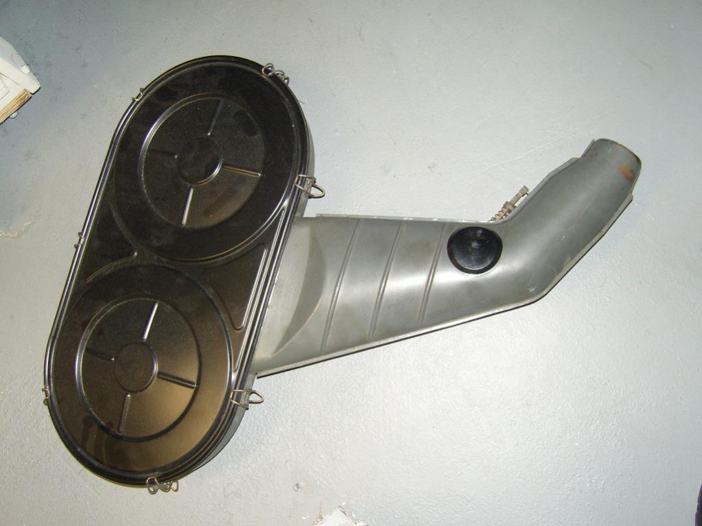

Powder coat, would it be wrong ?
Well, I had mine powder coated about a month ago, so my reply would be "NO!". The powder coater had many many colors to chose from - I matched it to one of his samples, using an unfaded spot inside the cleaner. Of course, I removed the clamps and that thermostat thingy before bringing it in.
The results look a lot better (see photo below). However, the color I chose lacks that touch of green that HB Chris mentioned. The correct color is sort of complex - tough to match.

Just finished repainting mine; will post pics tonight. Sent the original cover to PaintScratch.com for an exact match...

Sorry for the poor photo quality, and no before and after, but a vast improvement, and the color is spot on. Just waiting for the JAM Engineering adapter plates...
