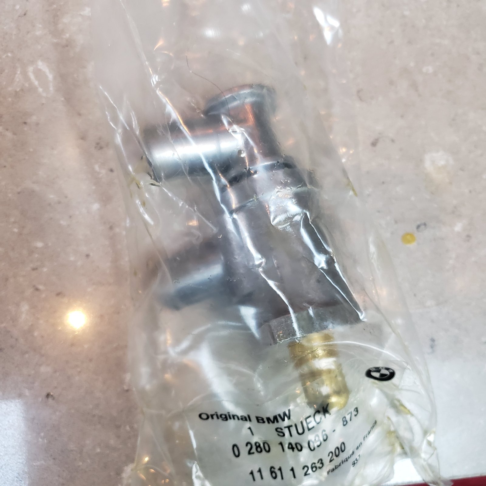

They are available but over 500 USD is common to see. I bought a NOS -263 200 (140 036) which operates and looks exactly the same... Still rare but another option

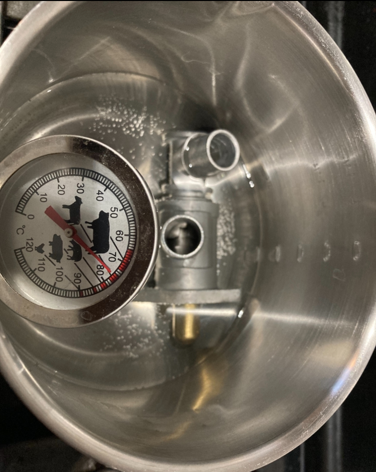

Put it in boilng water, you should see the valve close, like a normal coolant thermostat. Let me know. Thank you, Chris.
Hi Chris,
Did you have any chance to check the valve yet, thank you, Seán.

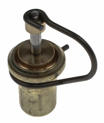

I found one, working. If you don't go the repair route, let me know.
Make sure you understand how to take apart without breaking.
you will need instructions if you haven’t done before.
and a torch.
and a torch.
Unfortunately, I do not have any instructions, I have looked. I was going to try to 'suck it and see' and 'hope for the best'.
Can you offer any suggestions. Than you, Seán.
