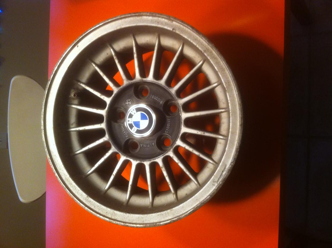

Hello all, I own a set of 4 Alpina wheels. These wheels were purchased many years ago with the intention of being mounted to my 72 Bavaria. Just wanted to get some feedback on what these are exactly, and are they worth refinishing and mounting.
Those look like the 'real deal' 14X7s that came on the CSLs back in the day. Very desirable and definitely worth refinishing. They 'd look incredible on your E3.
Thanks Vince, thought they had to be near first generation Alpinas since they have the BMW logo and a '73 stamp on backside. Any idea what color silver is used or is that a question for Alpina, or does it matter? I assume they are painted and not clear.
Thanks again, Bavdog
Opinions vary on the specific silver. Some use Polaris others Porsche Silver others something close from Wurth. I cant say that I can tell the difference.

I had my Alpinas painted Polaris (Satin) and they came out very nice.

I've used Chrysler LA2 "Silver Cloud" on my 14" Alpinas and years ago on Abarth wheels for a Fiat Spyder with good results. Available online from several sources.
Thanks all for the feedback. I live in Atlanta and have heard of a wheel repair shop called Wheel Wizard. I believe they clean, straighten and powdercoat. I assume powdercoat is the way to go if the two tone can be done properly. Any thoughts on a reasonable price for restoration?...I think Wheel Wizard just about has a monopoly here in Atlanta.

I wouldnt powder coat because they have to heat them and this causes some concern over the resulting integrity of the wheel. Also difficult to touch up. I'd have them media blast, straighten, and prime them, then DIY with the Wurth silver and clear to finish them. Then they can be touched up later when the tire shop dings them mounting tires, or other casualties of use.

i also am in atlanta ... wheel wizard does a very good job.
Only problem with 14X7 Alpina's is finding decent performance tires these days. The correct tire for this size is 225/60-14 and this size has disappeared unless you want a tire that is for a muscle car. I had a set of Alpina's in this size and I traded them since I couldn't find decent tires for them to go on my former E3. Tire Rack doesn't even carry a H rated tire in 195 or 205 /70-14. 14" performance tires are going the way of the dinosaur in the U.S. market. I was lucky that I found a set of old school 15" 5X120 BBS RA wheels on a local craigslist. The tire selection between 14" and 15" is night and day. If you have deep pockets, you can always check out the tires at Coker Tire.
