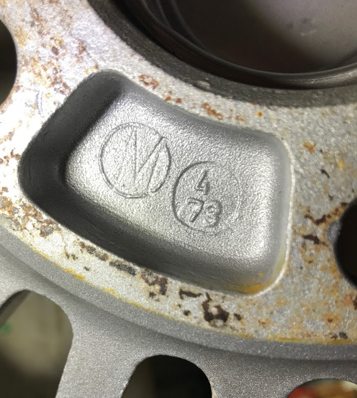

Having said that, I don’t think that the refurb is of the best quality, but the rims are correct. You might want to check via the seller what date stamp these rims have, more so to check if all 4 have the same date. Not that it particularly matters, would be nice if they were so.
The date stamp is on the back side. Almost invisible in the pics.

I think that someone sand blasted the wheels. Much of the detail on the text has literally been erased, and the media took some of the aluimum where the brake dust would have pitted the aluminum. You can see the pitting in the pics. The ad sais that they were painted but they almost look powerder coated to me. Powder coating is pretty thick and can also contribute to loss of detail on the text.
Yes, as Marcos said, sandblasting the rims isint the ideal way of removing the old paint and powdercoating will take away the fine prints. The shop I found for my rims, chemically remove the old paint, dirt etc. ‘Soft paint removal’ is what they call it!

Ask the seller to check the date stamp, whether they are all the same and hopefully for a lower price.
In a Perfect scenario, the date stamp should be prior to your cars production date.
