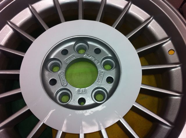

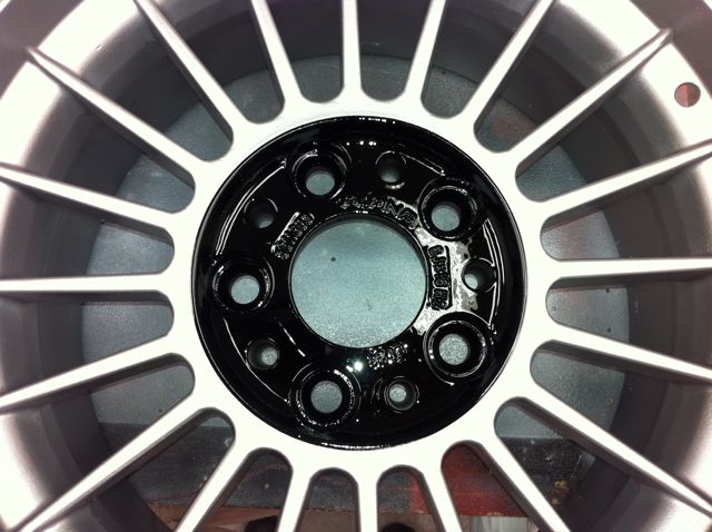

I had a local vinyl shop make up four masks using dimensions I provided with the 2mm overlap. The hardest part was putting the mask in place with the same overlap all the way around but with care that went OK. We taped off the rest of the wheel and sprayed the centers with gloss black. I asked the local paint supplier about using semi-gloss but he recommended against it, sighting difficulty with using the flatting agent and getting a consistent look. We used PPG acrylic enamel.
Here are a couple of images.
