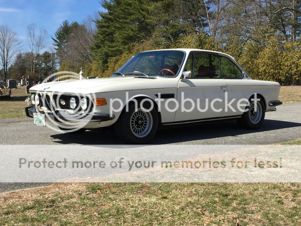

I have Yokohama size 205/55R16 on front and rear on 16" Alpina rims, however I have noticed some slight rubbing caused by the front inner guards (slight slicing into the rubber from stainless steel wheel flairs). I asked the tyre company what the issue is. They said I need to go to a body shop and get the underside of guards rolled inwards slightly so the tyres don't rub. This seems extreme to me. They also said if the tyre hits the silver flairs too hard it could rip them off the body. Anyone have such an issue before re rubbing tyres using 16" rims? Do I really need to get the front inner guards metal rolled inwards? I am thinking 16" might not be the best rims to run on an E9? (and if I use lower profile tyres it wont look nice). What do to?

If you are having issues have your fenders rolled by a competent body shop, no big deal if done correctly. If not it could rip your trim off or worse bend the lip back outward (amhik)
